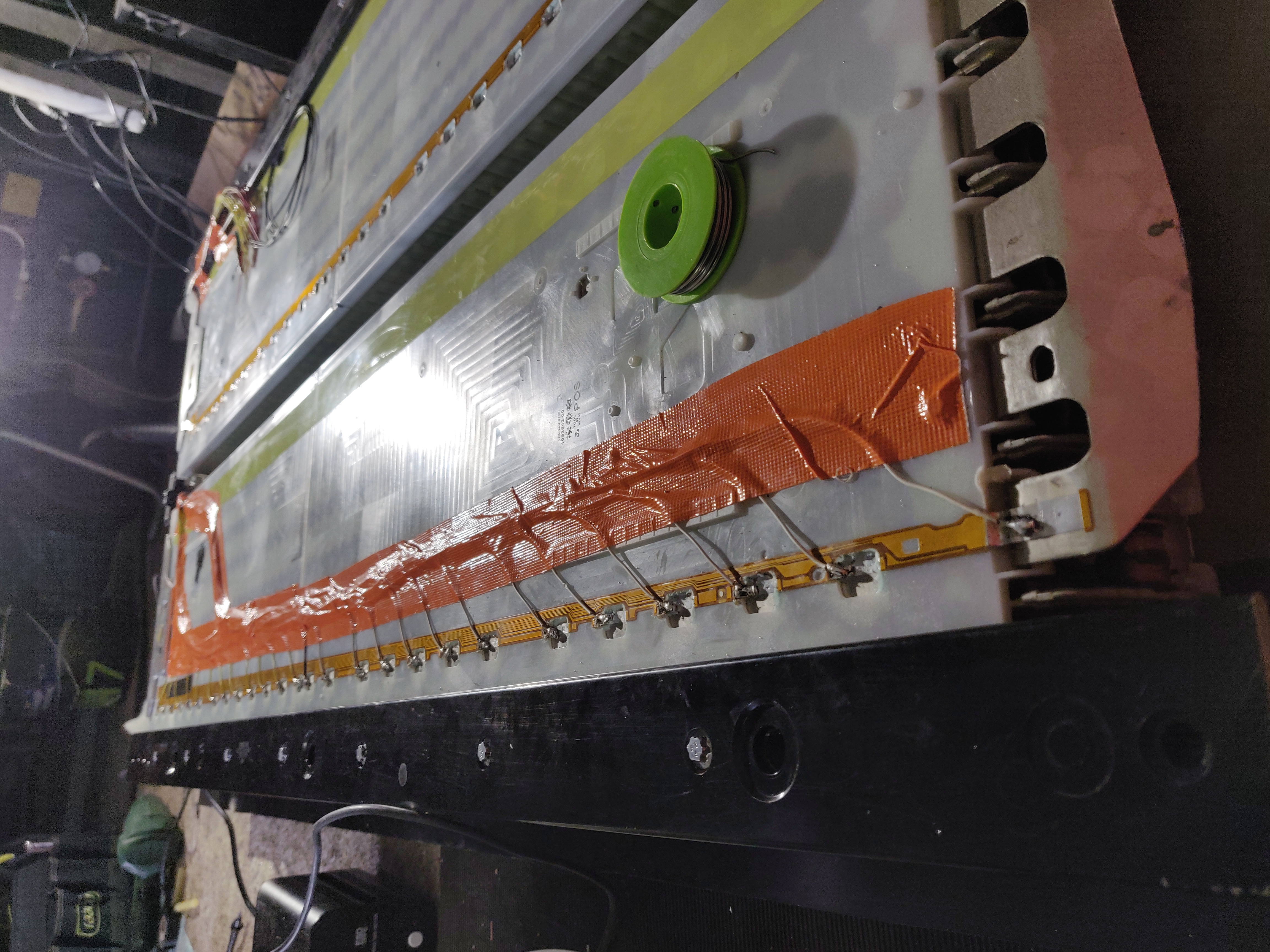

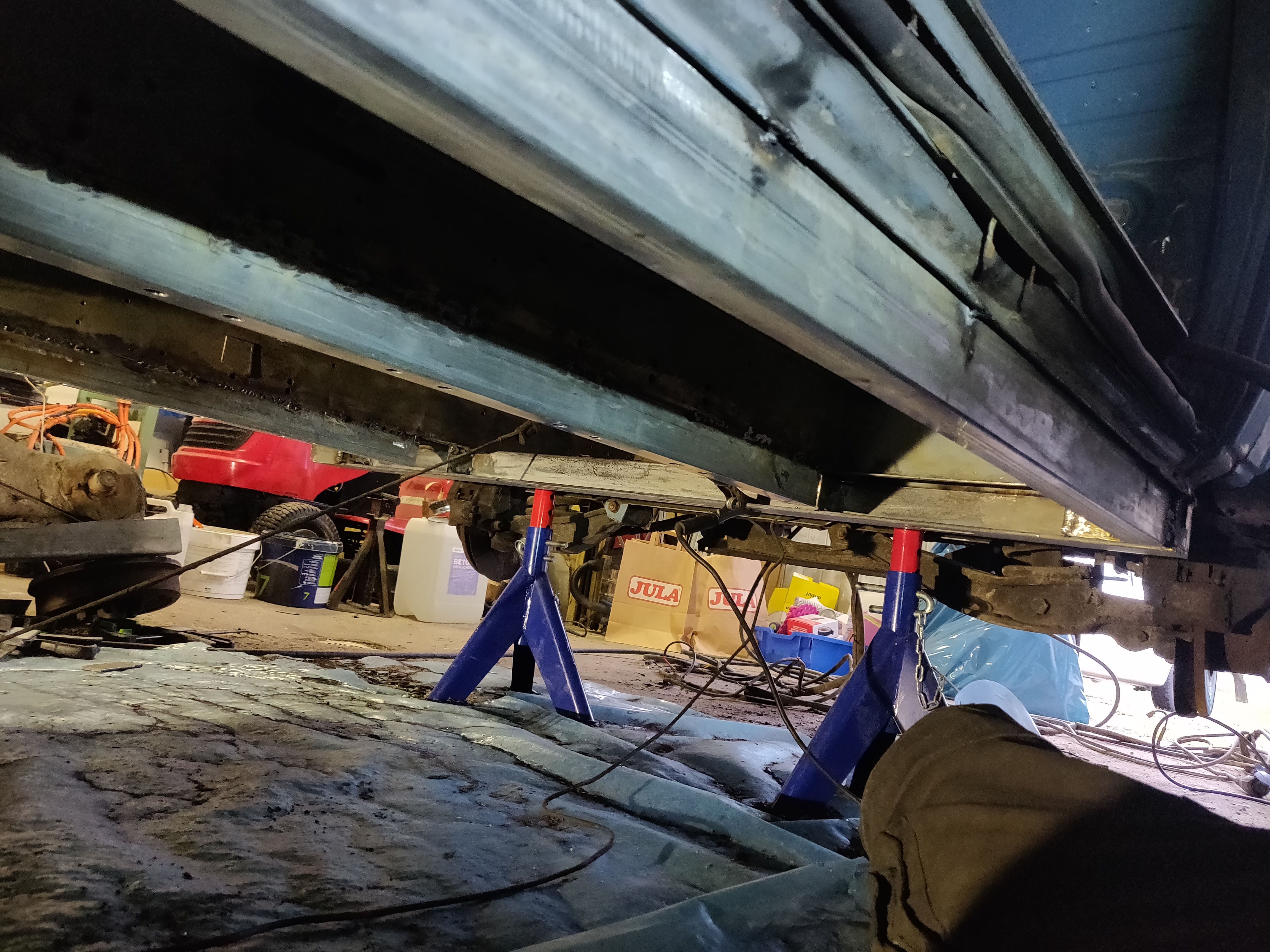

So it's been some time since my last update but I have tried to work on the bus every weekend.
I have welded extra steel beams under the bus so I can fasten the battery modules. I'm not a pro welder so it took some time to get it right but I'm pretty happy now. It's going to be tight though with only a couple of centimeters on each side of the module.
Next up I started on the batteries and reused the middle part of the model 3 for the big module. I've designed the other twos as well as the top plate so it's going to be completely watertight. I also soldered all BMS cables which was a pain xD.
I'm making tiny steps with only one day a week but at least it's going forward.
