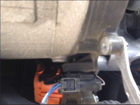

Re: SmartED using Prius Gen3 Inverter
+mitch+ wrote: Sat Oct 10, 2020 6:21 pm Ok, motor appears to have electrical connection at the aft end presumably for resolver.
Photos please...
+mitch+
Posts: 21
Joined: Fri Oct 09, 2020 4:47 pm
Post by +mitch+ »
2014 SmartEV - resolver wires
More dramamine, Ma!
Posts: 6754
Has thanked: 382 times
Been thanked: 1574 times
Yes that looks familiar, similar to ED2 motor. Can you find out the part number of that connector? I need to know for another project.
+mitch+
Posts: 21
Post by +mitch+ »
What is ED2 motor? Search yields nichts.
Should I use prius gen3 inverter or use existing inverter? The main reason I'm here since Damien's videos avoid this question.
You mean by simple inspection of the connector itself? But I'll need more dramamine.
More dramamine, Ma!

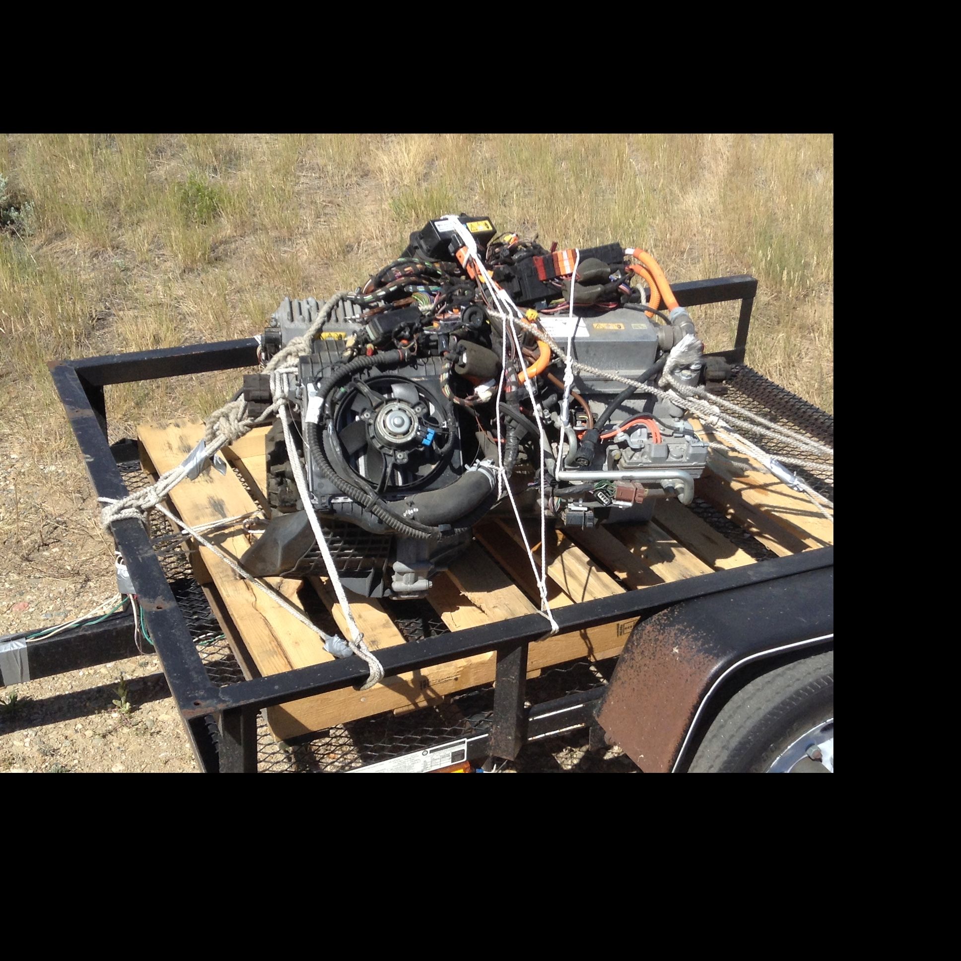

+mitch+
Posts: 21
Post by +mitch+ »
Image [/img]
Yes, that's the beast allright. In true Tesla fashion they are attaching the inverter directly to the aft end of the motor.
My prius gen3 inverter is due friday and yesterday I ordered an ED3 motor plus the EVBMW board so I'm committed to the latest technology.
So no one succeeded in getting the old motor to run? If they did the ballyhoo would be overflowing fer sure. [sadface]
Thanks much, now I know what is in this rat's nest:
More dramamine, Ma!
jalovick
Posts: 96
Joined: Mon Mar 11, 2019 10:14 am
Location: Sydney, Australia
Has thanked: 10 times
Been thanked: 7 times
Post by jalovick »
+mitch+ wrote: Tue Oct 13, 2020 1:12 pm
I'm not aware of anyone getting it running, but I haven't done much research.
It looks like you've got the lot with that haul. Is that the battery pack under there as well?

+mitch+
Posts: 21
Post by +mitch+ »
No battery pack and no dash unit, but all sorts of other oddness in the pile.
