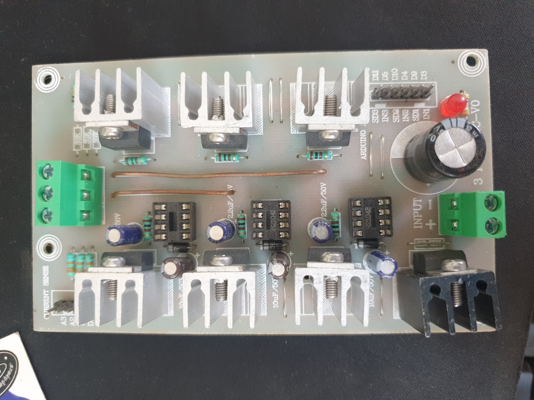

Ofc my ultimate aim is to power a electric motorcycle. For that I'm learning embedded systems, I have made a simple power stage, which i thought it would work but unfortunately it spins a motor for a second or so then it stops.. I'm guessing no feedback, but its a closed loop system.
I thought first i'd develop a small form factor with 48v and 5amps just for the sake of testing.
.. I made this with circuit diagram from electronoobs ESC https://www.electronoobs.com/eng_arduino_tut91.php

Ok. I would try to get the first power stage to work before building anything larger.
The board in the picture seem to be missing some components, gate drivers and also 3pc 33k resistors. Mabye the picture is taken before these where mounted?
The feedback is by measuring the Back EMF which uses the resistors I mentioned earlier.
What type of control board are you using? Arduino?
And what software are you using?

Yes, this is the extra board I have lying around so i took a quick pic with this.. Other board is same as this but fully populated, Microcontroller is Arduino as of now.
And for software, i use Arduino IDE.
I have recently bought a olimex stm32 h103 board, to first try to replicate this and add or remove more features later on as required.
