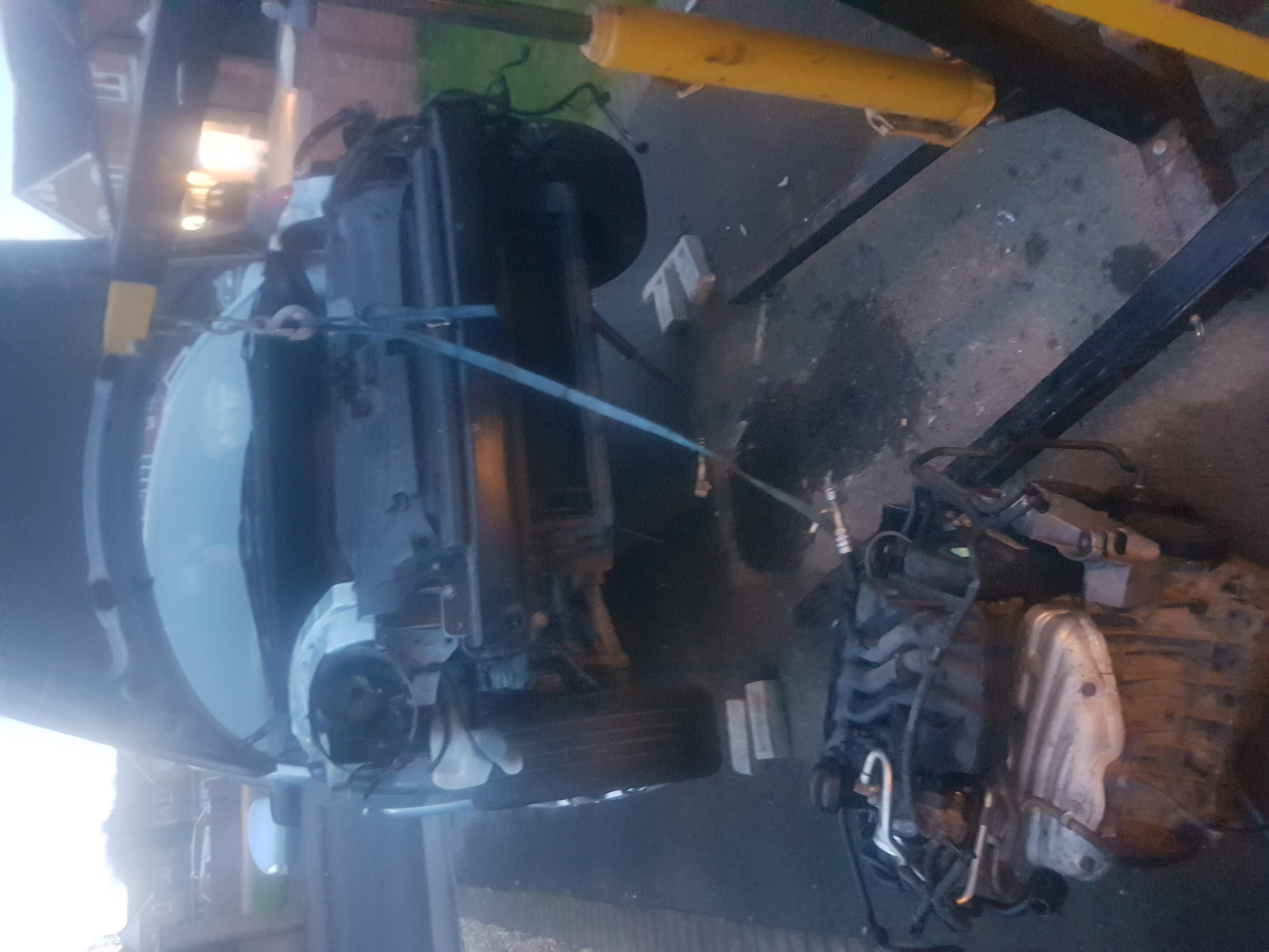

Engine deleted.
Gear box lowered first, then the engine lowered next. Lifted the car up and over the engine.
Ran out of light so will have to clean up in the engine bay and photograph the space. It looks like there's more than I thought though.

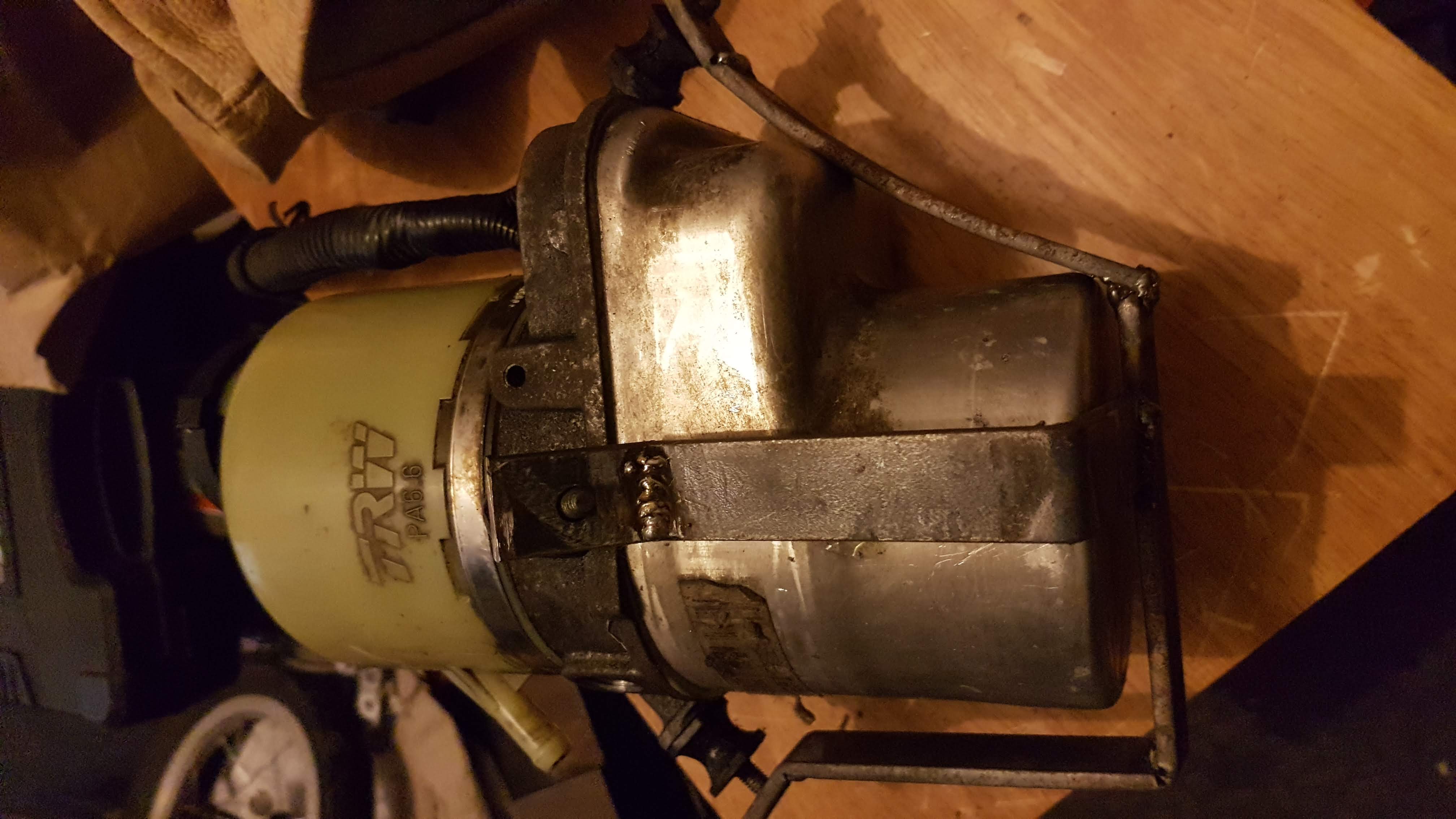

Quick mid-week job, bracket for the Zafira power steering pump. Welds are poor, even by my standards but at least seem solid. Not sure where it's going yet, but that's for the weekend. Hopefully my fluid will have arrived by then and I can tick off my first reassembly job.
It'll get the corners rounded off and a spray of paint at some point too.

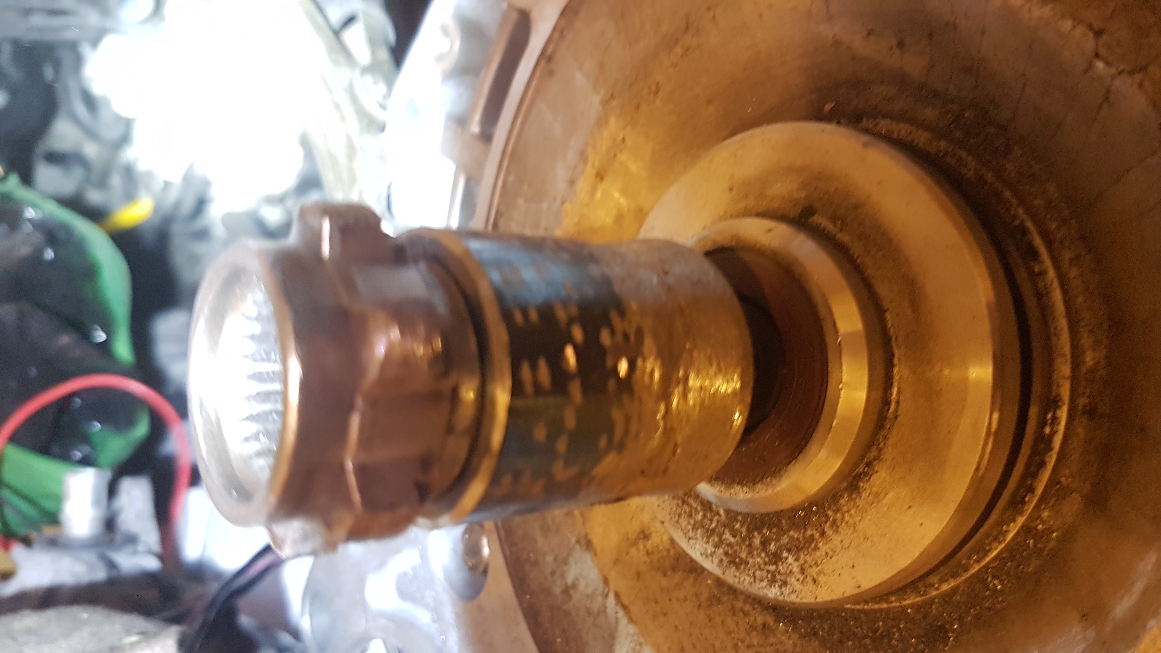

Well, that's the coupling made, no idea if it'll hold or vibrate the car to pieces, but it's what I've got.
The spacer arrived from eBay and was a great and snug fit. With a bit of a trim and a press together (only loose in photo) I couldn't get it perfect without any run out using the dial gauge and a hammer. First spline (badly) welded I used the spinning motor to round off. Then welded (badly) the other spline A bit more grinding and maybe welding to fill in a little and it might look OK.

I refined the method a little by putting a long bolt in to the motor face to help keep the grinder steady
Hopefully it'll be good enough but there's only one way to find out.
