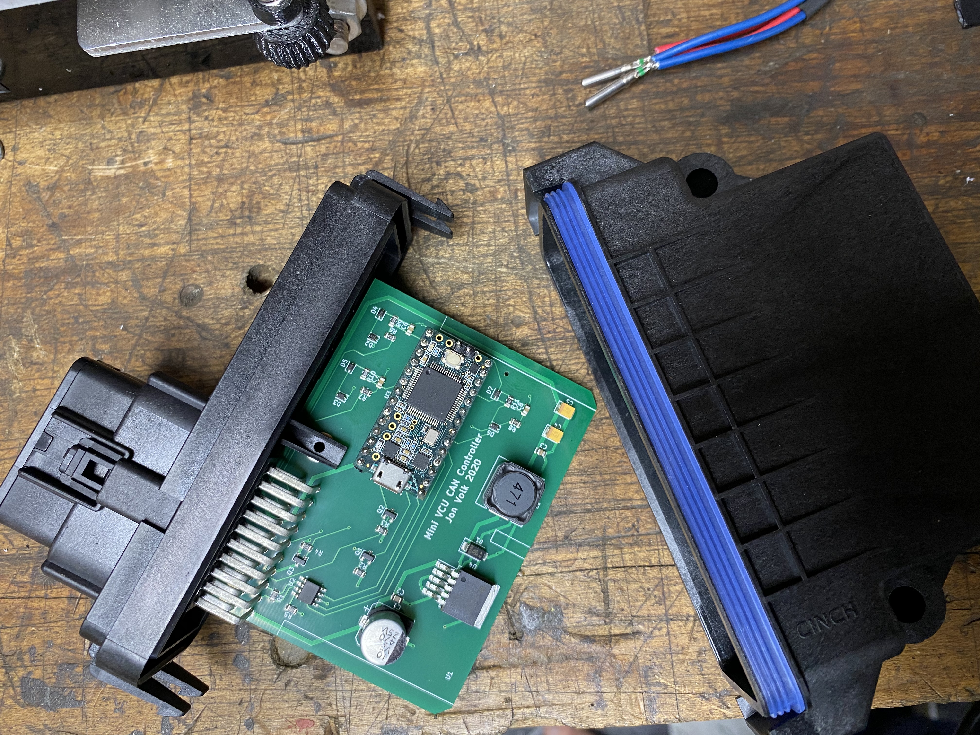

jon volk
Posts: 574
Location: Connecticut
Re: Any driveability quirks/complaints?
Post by jon volk »
If anyone wants to play with this stuff on your own without breadboards, I’ve got a couple of these available.
viewtopic.php?f=12&t=1129

jon volk
Posts: 574
Post by jon volk »
Jack Bauer wrote: Sat Oct 24, 2020 3:02 pmSign me up!
I’ll shoot ya an email next week. If you send me your json and any can settings messages you already have configured I can get some semblance of a working .ino for ya.
