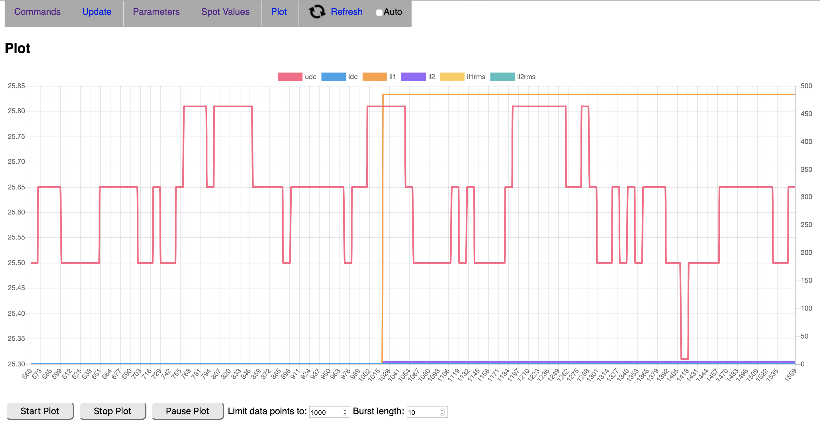

I've been trying to get this motor spinning, at the very least in open loop mode. But no luck so far.
I have the three phases from the MG2 stage of my Yaris inverter connected up to MG2 motor in the GS300 CVT. I'm not sure which way is the right way to connect them, but there are only 6 possible ways, so, I'm not too concerned about that for now.
I have a 30V/5A power supply providing my 'high' voltage DC input - just for this initial test. It looks like this is probably not enough to actually turn the motor based on seeing other people using something similar in other threads, but it's something to get started with.
I have a precharge resistor connected straight from the power supply. So, when I turn the power supply on, it starts precharging. I then have a kilovac contactor to bypass the resistor and allow the full current through. I manually activate this contactor by connecting it to a 12V car battery. The 12V battery also powers openinverter board and holds MG2_FORWARD pin high (not sure if I need this for manual spin).
First problem I see is that the heatsink temperature immediately shoots to around 84 degrees from cold. This triggers a 'DERATE - TMPHSMAX'. I'm presuming this can't be right and that I have the wrong setting for the temperature sensor type. I just set tmphsmax to 100 for now as the temperature is stable a 84. It's not climbing or anything. So, I can fix that later.
I set udcmin and udcsw to 15V as my supply is only 30V.
I set encmode to AB, fslipspnt to 10, and ampnom to 100. I hit start manual.
Volts are on the left, amps are on the right. il1 shoots to around 480 amps and then I get an OVERCURRENT.
From searching around this forum, I saw Damien suggesting that you could get overcurrent errors like this from some bad connections on your 50way connector. So, I took everything apart again. I opened up the PCB schematic from Github and then went pin by pin, testing the continuity from the copper pin on the inside of the 50-way connector and the next-nearest component. I found two bad solder joints. One was the pin going to R88 and the other was one going to TMP. I fixed both of these and put it all back together again. I tested briefly last night and I thought the overcurrent error was fixed, but now this morning I'm seeing it again. So, back to the drawing board.
So, I'll open it back up and check again.
One other thing to note is that with the DC input disconnected, I'm still seeing the overcurrent error.
I'll check the joints on the MG1/MG2 current sensor ports as well. The MG1 current sensor definitely points notch out, right?
Note : I have not done the DC/DC resistor swap on this inverter yet. Someone let me know if I need to do this to spin this motor. I'm presuming not for now.

Start by loading a set of good working Prius inverter parameters. The prius inverter needs certain things set to work like switching frequency, deadtime etc.

Thanks Damien, I assumed the defaults would be good enough for an open loop spin. I scoured the forum looking for params files and put a config together.
And the good news? I got it spinning!
I'm very excited to have this first big milestone complete. Without this it's very easy to think you just have a big inert lump of metal sitting beside you. Great to see it actually spin.

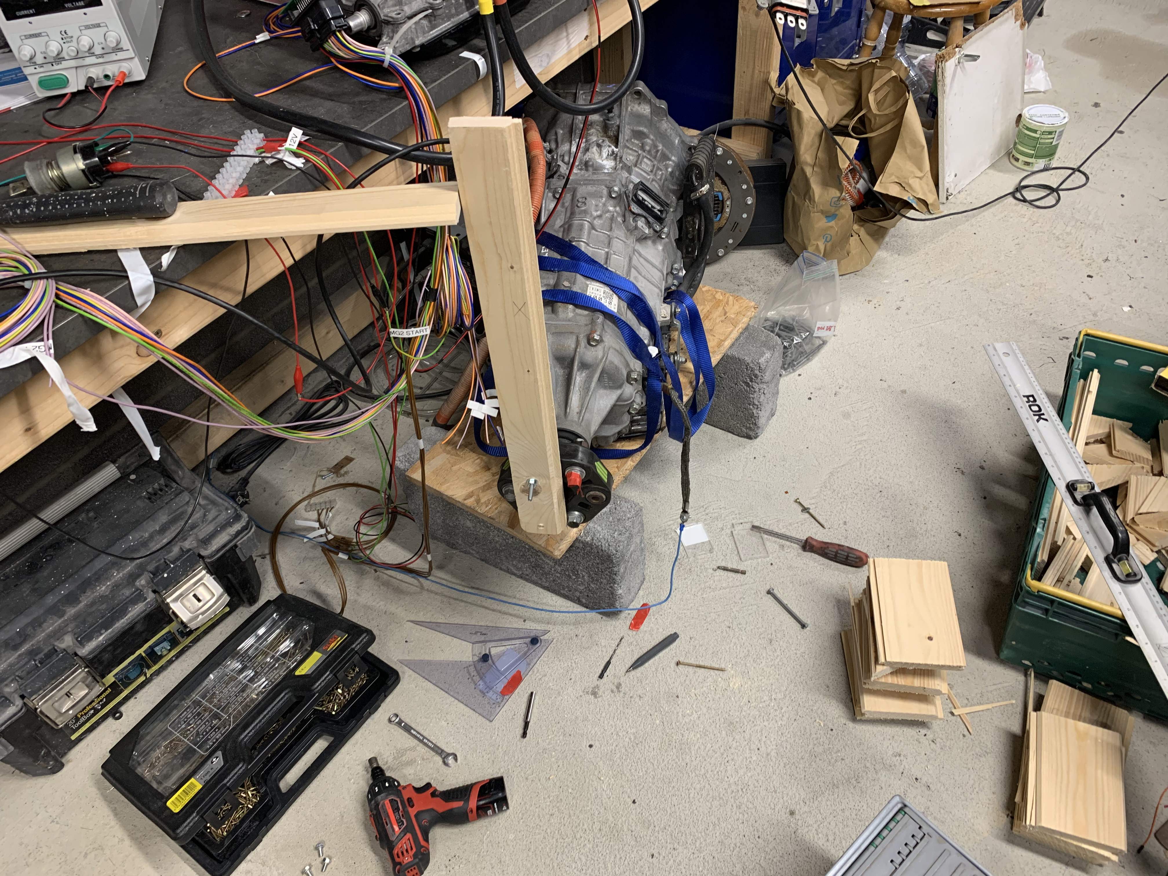

I managed to drain my car battery just by running the open inverter board. I guess it didn't have much charge to begin with. So, I ended up using a PC power supply to give me the 12V I needed there. I'm using a 30V/5A bench supply for high voltage input to the inverter. That worked just fine. It only used 1A or so to do the above spin.
So, next steps. I've got a few of the sumitomo connectors for the resolvers. I'm going to pin one up with some outdoor cat6 I have. Then I'll hook that up to the inverter.
I'll get my BMW battery pack up on the bench. I'll need to start building something resembling a contractor box. Maybe just a sheet of wood that I screw the contactors/fuses/etc down to. Then I'll link it in to the inverter.
The CVT needs to be gasket-ed and re-filled with ATF fluid. I had it open so I could probe its innards. Initially, I thought the coolant input/output lines were for water. I assumed this since they have rubber hoses. But looking at some of the Lexus docs, I'm now thinking that these are actually oil lines. So, I'll need to see about either blocking these up (if I can), or getting myself a little oil cooler radiator.
Then it's time to install the FOC firmware and start dealing it in.

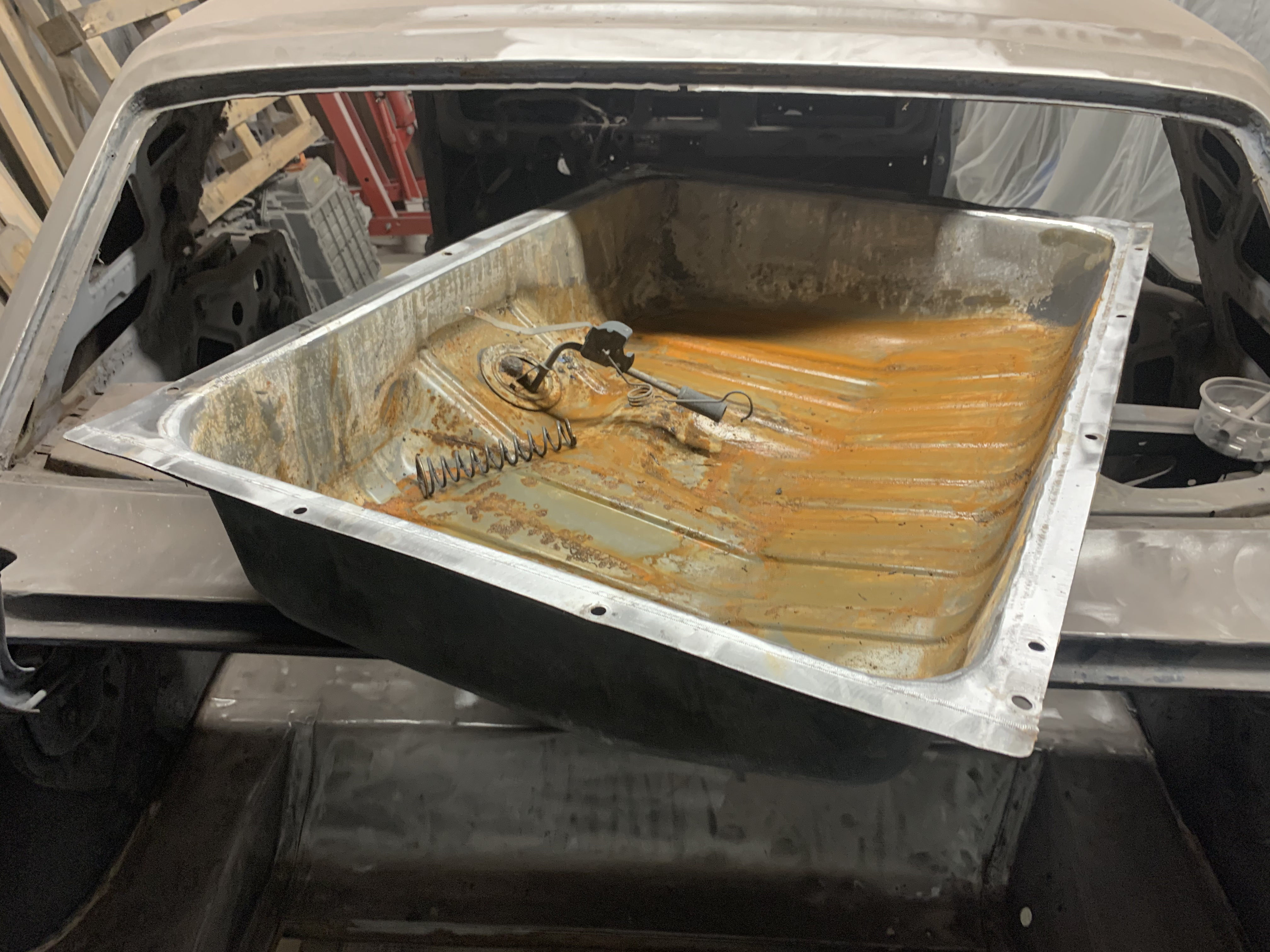

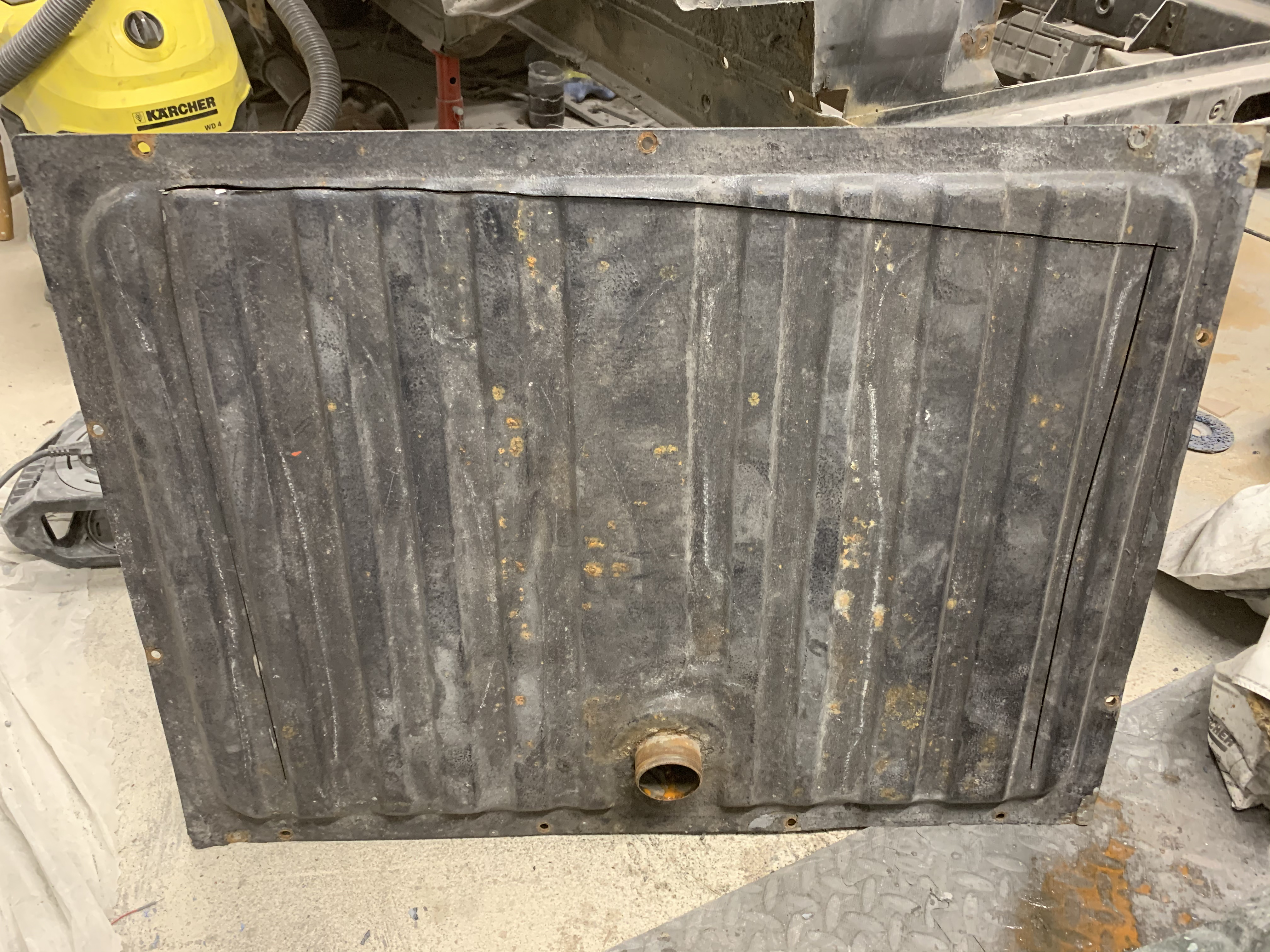

First I cut the top off the fuel tank. It had some pretty foul sludge in the bottom. It's also pretty banged up. If I'm going to use it I'll have to hammer some of that out.
So, first idea for the batteries - can I fit all 6 in the fuel tank?
Unfortunately no. The opening that the fuel tank sits down into it big enough for all 6 modules from the BMW pack I'm using, but the curves of the fuel tank make the usable space smaller. One alternative here would be to make a battery box that's more square-shaped that goes down into the space where the fuel tank would fit. Putting that idea to one side for now, but may come back to it.

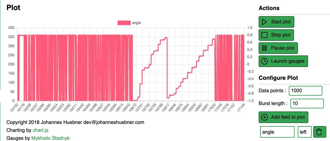

I have some outdoor cat5 which I'm using, at least initially, to connect to the resolvers on the L210 CVT. I've pinned them up with the right plugs for the resolvers. I then went through the procedure for figuring out the resolver wiring from Damien/Johannes FOC tuning video. I found the three pairs and measured their resistances. Two pairs had around the same resistance and one had a lower resistance - as expected. Connected up the exciter pair to ground and MG2 exciter (ampseal pin 20). Then systematically tried the 4 combinations of the remaining wires (polarity swapping them). I was seeing more or less what I expected, only I was getting *crazy* amounts of jitter.
I tried moving the resolver cables around to see if some external source of noise was causing the problem. I tried disconnecting everything and connecting it all again multiple times, thinking I made a mistake somewhere, but I was stuck with 50 to 100 degrees of jitter. The jitter was so regular, I figured I must be introducing noise somewhere accidentally - it was very uniform. After lots of fiddling around, I tried taking my ampseal plug out of the equation and, sure enough, my jitter went away. I was using the ampseal board from my yaris inverter. I had cut some traces and put in some bodge wires to turn it into a dual motor ampseal board. But I must have screwed up somewhere with those modifications.
Check out this sweet sub-one-degree jitter 8-)
I've ordered a few dual-motor ampseal boards from jlc, so that should fix that problem more permanently.

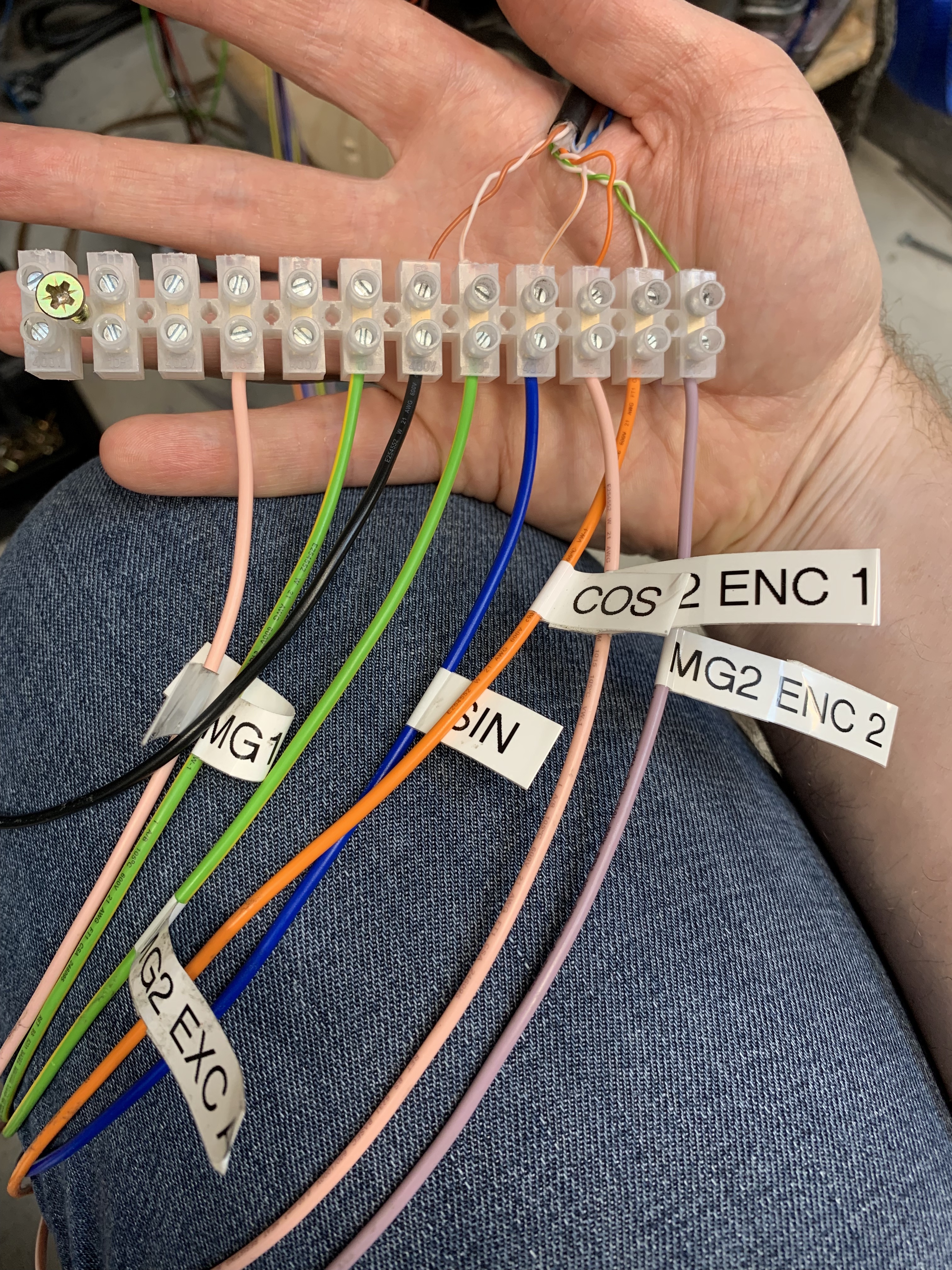

I was working on doing the FOC tuning. I think that I have the resolver wiring correct. I was getting a plot for angle that looks right to me at least.
I'm still not sure what the setting for polepairs and resolverpolepairs should be. So, if anyone knows what the settings are for the GS450 (I'm guessing this is a good place to start), or if anyone knows a good method to systematically work these out, please let me know. I know the ratio between the output shaft and the motors, so I guess I could try testing different values for resolvepolepairs and see which one lines up with the angle plot (adjusting for the ratio between output shaft and motor).

I'm a dummy and I misunderstood the difference between manualrun and a normal run. Main contactor doesn't close on manualrun. Before I figured that out I managed to damage my board by trying to replace some components. So, I'm on board #2 now.
Jitter looks good.
I'm pretty sure I have my resolver wiring set right. I need to turn the output shaft really, really slowly to be able see the angle go through the full 360, but it looks OK to me.
I don't know the right settings for polepairs and resolvepairs. But I've started out with 4 for polepairs. I'm basing this on the fact that the gs450 has 8 poles - from the OSTI document.
Here is me trying to get started FOC tuning. syncofs=0. I'm in manual run. I'm adding 1amp, 5amp, then 20amps of manualid. You can see that it doesn't spin up from a dead stop, but if I turn it with my hand it will start. It's quite jiggly at 1amp. My expectation from watching other peoples videos is that is should spin up and up when on the wrong syncofs. It's not doing this though. It's running at a fixed rpm.
I guess I have the polepairs/resolvepairs set wrong. Is there a way to systematically determine this (apart from opening the motor)? I tried going through all the permutations up to 8 polepairs/resolvepairs and I didn't find the right setting. But perhaps I missed it.

The motor is not spinning up from a dead stop. I can give it a little push and it will start to spin, but it stutters and makes some pretty unpleasant noises. One setting that I know that I don't know is the motor pole pairs and the resolver pole pairs. I've been guessing at 4 for the motor pole pairs based on the fact that this motors older brother the gs450h has 4 motor pole pairs. But this could be wrong.
I took the CVT apart, so I know that the ratio between the MG2 motor and the output shaft is 3.3333. So, working backwards, the output shaft should move 108 degrees (360 / 3.3333) for every one rotation of MG2.
I bolted a bit of wood to the output flange to act as a 'clock hand'. I then blocked the hand so that it could only move approximately 108 degrees. Not very accurate, but close enough. I then watched a plot of rotor angle as I slowly swept the arm through one motor revolution. I recorded how many revolutions the firmware thought the motor did with that combination of motor/resolver pole pairs. I repeated the procedure with different combinations of polepairs and resolverpolepairs.
As you can see, I didn't try every combination, but enough to see a trend. At best, I was getting two turns for every sweep. I am expecting to see only one. Here's what a plot would typically look like for any of the 1:1 polepair/resolverpair settings (e.g. 4 pole pairs and 4 resolver pairs, or 2 polepairs and 2 resolver pairs).
Based on my table I would expect having double the resolver pairs of the motor pairs would get me closer to the right configuration, but the OpenInverter firmware doesn't seem to like that. It just always gives me zero degrees when I try to set resolver pole pairs > motor pole pairs.
So, I thought, OK, time to backtrack. Maybe I don't have the correct resolver wiring. There are only four possible permutations of the four sin, cos, enc 1, and enc 2 cables. And that's when things got weird. The three wrong wiring combinations should give me an angle that jumps around. But that's not what I saw. I need to go back and verify this, but it looked like every resolver wiring combination was giving me the same two motor turns per 108 degree sweep. Which doesn't make any sense.

Still trying to figure out what the right polepairs/resolverpairs settings are for this motor. I went back to check each of the four possible resolver wiring combinations to verify the weird behaviour I was seeing last time.
What I’m expecting to see is only one of the resolver wiring combinations to give me sensible angle readings. I.e., as I turn the motor the angle should increase steadily to 360, then immediately drop to zero, then resume climbing. The other three ‘wrong’ resolver wiring combinations should give me erratic angle readings. However, all four wiring combinations seem to be giving consistent output. For some of them the graph is reversed (the angle falls instead of rises), but the angle moves consistently from 0 to 360 or vice versa.
So, I can’t tell what resolver wiring is the correct one or if I’m doing something else wrong.
I'm also still seeing two rotations when I expect to see one. I'm turning the output shaft 108 degress, with a gear ratio of 3.333 that should be one turn of the MG2 motor.
LeonB
Posts: 56
Joined: Fri Mar 26, 2021 12:19 am
Location: Germany
Re: 1965 Ford Mustang
Post by LeonB »
I have done the same procedure with a Prius Gen 3 motor/inverter a while ago. Although I don‘t know if my approach makes sense or I just got lucky, I got the motor to spin and wanted to share my experience:
I also did not get 1 rotation in the angle plot for each „real“ motor rotation. Multipole resolvers have multiple electric rotations for a single motor rotation. I think each pole pair results in one rotation, so your observations match the expectations for a 2 pole pair resolver
In the FOC tuning video, the angle plot moves from 360° downwards to 0° and then jumps back to 360°, so I would just choose one of the two wiring combinations that results in this behavior and proceed with the syncofs tuning. I don‘t know which difference there may be between the two combinations, but in my case the first one I tried gave me the results I wanted: A motor which reacts accordingly to the throttle input.

LeonB wrote: Wed Aug 18, 2021 12:38 am I have done the same procedure with a Prius Gen 3 motor/inverter a while ago. Although I don‘t know if my approach makes sense or I just got lucky, I got the motor to spin and wanted to share my experience:
Hi LeonB, thanks for the input, very much appreciate it.
Right, I see, the angle in the plot is the notional resolver angle, not the actual physical angle of the rotor. Makes sense.
I think I'm just going to have to go through each combination of polepairs, respolepairs, and resolver wirings. It's only 544 combinations :P
I've gone through each polepair/respolepair combination for one resolver wiring already - one of the descending angle ones. I have not found a smooth spinning combination yet, but I did notice that when polepairs was twice respolepairs I could get the motor to spin - very clunkily, but it would spin a bit. So there might be a hint in that.
I'll try some further combinations tomorrow. But I think I need to get the a smooth spin before I can start changing syncofs.
kiwifiat
Posts: 101
Location: Vancouver, Canada
Been thanked: 12 times
Post by kiwifiat »
chrskly wrote: Thu Aug 19, 2021 9:53 pm
polepairs is 4, respolepairs is 2. You should get four 0-360 degree periods for each mechanical turn of the motor. Johu posted a video on how the STM32 measures the rotor angle, it is worth a watch. Also if you own an oscilloscope or can borrow one it is a good idea to scope the driver signal and the feedback sin/cos signals to ensure the inverter is getting clean signals.
Thanks kiwifiat. I've tried 4+2 for each of the four possible resolver wiring combinations. But still no joy.
None of them will start the motor from a stop. For the two combinations where the angle goes down, if I give the output shaft a bit of a push it will spin. But it seems noisy and shaky, see video. Also it spins at a constant rpm. In the Johannes/Damien FOC tuning video it looks like it should spin up faster and faster.
For the two resolver combinations where the angle goes up, the motor won't spin at all.
I've tried a few syncofs values as well just in case the proper syncofs was near zero.
Open to any and all suggestions.
