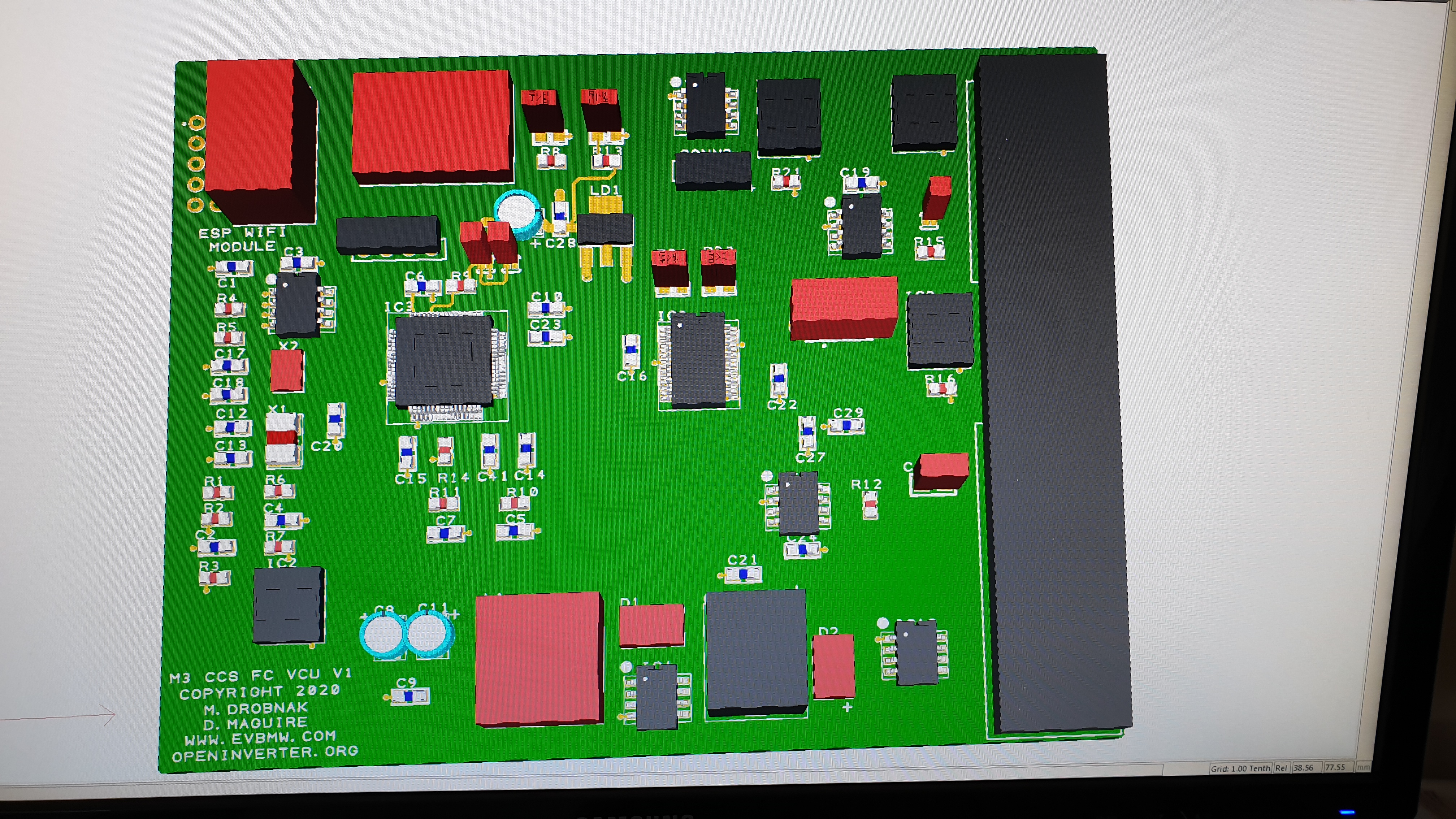

Got the components where I want them. Now its just tracking. I'm going to wire up my EU CCS charge port over the weekend and grab some can.
- Posts: 4006
- Been thanked: 1135 times
Re: Tesla Model 3 Charge Port Controller Standalone Development
Ok folks here it is. Included a 10 pin tag connect full jtag. Please review then we can get some ordered from JLC.

Overall looks good. I'm just going to jot down some thoughts under here. I may ask some stupid questions. Please be patient.
We're substituting the STLink USB passthrough for a dedicated USB, yes? What are the LEDs for on the USB connection? Mini USB is good.
CAN connections look good. I need to try PA11/12 again. I tried that before I had the timing right on the F4 board and got nowhere.
Power supply is interesting - I don't think I've ever seen 0.1uF next to a 470 uF cap. What's the purpose of that?
What's the EEPROM actually connected to? SCL and SDA are connected to the CPU with a 4.7kOhm pull-up to 3.3V?
Latch output works fine with high side drive straight off the CPU on the Nucleo board (so 3.3V), I was driving it with the SimpBMS' 5V output, so your 5V output should work great there.
Proximity voltage is 12V I think, so good call on the digital inputs being 12V capable.
Fault line worked fine on a standard digital input on my F7 board. So, to ADC or to GPIO?
I'm also not sure of the RC value on the input. They have the schematics here - https://www.st.com/resource/en/schemati ... ns_sch.zip - Board is MB1137 / Nucleo-F767ZI - I'm using PG2 for the fault input and PG3 for the latch output.
8MHz and 32,768Hz crystals look great.
The layout I can't say much as I've done single layer PCBs but never more than that. Silkscreen layer looks good.
So I don't think there are any changes, subject to your thoughts based on my feedback. (If read it right, the ADC input can also be used in digital mode as well - but may not work as well with the resistor...hence I am deferring to you on this.)

Looks good.
You can get nasty spikes on the proximity line. Is it worth putting a clamping diodes on the 12V inputs, or is that not necessary?

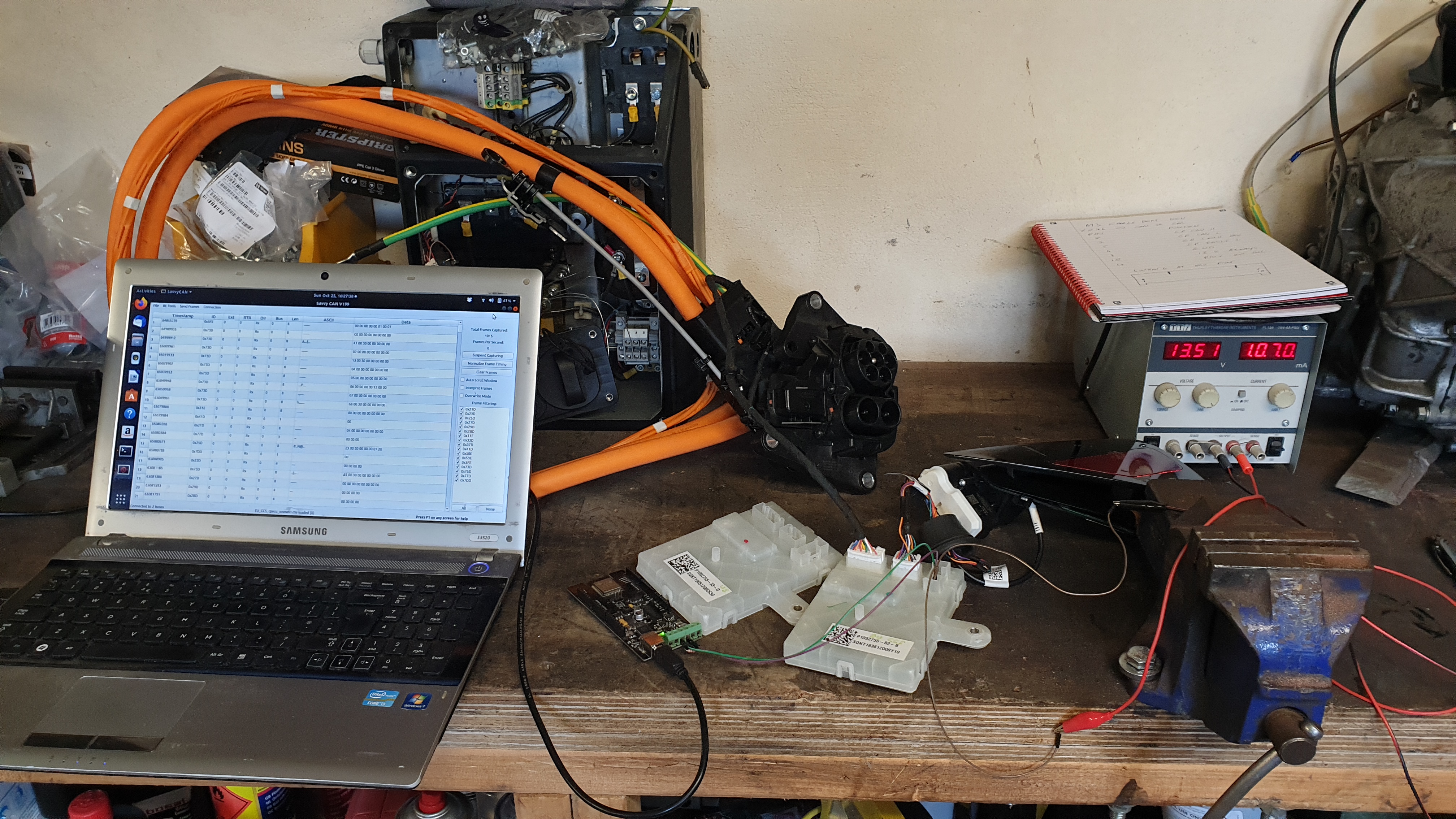

I did some measurements last night (relative to chassis ground):
* Pin 4 - Proximity Out from CP ECU goes to Rear drive inverter (Drive Inhibit I assume)
* Pin 5 - Latch Enable Input to CP ECU from "HV Battery"
* Pin 6 - Fault Line Output from CP ECU to "HV Battery"
1. Doors closed, trunk open, charge port door idle
- Pin 4 - 2.29V
- Pin 5 - 4.06V
- Pin 6 - 4.24V
2. Doors closed, trunk open, charge port door open
- Pin 4 - 2.29V
- Pin 5 - 4.06V
- Pin 6 - 4.24V
3. Doors closed, trunk open, charging
- Pin 4 - mV range
- Pin 5 - mv Range
- Pin 6 - 4.24V
4. Doors closed, trunk open, charging *interrupted*
- Button press restores values to idle / open.
- Within a few seconds charging resumes
- Values return to charging numbers after the relay has turned on.
Looks like the proximity In on the inverter is a pull-down, as unloaded that puts out 11.X volts on the bench for me.
Confirmed that the checksum calculation is correct for 2 of the three IDs using it. The third one I think I messed up the 0/1 modulus values, so I swapped them and will re-test that later.

* Checksum is good.
* Latch untested but updated.
* Comments updated, more commented code is live on github.
* Didn't do much of that.
* Didn't do any of that.
I _did_ find some RTC examples by accident for the STM32F1 and F3. Between both of them, and examples for the DS232X above, I got something to compile...and then crash.
Running it trough gdb and stepping through (after disabling the 1k/sec timer interrupt LOL!) shows that get_time returns all zeros, which it is not supposed to. So something is probably looking at the wrong bits somewhere. The heavy lifting is done, just need to read over the docs and massage everything to work together.
Also tried out "cargo clippy" against the code - which for those who remember from Microsoft Office, "I think you're trying to do this"...it offers extremely opinionated critiques of your code. So while it didn't generate warnings, my code is far from 'standard.'

Sorry I've been slacking off on this project:)mdrobnak wrote: ↑Tue Oct 20, 2020 5:41 am Overall looks good. I'm just going to jot down some thoughts under here. I may ask some stupid questions. Please be patient.
Fault line worked fine on a standard digital input on my F7 board. So, to ADC or to GPIO?I'm also not sure of the RC value on the input. They have the schematics here - https://www.st.com/resource/en/schemati ... ns_sch.zip - Board is MB1137 / Nucleo-F767ZI - I'm using PG2 for the fault input and PG3 for the latch output.
Bed time now.
-Matt
1)The 0.1uf beside the big electrolytic is standard power supply design. Big caps are very poor at eliminating hf noise so you drop in a small ceramic beside them to help out.
2)So do we need to change the i/o pins for fault and latch or are we ok there?
3)I can add an external RTC chip if required.
So subject to those issues I can generate the placement and bom and fire them off to JLCPCB and get some boards. I'm also going to rig up my port on the bench and get some can captures from both the US and EU CCS ecus.

SDA and SCL are on PB7 and PB6. I got those pins from using CubeMX as the I2c pins. Is that ok?
Finally got the setup on the bench and shot some log files.

I couldn't help but peek.
Somebody's being funny
A few observations:
0x5FE is different on the EU unit.
You're missing your ground, and thus your data in 0x21D is wrong. Put that chassis ground wire on the same ground as your power supply for now.
0x33D, 0x77D, 0x7DD are new.
Bonus:
0x432 0 to 0x30 counted in 2s will keep it alive.
-Matt
