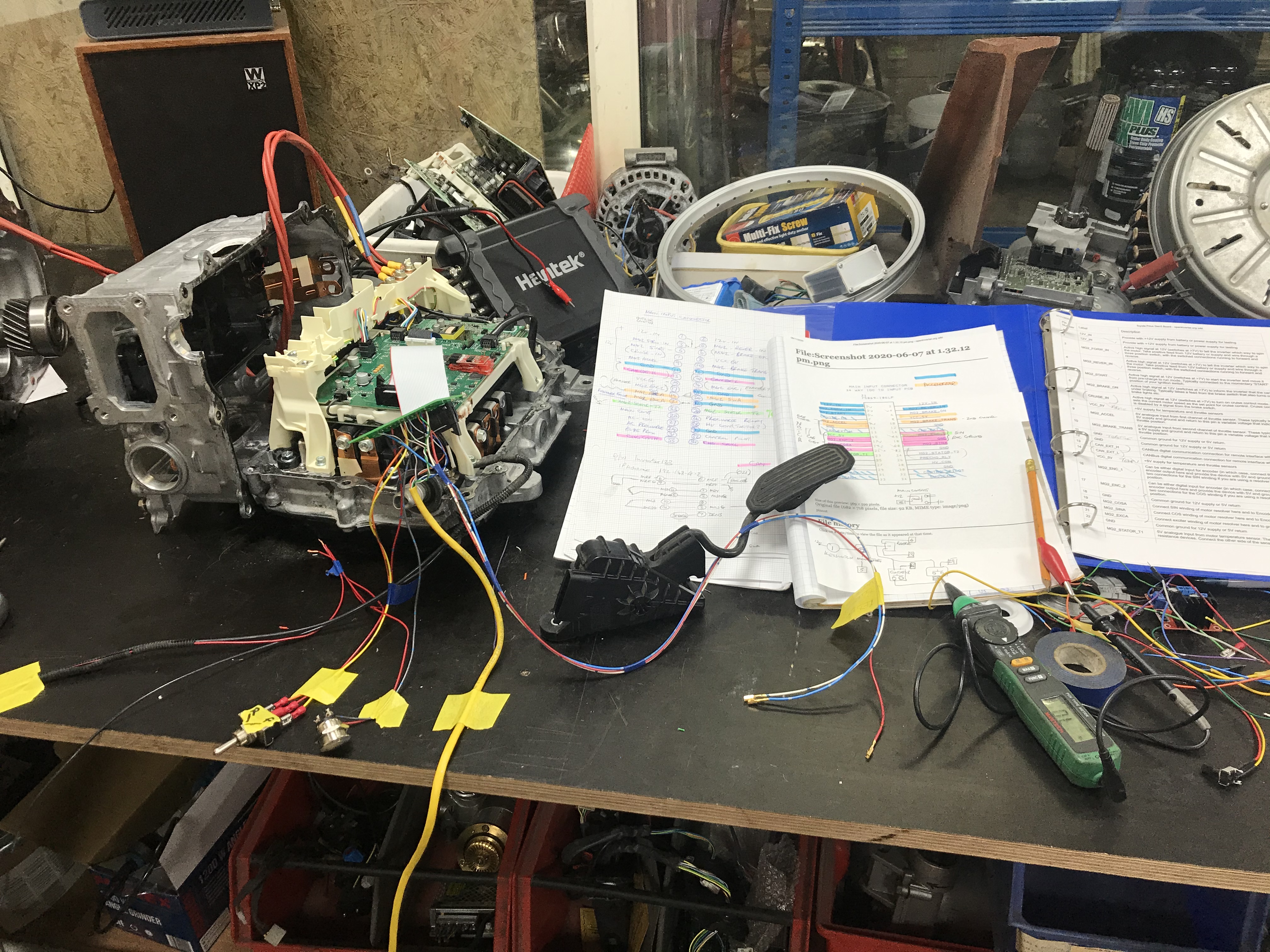

Realized I'd got the motor in backwards, fits nice and low in the correct orientation now with the driveshafts square and level.
The new brain arrived from Damien and I spent a challenging couple of hours soldering all the connections on but it's installed in the inverter and blinking at me now and showing all the right voltages.
I'm struggling a bit with where to attach the common wires of sin+cos coils? in his tutorial he shows them on a prius board coming from pin 2 on the grey plug ,

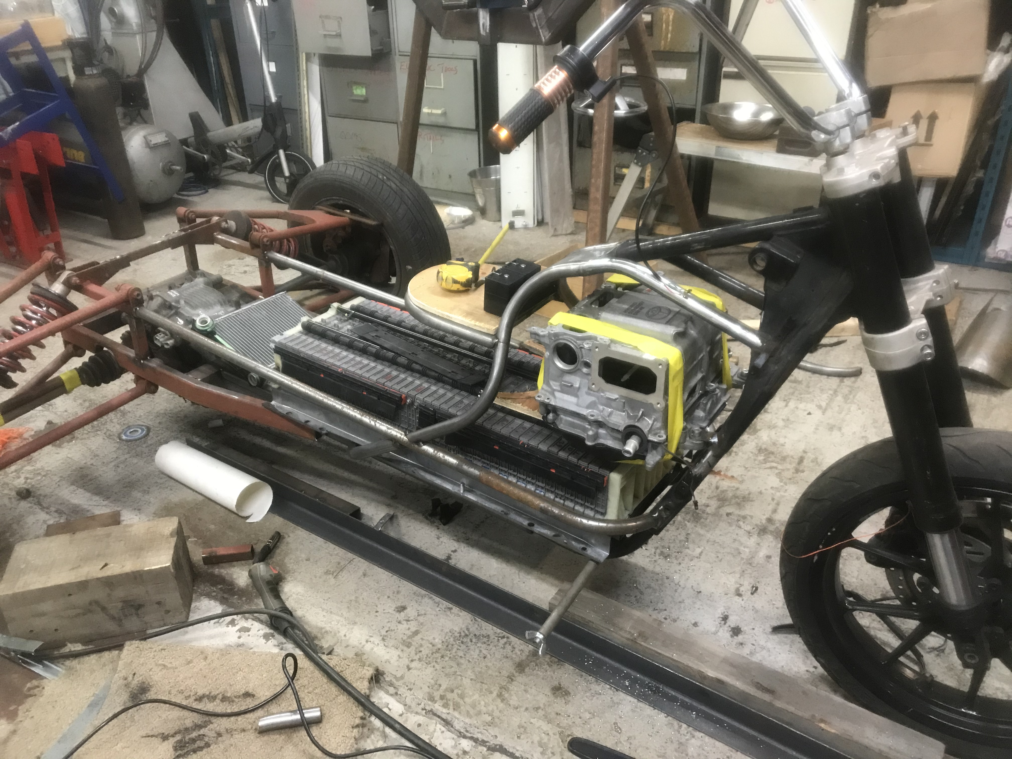

Re: Yamaha/Yaris/Toyota MGR Trike testbed build
So, a Sunday morning, a pack of cutting discs and the bike frame , time for some CAD (Cardboard Aided Design) and GTE (Gaffer Tape Engineering ) and the trike progresses.
Meanwhile on the electronics side I read again the assembly instructions and solved the resolver question , next job make up the plugs and sockets that connect to the 34 way ribbon.

Extended the wheelbase by 6”

A couple of useful hours today hooking up inputs on the breakout board

Now the festivities are out the way , got another couple of hours to get some more work done putting some torsional stiffness into the frame.. and somewhere to sit

The learning continues ..
I've been struggling a bit with my early Yaris/Auris board and the changes that need to be made. In my haste, I plugged it all in as soon as I got it blinking and started looking for resolver plots. Then the learning curve went into an overhang.. I later discover 1. the notch annotation on the ampseal board is the wrong way round, 2.the MG2 current sensor is reversed which may have shorted the -5v supply. 3. R41,R42, R45,R46 need swapping out for other values and 4. to use with a resolver R30 and R29 need to be removed...
Good news! , my desoldering skills have improved no end! having discovered the wonder of bismuth desoldering alloy ( hint .. plenty of flux and mop it up well with wick before re-tinning pads and resoldering, otherwise it can be brittle... ask me how I know). An upside of this is that I have been able to harvest unobtanium parts easily from several old Toyota boards. I've made most of the changes above except for pulling one of the tracks off MG2 current sensor which will need further repair so will be ready to go hunting for jitter soon.

yay ! Repairs have been successful and I have had the MGR spinning in open loop at 150v , now to sort out the current sensor connection, load the FOC software , make all the resolver connections , build the contactor setup and fit it all to the bike...onwards and upwards
