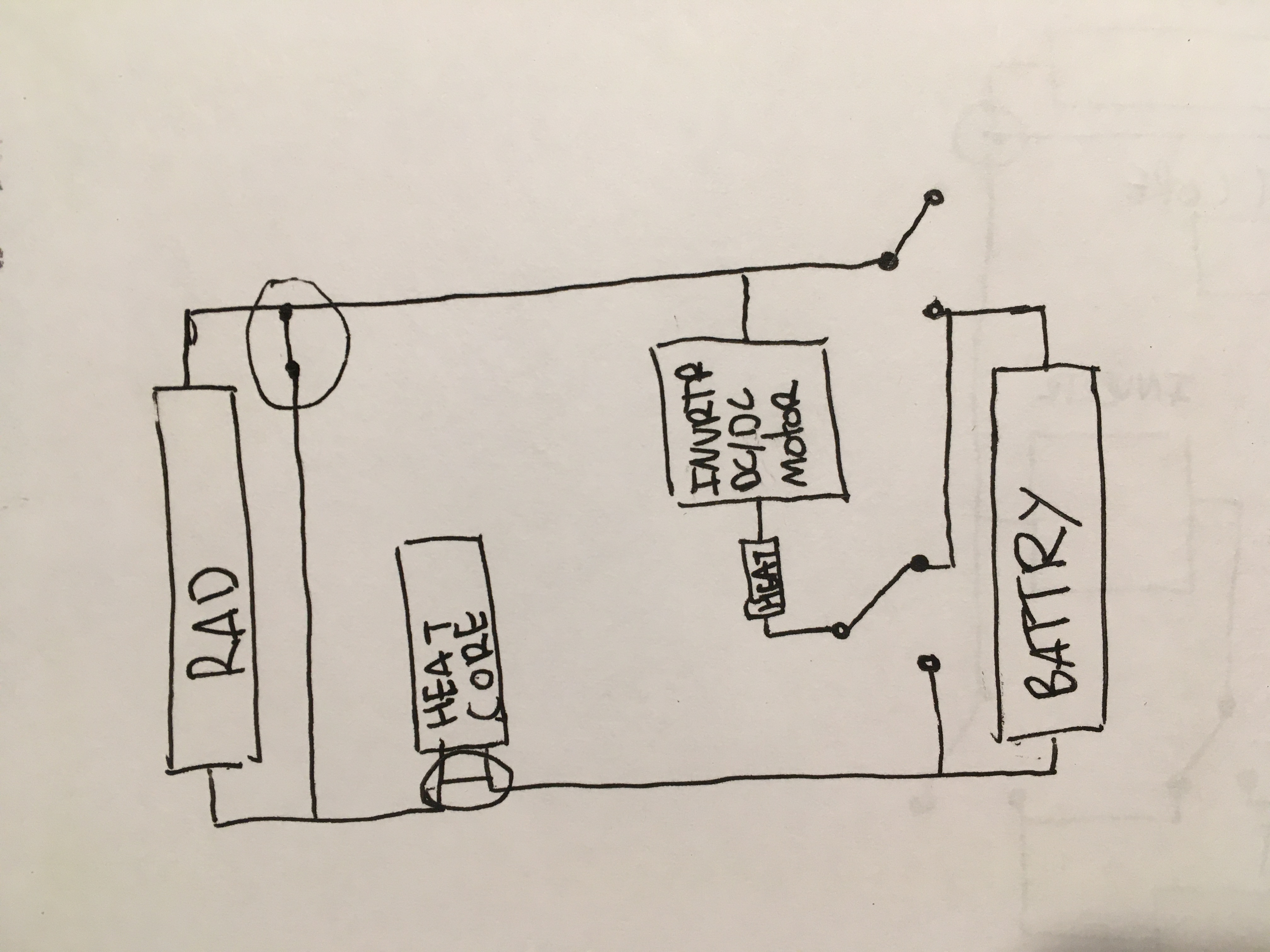

With A couple valves you can very easily switch from a series coolent loop to a parallel loop.
I’m trying to maximize as much energy efficiency as possible. so any “waste” heat, I’d like to use if I need it. Ether heating the batteries, or the cabin.
A very crude but simple drawing of the basic loop.
