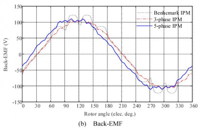

The Leaf's bEMF is the "Benchmark IPM":
It is a little difficult to see, but there is no obvious asymmetry - and I would be very surprised if there was any intentional asymmetry.
(Sorry if this is known/obvious)
