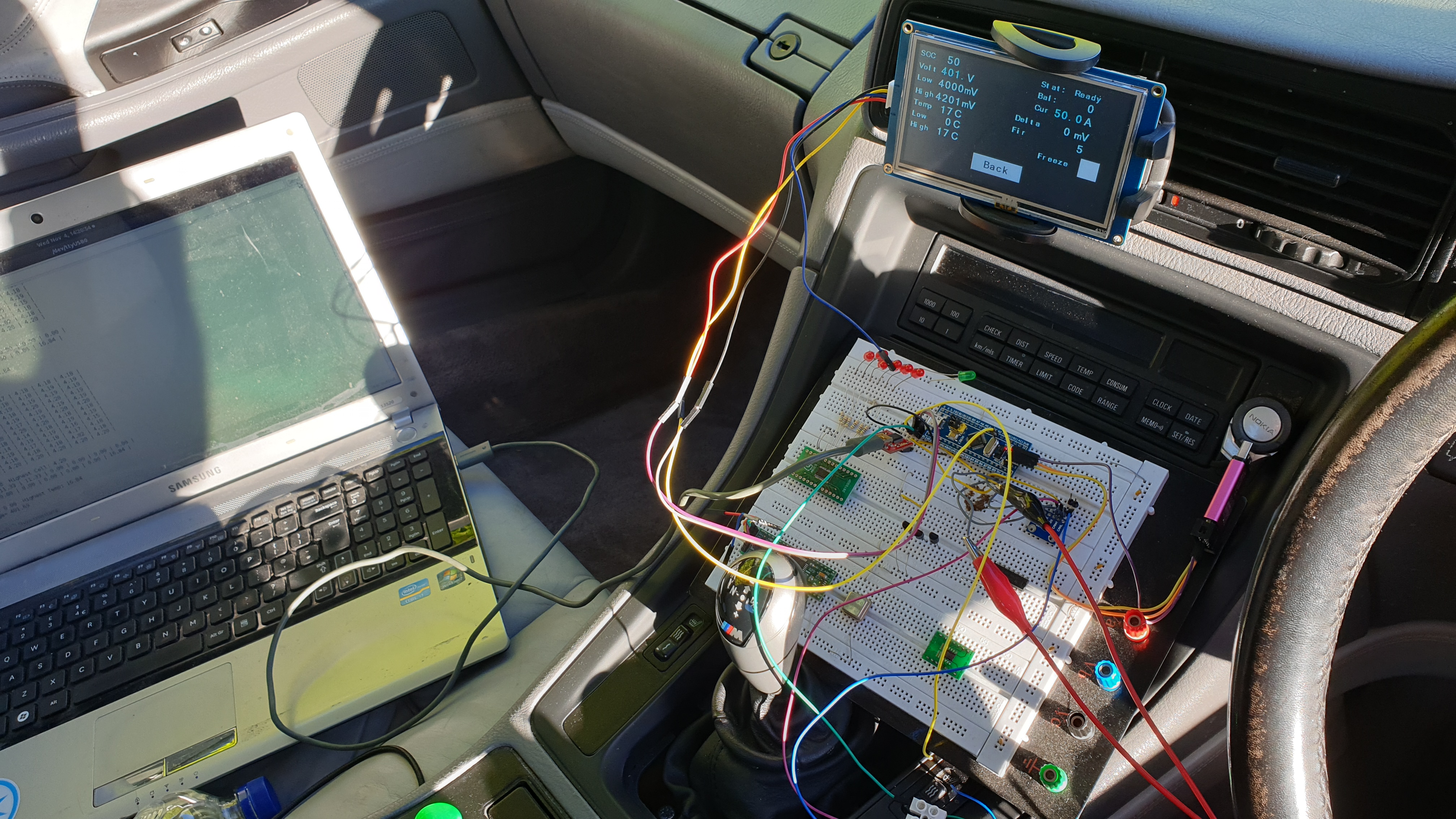

Not really sure what to call this or where to put it so putting it in bms area for now but will apply to a lot of things. I started playing with a 4.3" nextion display and Tom's simp display software. Original plan was just to use it with simpbms in the E31 but of course that would have been too easy. Also wanted to get serious with learning STM32 so started getting a blue pill to send serial data to the display using both the Arduino STM32 core and libopencm3. Figured I could ease myself in with duino. Yeah, that was fun. Also bought a book on STM32 assembler :
https://www.amazon.co.uk/STM32F103-Arm- ... 1970054018

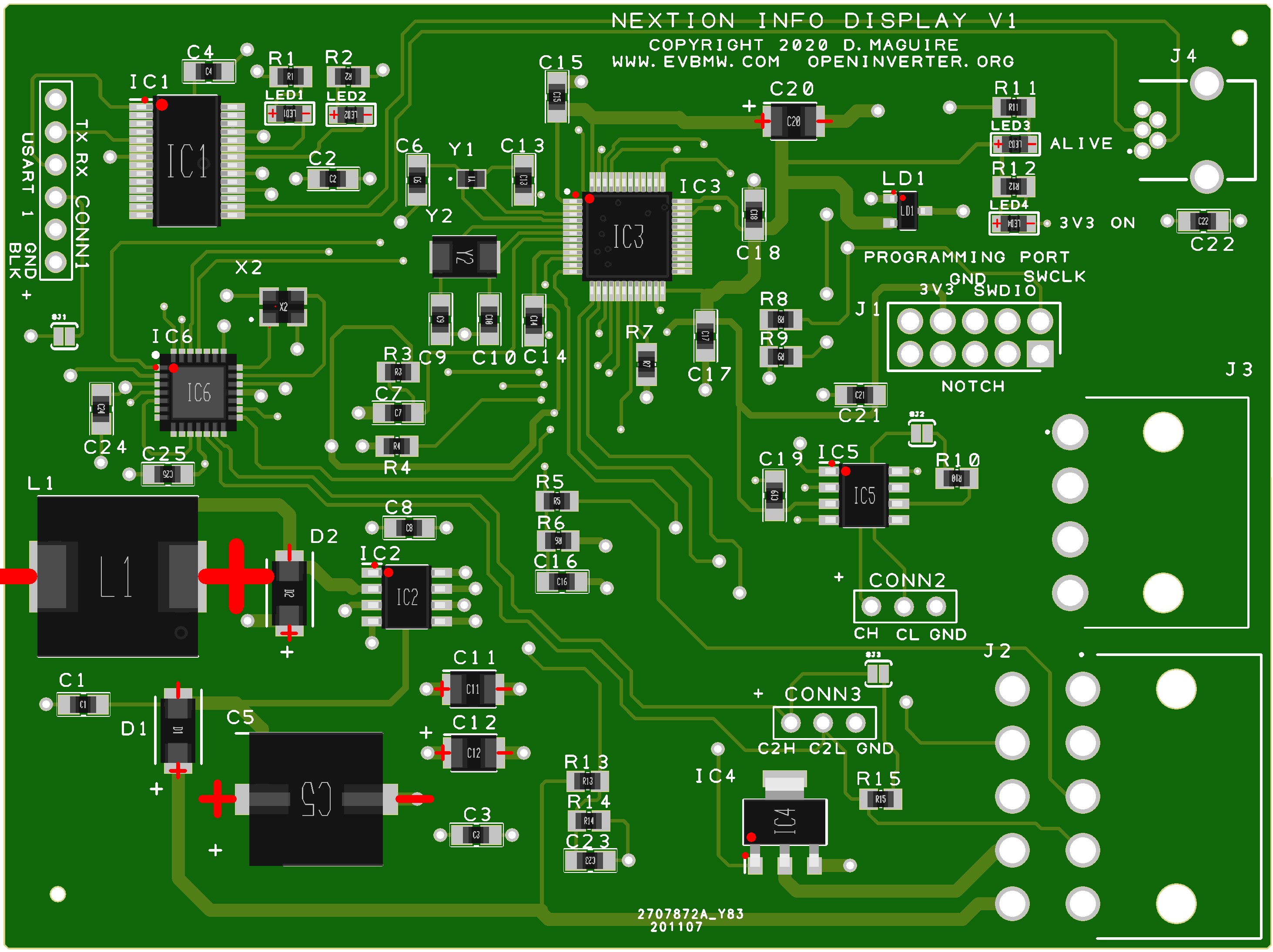

This I could get used to. So been working on this in my "spare time" and finally bit the bullet and designed a board and of course ordered 10 from JLCPCB because Damien designs always work first time :)
Features :
-12v power
-Fits behind 4.3" nextion display and fits a dash phone holder.
-Molex mini fit jr connections (ripped off from Tom)
-2 CAN channels. One based on the onboard STM32 controller , the other using a SPI MCP25625
-I 12v digital input
-1 low side switch output
-Measures 12v supply via adc
-USB on Serial 1
-Nextion on Serial 2
Uses :
-General purpose interface and display for all VCUs (leaf,gs450h etc) over can. As the Nextion is a touch display it allows for sending data to a vcu as well as receive. e.g. changing power settings.
-Display for Openinverter BMS. This is a major design goal as it will be going in the E65 very soon.
-Display for any CAN based bms e.g. volt and bmw.
-Controller for openinverter boards via can. Going in the E31 for this purpose.
So there it is. Will be opensource on github once I get the bugs out.

Features :
STM32F103C8 MCU
2 CAN busses with optional termination
USB port connected to USART1
Dedicated USART2 connection for Nextion
Power Via vehicle 12V or USB
Ability to Monitor 12V supply voltage via ADC
STLINK Programming port (SWD)
One Low side driver output
One 12V digital input
5V output for BMS slaves
Time to kick back and watch those orders roll in and my Lanzarote retirement fund grow :)

Hi Damien. Any progress with the board? I am trying to run the board, what .bin file you are using to start with the board.
I am connected to the board by ST link, can upload some .bin files as a bootloader but there is no connection by onboard USB port from arduino.
Posts: 4008
Been thanked: 1139 times
Re: Nextion Based Info TouchScreen Display Thingy
You need to upload the bootloader hex and firmware hex via st link. Not the bin. You should then have the led flashing.
Posts: 4008
Folks, please do not send me pms looking for one to one support. We have enough people on here now to address the question of compiling the sketch in arduino and uploading a hex.
