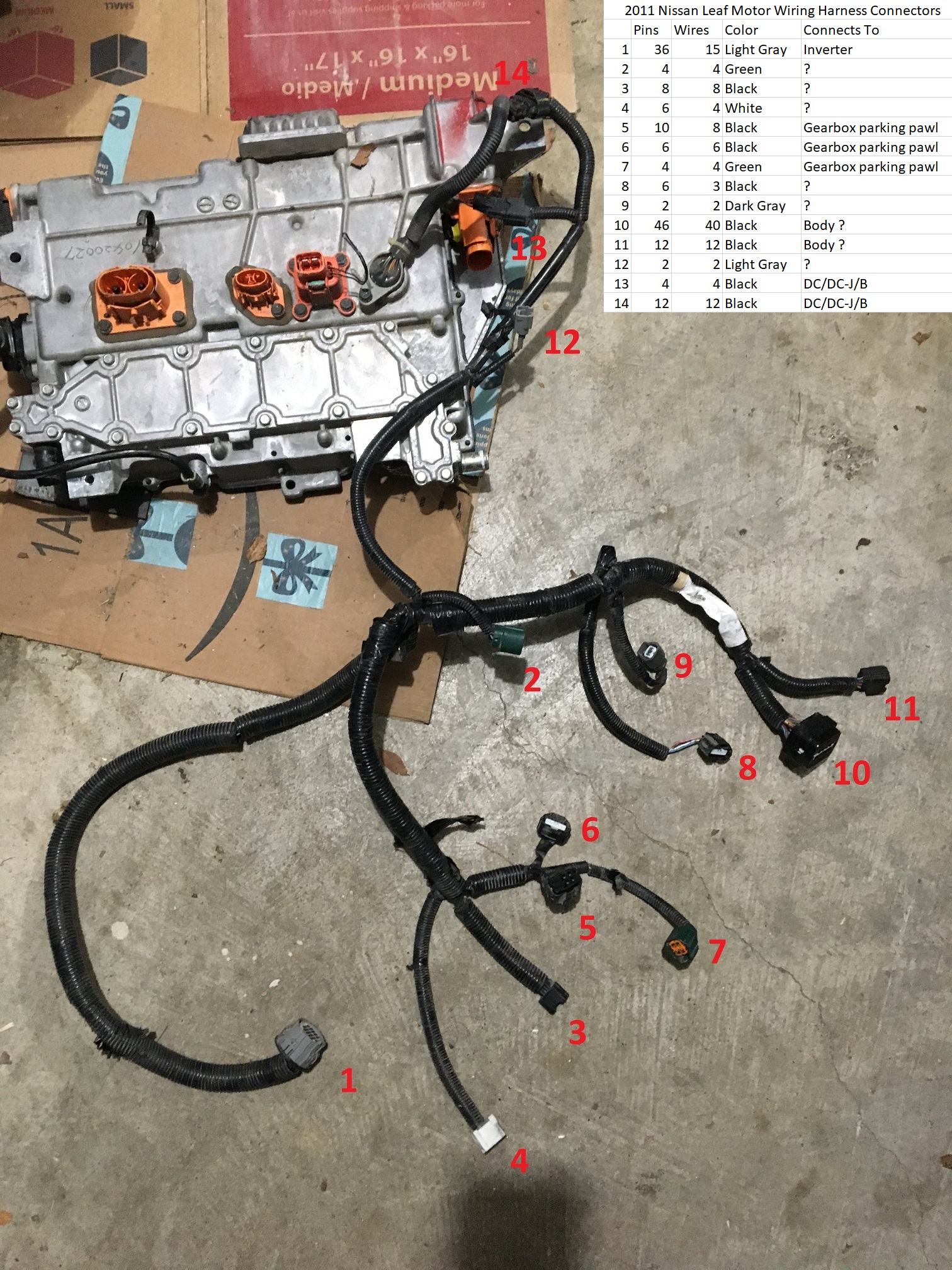

Re: Leaf Gen 1 Inverter Board
Hey Guys, I purchased a VCU board from Damien and I am starting to gather the connectors and get the wiring sorted out for a 2011 Leaf motor. I have the motor wiring harness and I am trying to figure out the best place to tap into it for the VCU and what connectors from the harness I will need. Does anyone know what all these connectors go to? Unfortunately, I was not the one who removed my motor and parts from the Leaf vehicle.
Thank you!
Thank you!
- Cookie6000
- Posts: 247
- Location: Wicklow, IRL
- Has thanked: 12 times
- Been thanked: 33 times
Hey.
If it's one of the original VCU's then it is really really simple. Ignore all the wiring above and concentrate on the harness coming out of the inverter. Can H and L, perm 12v, switched 12v and gnd. Think i added some of my schematics in here somewhere too. All is explained in Damien's video from the very beginning:
Follow this and James and my work on this thread and you can't go wrong. Let us know if you need any more detail after a good search of the thread. Lots of info on my videos too
Thanks guys for the helpful info. I have read through Cookie's Audi thread, and the info there as well as the wiring schematic is helpful. The Leaf VCU documentation and Front End thread seen here is good too: viewtopic.php?t=643
I still think knowing what those plugs go to from the inverter harness is useful as I am deciding on what Leaf parts I will reuse. I was thinking about reusing the DC/DC.
Also, my conversion will use the reduction gearbox. Does anyone know what state the parking pawl is in at rest? As in, will I need to get it working to be able to spin the gearbox? Has anyone been able to use it as an emergency break?

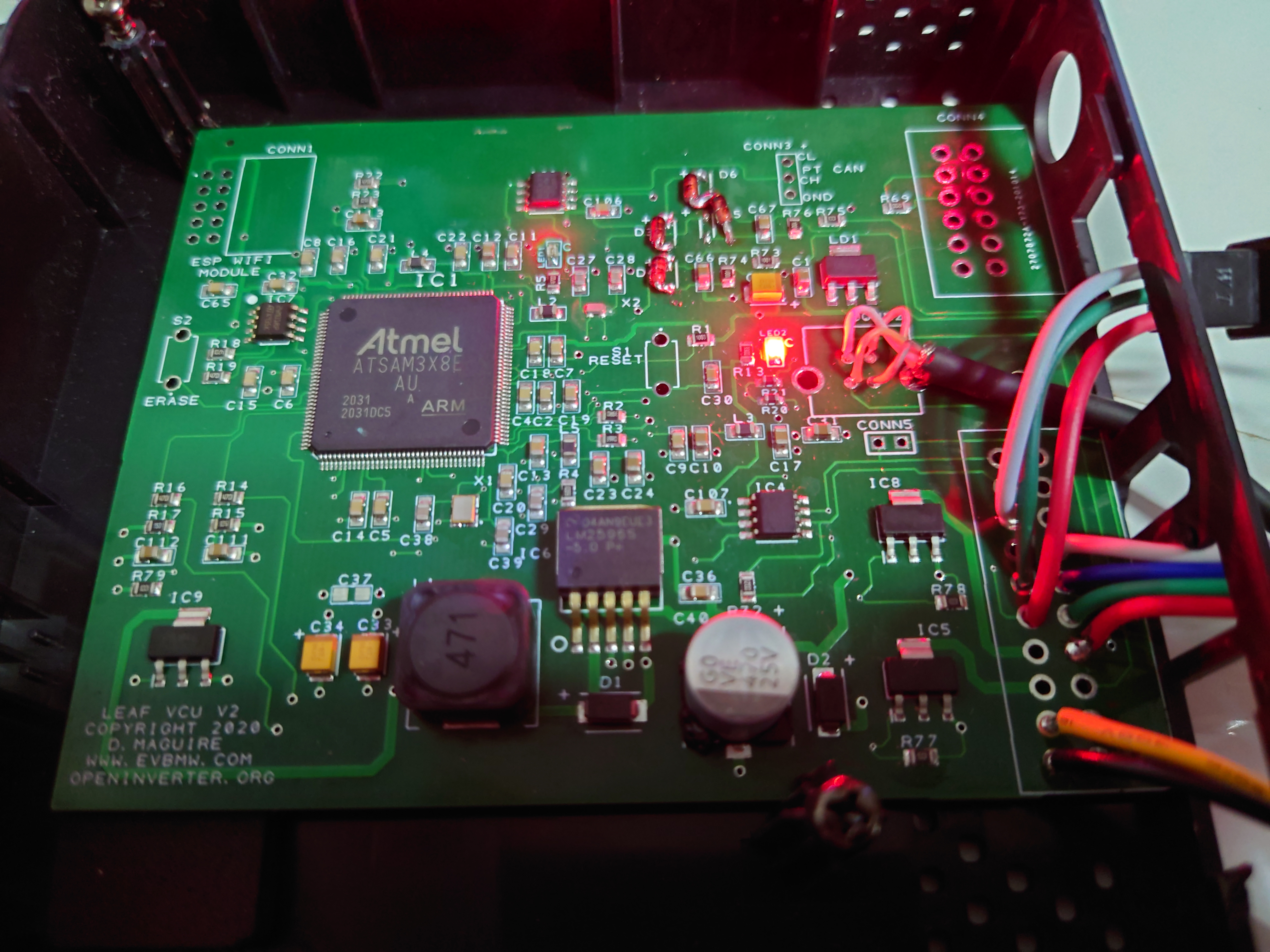

LED1 is flashing at me!
There are no 32pin connectors or housings this summer,
So I ghetto modded VCU in a old "TV on demand" box and used random connectors that I had laying around. Yours, - Cheap S.
I just calibrated throttle last night, showing values between 0-100 in serial monitor now.
Next "night shift" I will tackle the inverter-VCU wiring.
Need to find time to wire up some HV later to inverter.
