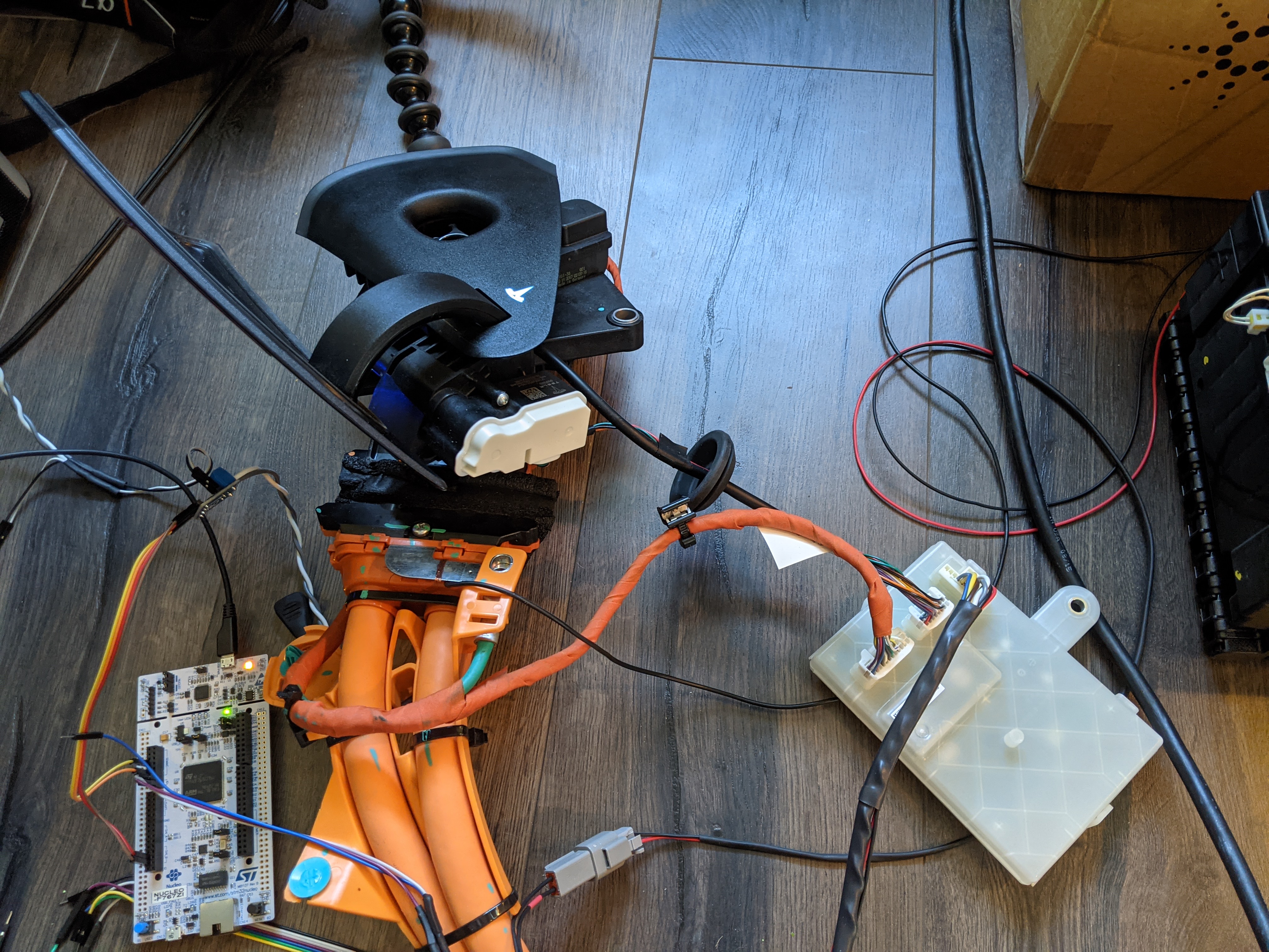

PS Pardon the mess, it's cold downstairs by my workbench, so I dragged some of it upstairs, and I wanted to share some news quickly. I'll probably have a nicer shot for Instagram tomorrow.

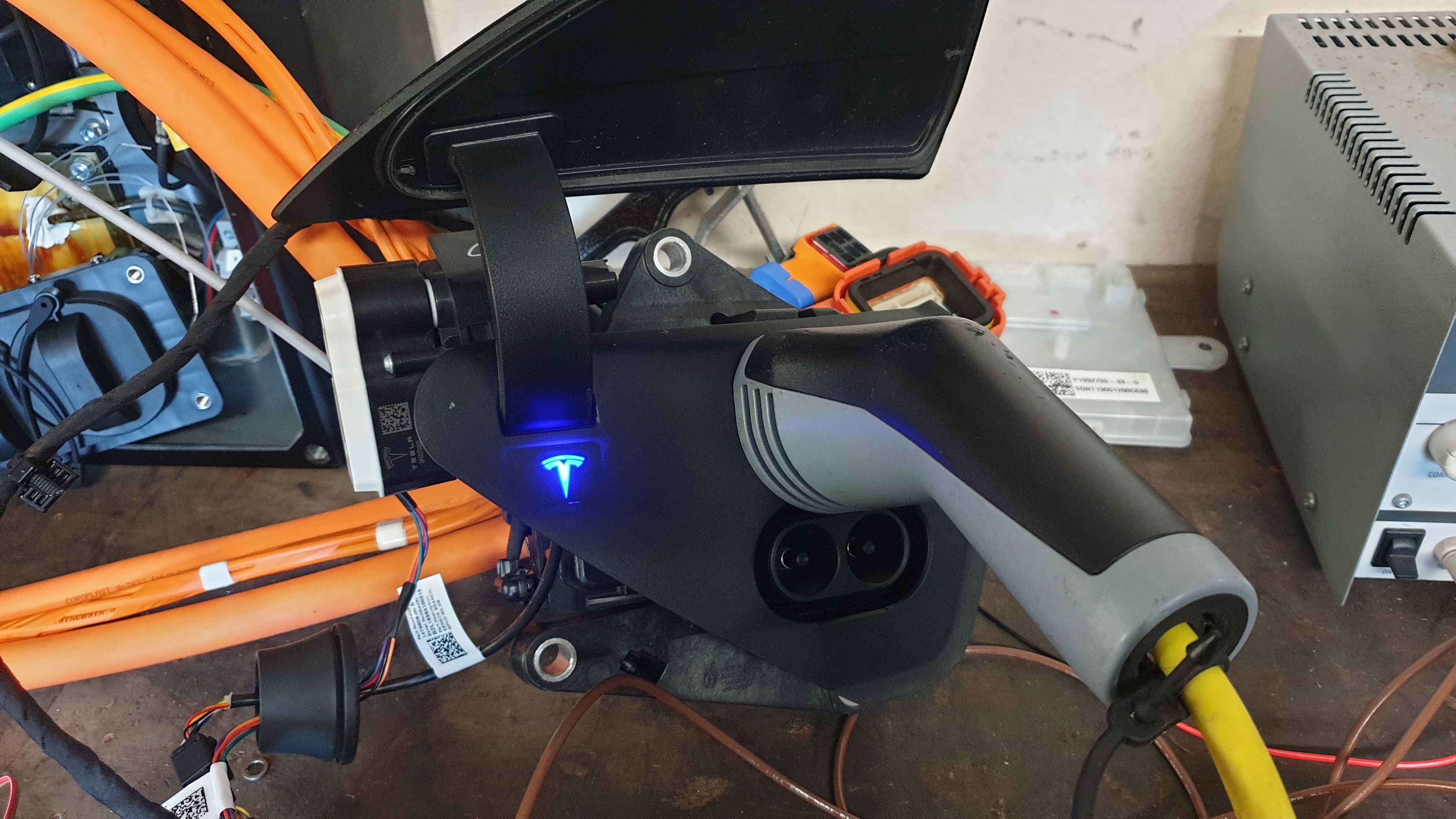

* Init code fixed
* Fixed standby state to be solid blue LED.
* Removal shouldn't trigger red LED now.
* Haven't removed unnecessary IDs yet, I wanted that to be a different commit to keep the changes clean.
Redacted repository updated. Going to go for a walk now. :)

Damien has the code which was used in the video above, and has sent me some data to look over. I'll be doing that today as I have time.
Punting on the ISA library for the moment, as figuring this out is probably a little more pressing. ;)

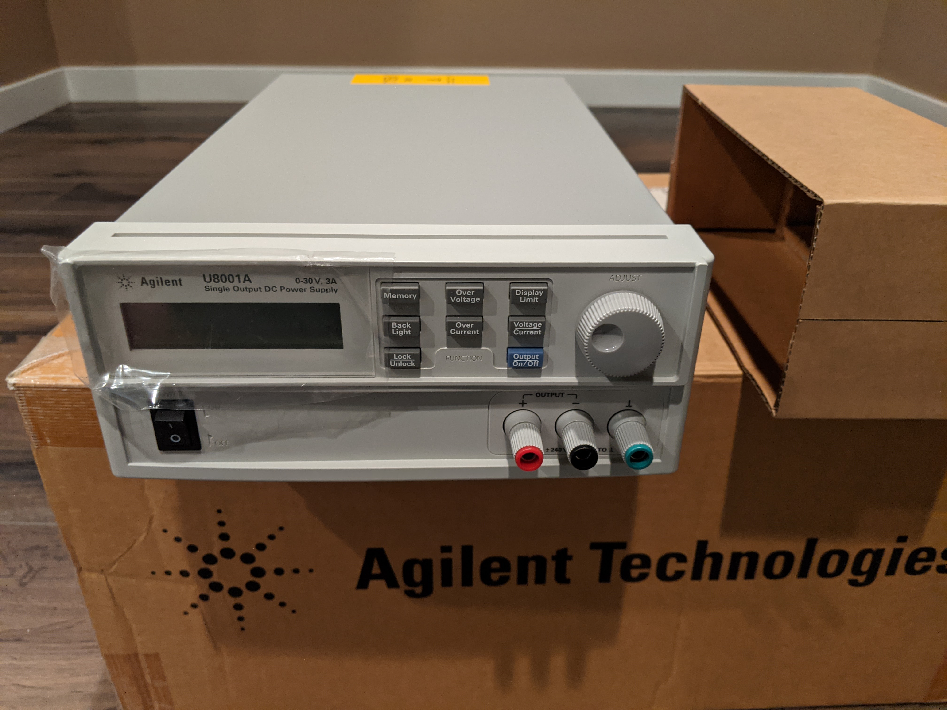

Super LOL moment.
So my unit when unhappy has a 5 second on, 3 second off pattern. I thought that was the CP ECU resetting itself in a watchdog type thing. Nope! It's my cheap Best Buy power supply giving out.
I now have a real power supply:
and it no longer does weird stuff. It also auto-closes itself after a 2 minute timeout, just like the car.
Tried getting the other older CP ECU to work, but no luck. That's all for tonight.

Jack Bauer wrote: Mon Nov 16, 2020 11:55 am Yep, very same happened to me. Musk needs amps.
Yeah I was like Damien's crazy, this works fine for me. ;) The power brick has a blue LED on it, and it was under the table in my office. So I didn't see when the light would go off... :D
I moved my test setup upstairs, and can see where the power brick is out of the corner of my eye. When I saw the weird stuff happening, and the light going off, I was like 'Well crap, Damien was right.' :)
Normally that Agilent / Keysight now is stupid expensive...over $450+, but the local electronics store had it on clearance for $250.

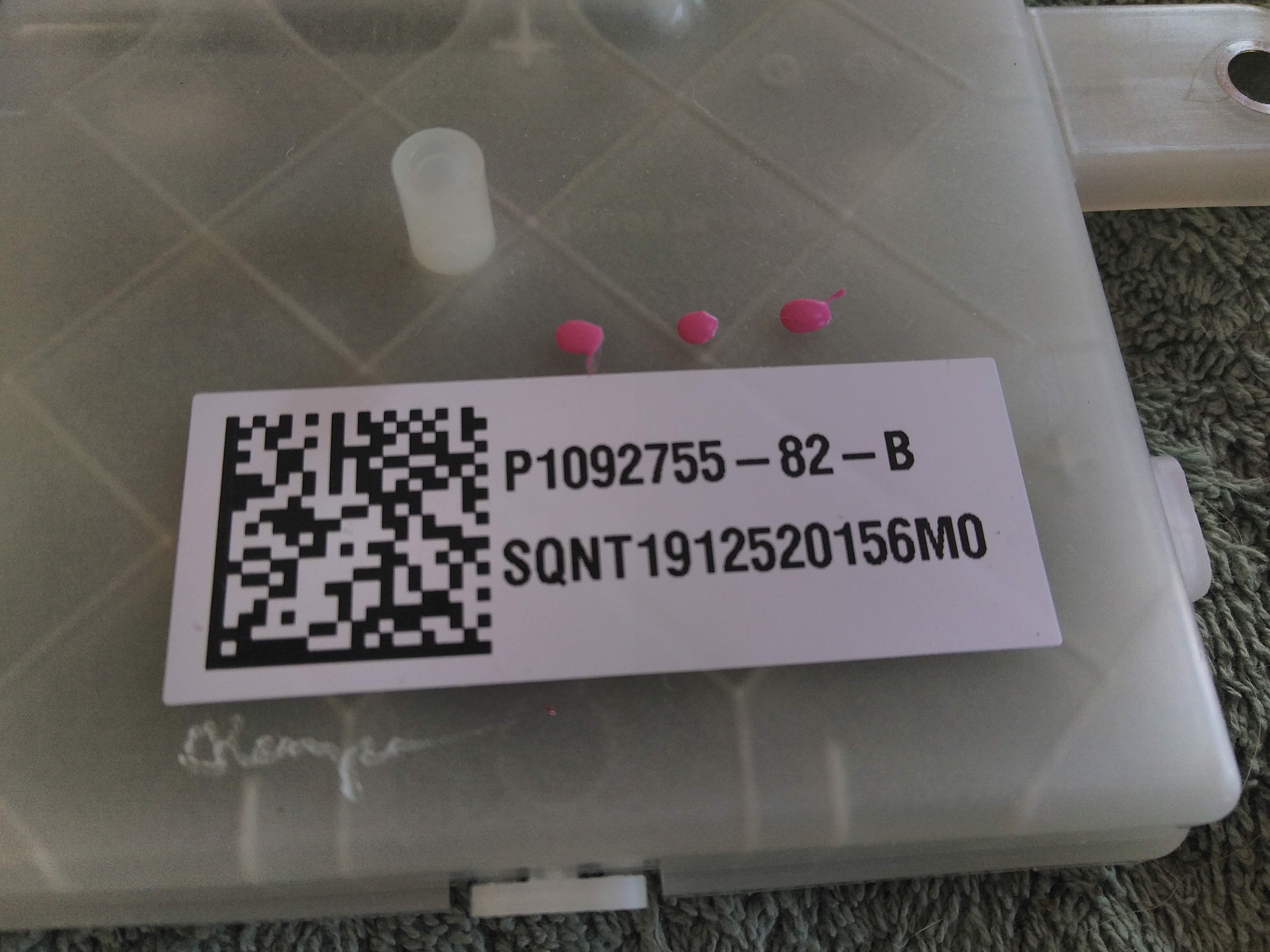

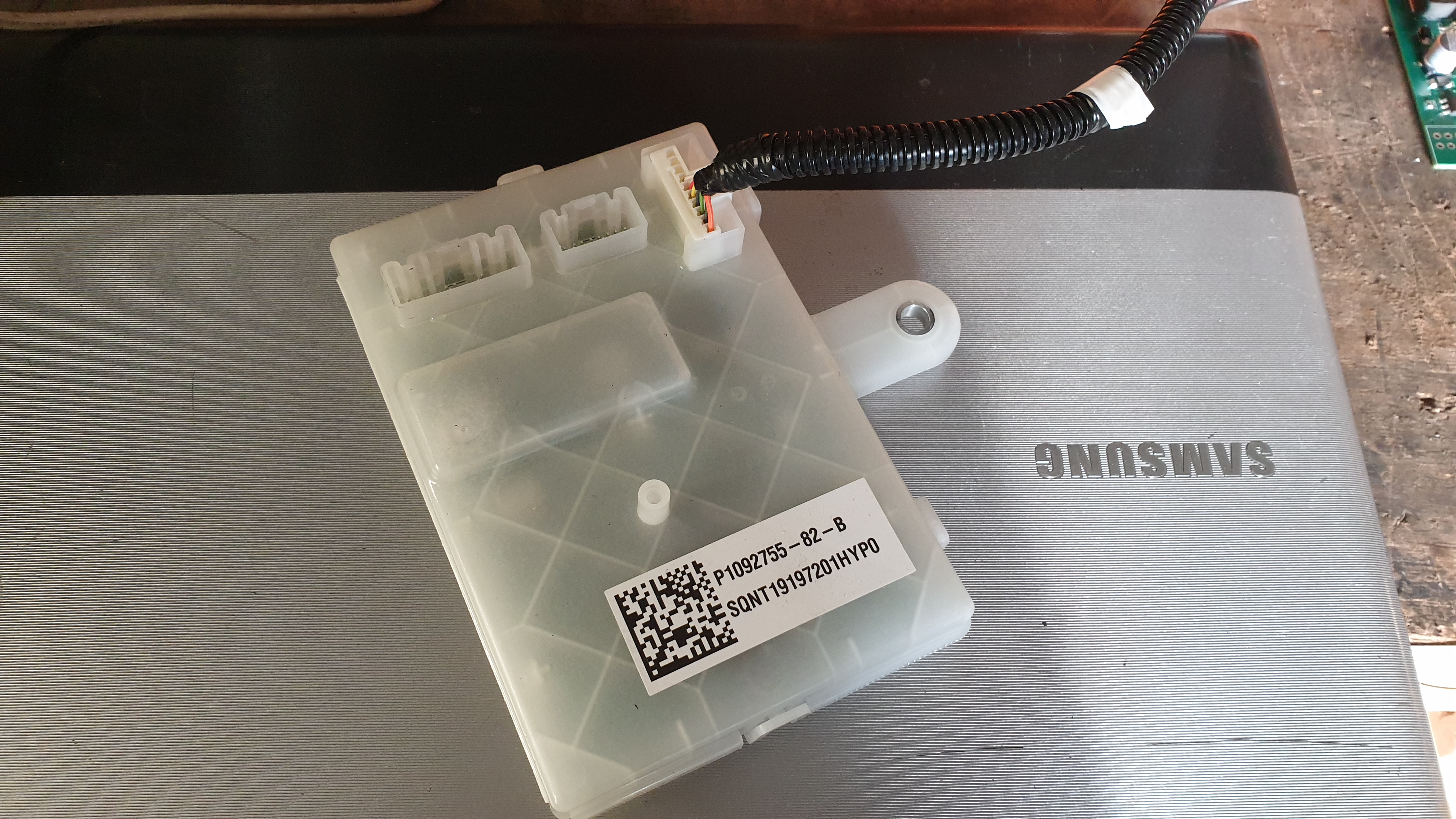

We have two more EU ECU's that we can use for test. We also have one of the EVTV CAN capture tools in a UK Model 3 if anyone needs log files.
One observation, all three EU ECU's we've purchased have the same part number despite coming from different European countries with a two year age difference. In contrast, the US ECU's we've purchased have different part numbers.

This might help explain some of the different US ECU part numbers and possibly some parts to avoid - "On some Model 3 vehicles, an electrostatic discharge might damage the charge port ECU radio transceiver. As a result, an alert displays on the touchscreen, and the charge port door is unable to be opened using the button on a charger handle. The charge port door opens using other methods."
https://static.nhtsa.gov/odi/tsbs/2018/ ... 3-9999.pdf

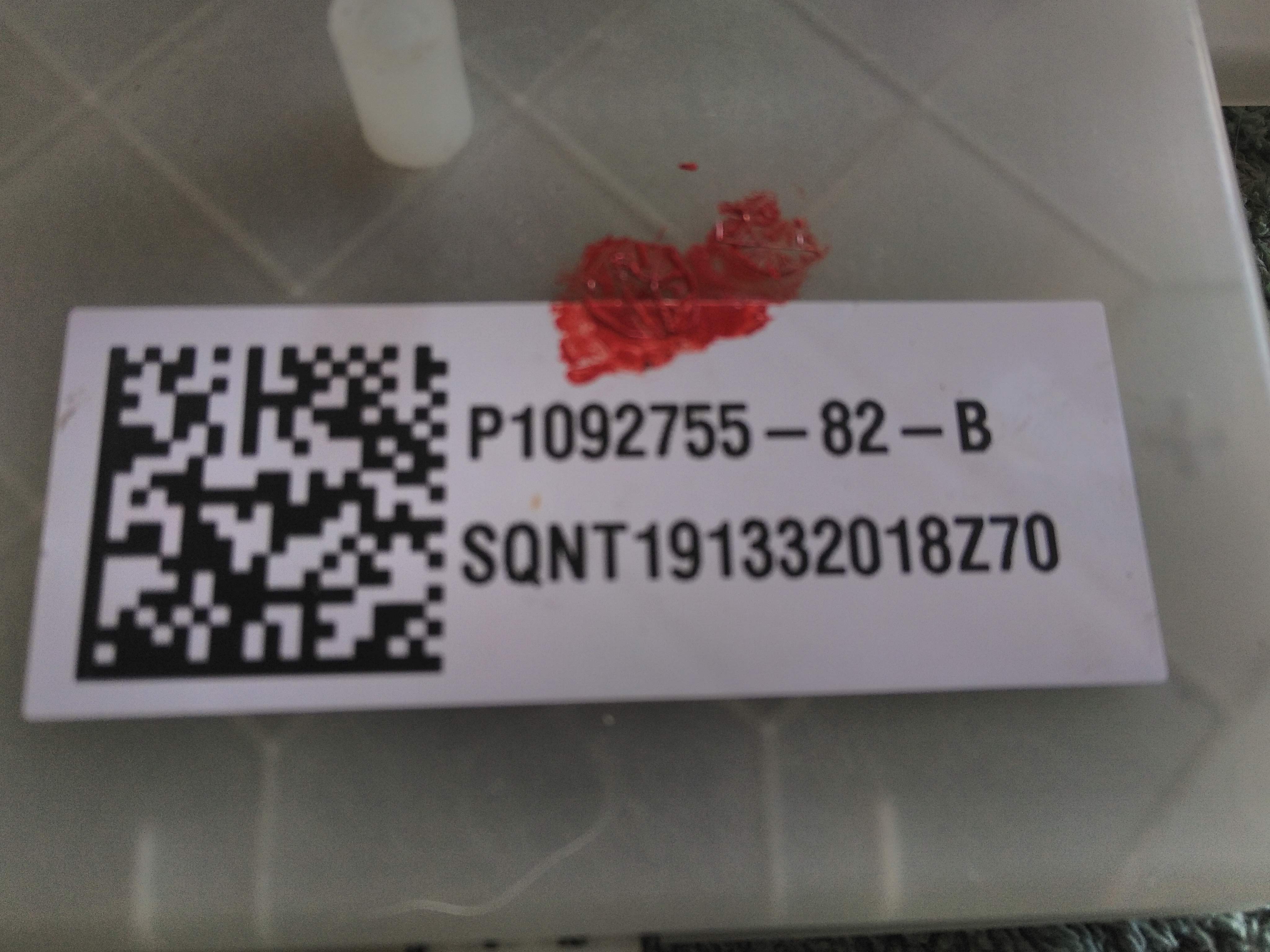

Finally got rid of the red T. I like blue. Blue is better then red. Also got my paws on another EU ccs ecu and this one comes with a bit of musk loom to make life much easier:)

Jack Bauer wrote: Sun Nov 22, 2020 1:22 pmAlso got my paws on another EU ccs ecu and this one comes with a bit of musk loom to make life much easier:)
Another P1092755-82-B :)

Interesting. Of note, my initially working model was a -98 (from a 2019), my car is a -99 (Sep 2018 delivery), and the initially non-working model was a -99.
New Electric Ireland wrote: Sun Nov 22, 2020 12:16 pm We have two more EU ECU's that we can use for test. We also have one of the EVTV CAN capture tools in a UK Model 3 if anyone needs log files.
I'm assuming some have -98 in the number, and some have -99 in the number. Those are the only two I know of for US ECUs. One of the "US" ECUs that Damien has does have a different number, and does not report itself as a US ECU. It reports itself as a "GB" ECU.
AFAIK there's only one number for EU, being the -82.
