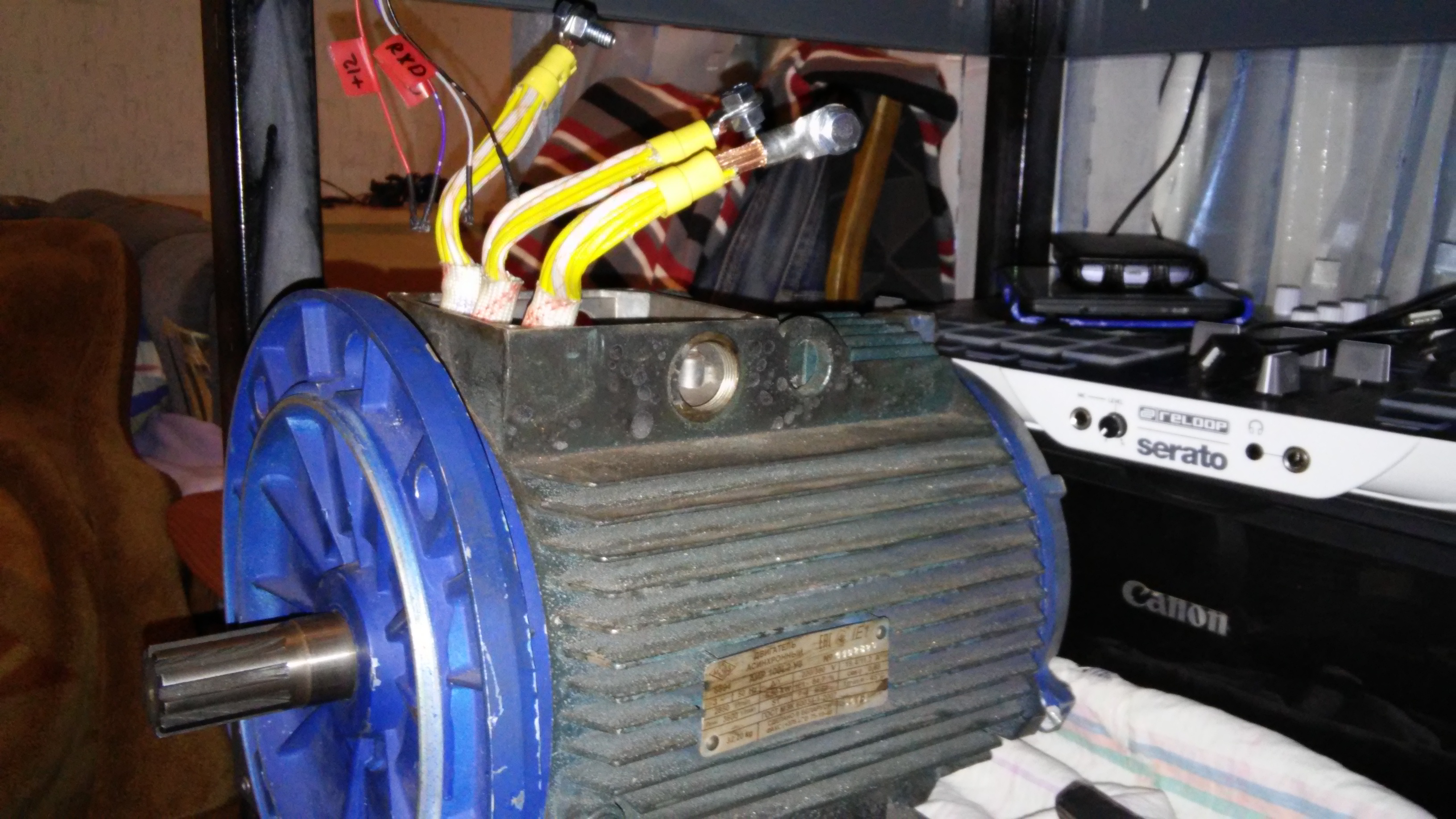

As powertrain, I chose ACIM custom made motor with combind windings(and that was a mistake, as I learned later),
copper rotor from kienle-spiess.de, custom made schaft and AMT 102-V encoder.
To power it I chose Curtis 1236-6301 inverter. Curtis inverter provides a torque control mode, which is incampatible with combined windings.
It also was a hell of a fun to somehow tune inverter, because no way I'll pay same price for a programmer as I paid for inverter itself.
In conclusion I've bought cheap laptop with COM port and used software from the internet...:twisted:

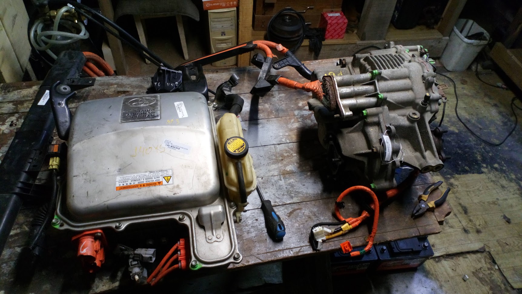

And from now, this project will become "open inverter" and with all new components, new tube welded frame included.
For now, I've bought Prius Gen 2 inverter, Gen 3 inverter, Lexus RX400h MGR, Damine's gen 2 board and Johu's gen 3 board.
Currently I'm experimenting with Damien's board as it is the simpiest one for pairing it with gen2 inverter and ACIM motor.
I believe for now I'm the only one who actually drove a vehicle, powered by Damien's gen2 board.
So here I am, continue to fight with issues here and there and thinking which way to choose, cheap inverter, or cheap control board...

Little update:
My MGR, powered by Gen3 inverter and v1c board now spins good in both directions.
I've tried to design adapter plates to connect unmodified BMW driveschafts directly to MGR's outputs, but for this to happen, they need to be 10cm in length, which is unacceptable. So i'll go the same way as Damien - cuttting and welding driveschafts.
Video is in russian, but nothing new is said there.
Now I'm on my way to local used parts dealer fot Lexus driveschafts.

All of a sudden: Hello everyone!
I've redone my project.
Now It is a frame buggy driven by MGR, powered by Prius 30 inverter and a pack of 28 Leaf cells.
Today it drove, I've tested it even with a passenger, we drove a little uphill and back without any cooling and it didn't even heated up.
I still need to clear all the power noodles mess and redone some suspension components and the most important part - I need to make a charger for 234 Volts battery. But atleast I can now ride fast and long. During 30 minutes tests voltage dropped only by 2 volts, which is great.
