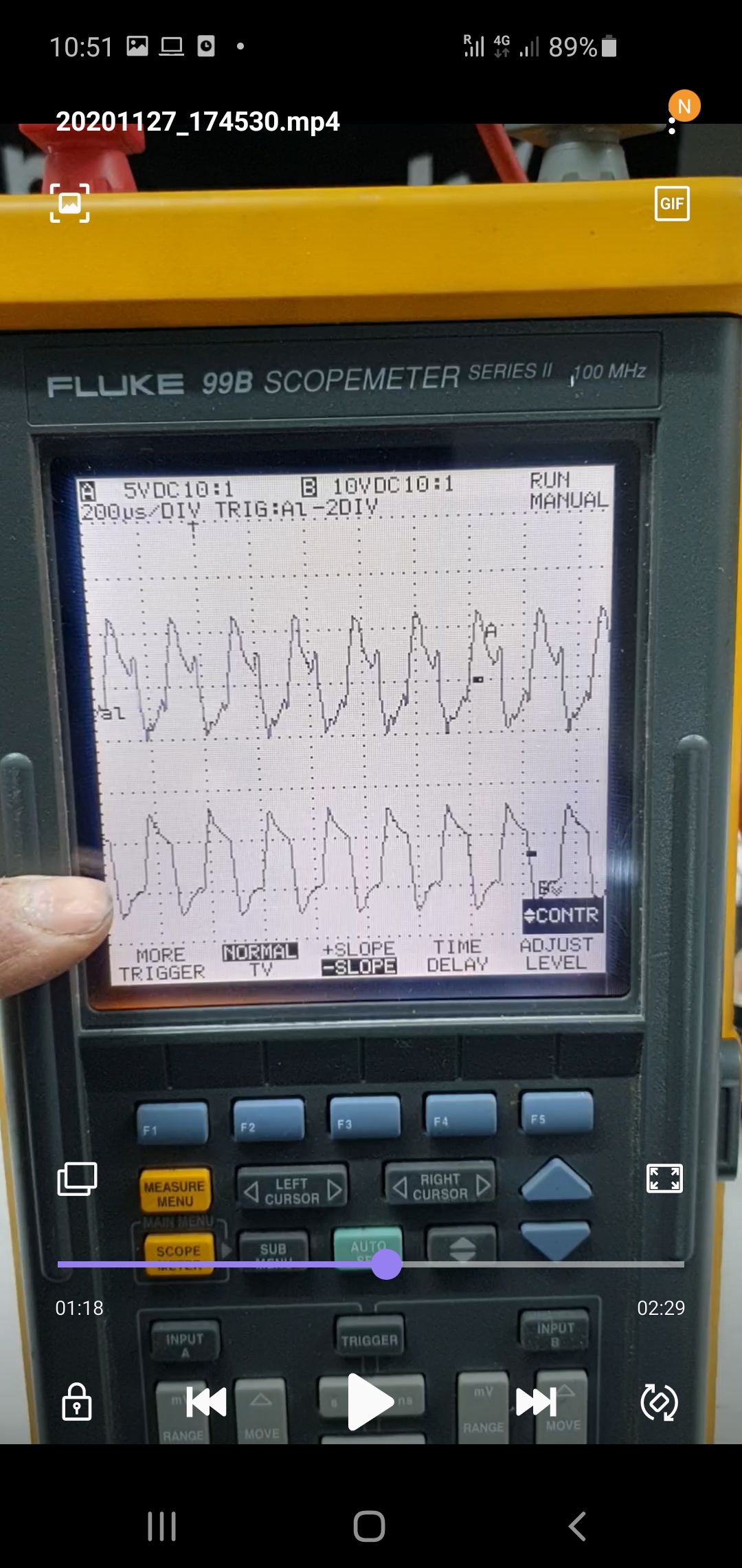

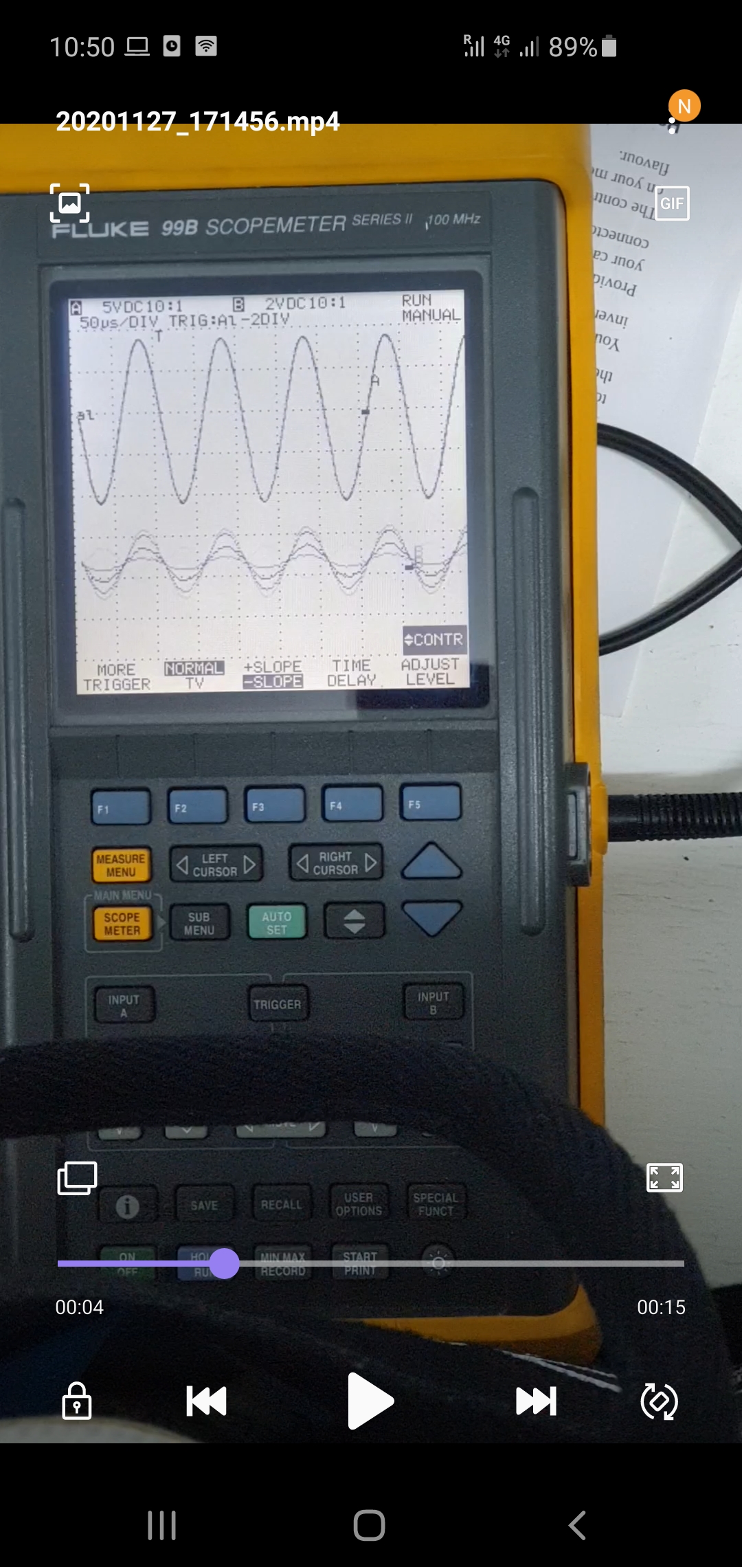

I see no or a very distorted Excitation feed. I am looking with a scope and have tried connected to teh PRius resolver and not. I am confident I have the prius resolver swiring correct having watched it on a scope with driven by the prius ECU in teh car (and it agrees with toyota wiring diagram
Does the board need depopulating or anything to generate a sine wave ?
Attached are phone pics of scope traces.
- Top trace is resovler excitation, bottom trace is sin or cos channel (not sure which). When I turn the road wheel/MG2 the amplitude of the lower trace changes by only a tine fraction.
This is just the Prius hybrid ecu connected (confirming resolver works)

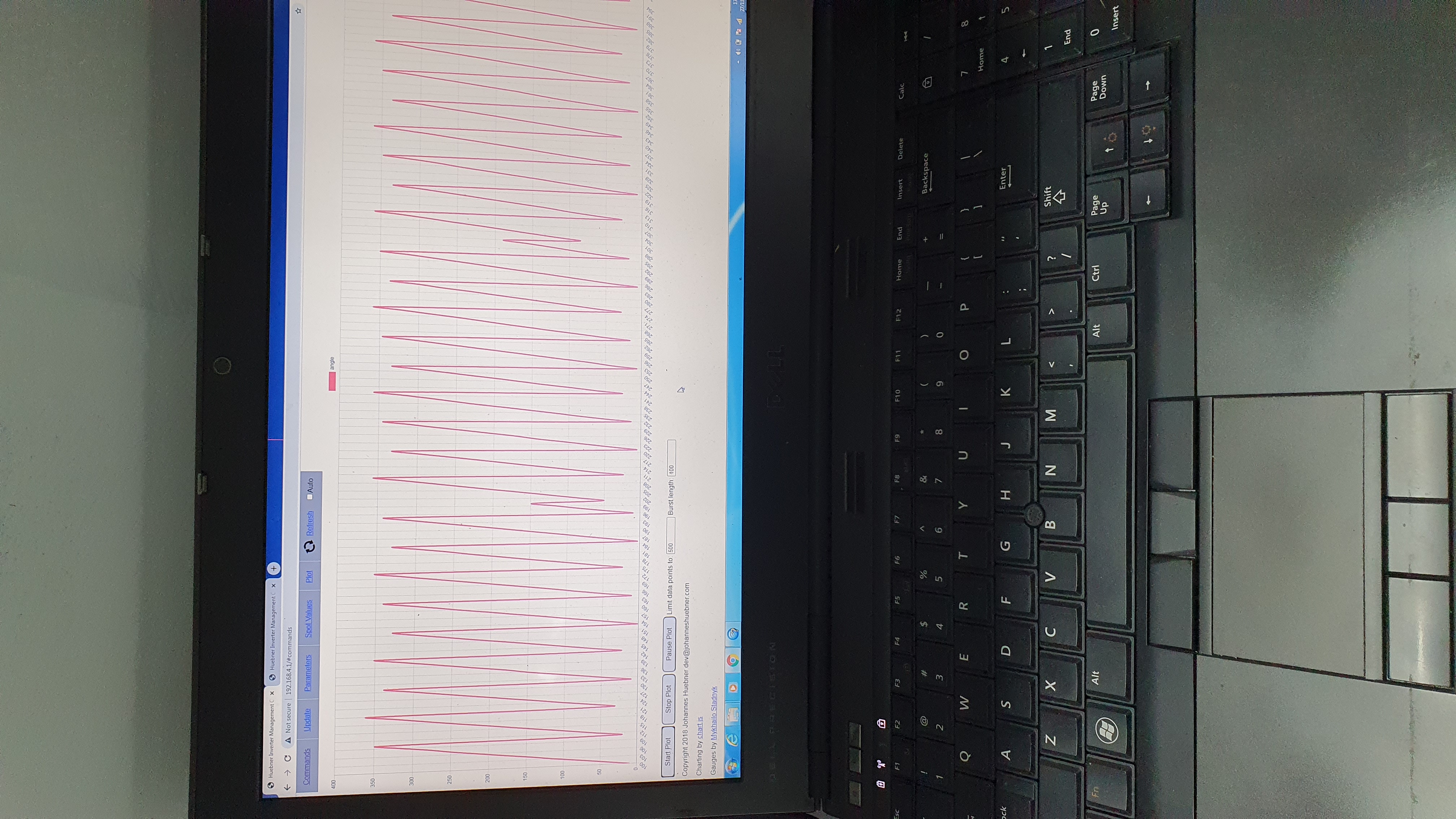

Looking at "Angle" in plot, I see this, irrespective of anything connected to resolver input or anything going round. Dunno if this fives any clues
