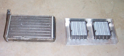

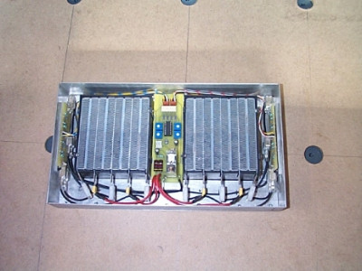

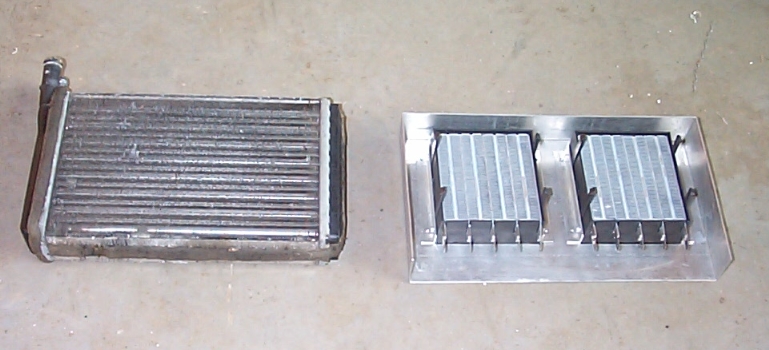

This was my solution in the 1984 Scirocco running at 192V. I used a pair of 240V PTC cores obtained from cheap fan heaters.
Cores were switched in 4 stages to give some control. Peak output around 4Kw.

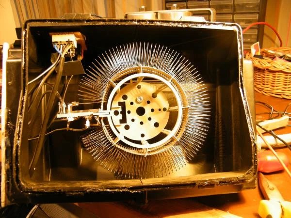

For sake of completeness I'll add the resistive heater in Polo.
The element is taken from a cheap electric heater. It has two 230V AC "coils" producing combined 2kW of heat. When put in series they match the 500V nominal voltage of Polo pretty well. I used a DC-DC converter and an IGBT to switch it on and off and I have rewired the over temperature switch to turn off the IGBT, not the actual heater current. Because the switch is not DC rated and would just produce an arc.
It certainly demists the windows and keeps passengers warm down to like 0°C outside temperatures. Below that it struggles, also because of the large voltage sag at these temperatures. P=U²/R, so 2 kW@500V becomes 1.3kW@400V.
