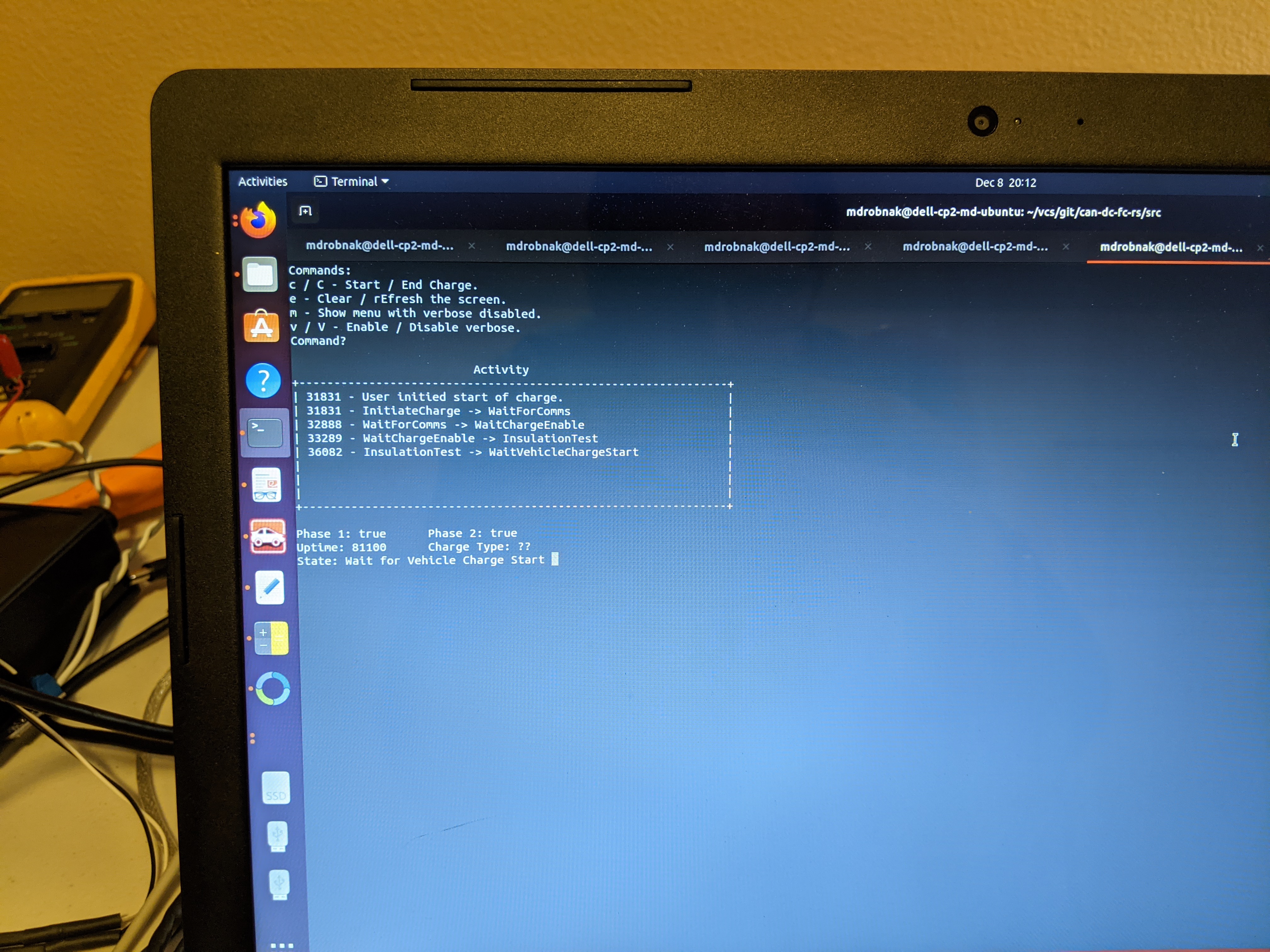

About 75% ported over to RTIC.
Frames send on time, yay!
"Uptime" timer no longer available for the moment.
Some weirdness geting it to conditionally configure things (for the F4 vs F7 for instance).
* Serial console is working
* Serial input is working
* 10 ms loop is working
* 100 ms loop is working
* RTC is working
* CAN still does stupid stuff if debugging isn't enabled.
-Matt

I'm working on CHAdeMO...Just that there's definitely more that has to go right in order to make it work. :)
With the timeout reverted back to 1 second, still getting some weirdness at times with the CHAdeMO testing. But it's not happening often enough for that to be the issue. No, there's some fundamental weird things going on.
Fun fact: The Tesla CHAdeMO adapter advertises version 0.9, not 1.0 as I would have expected. It also just sets the max time available for charge time estimate.
-Matt

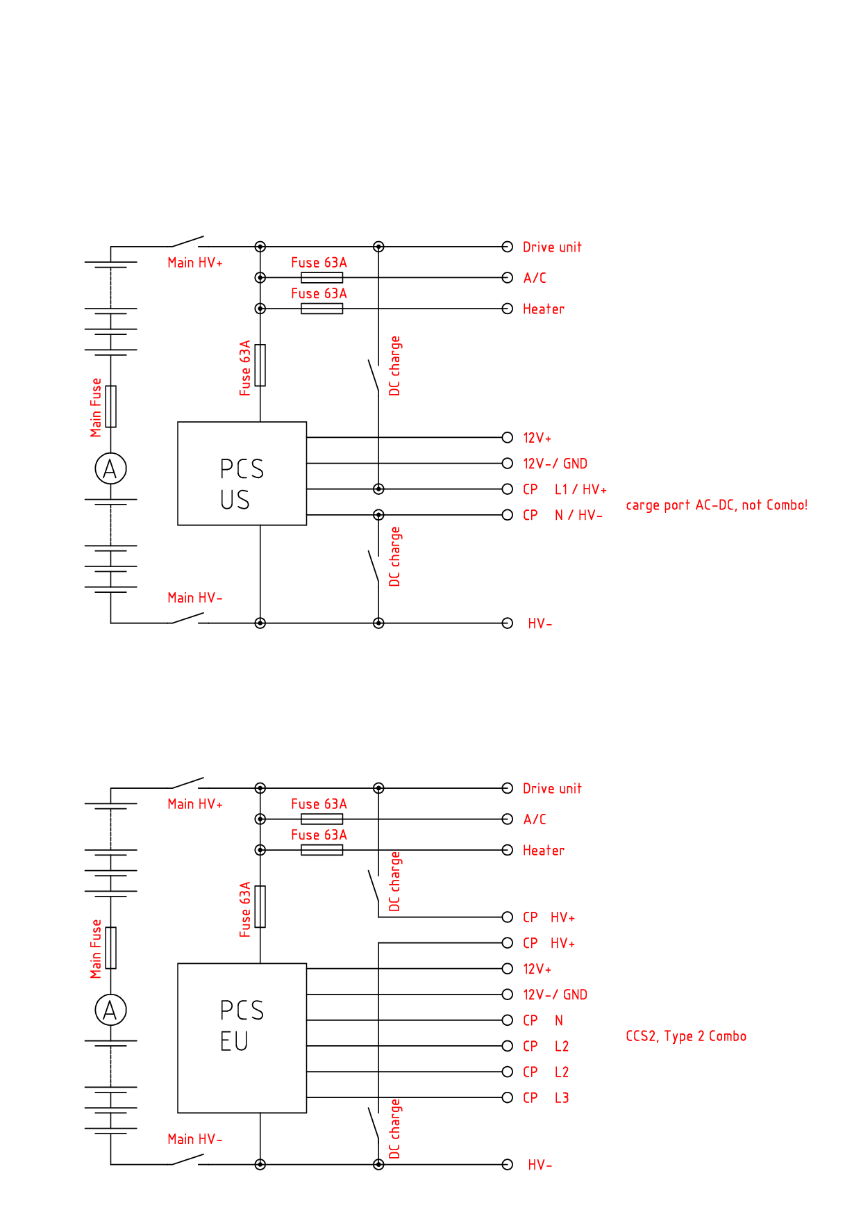

I have the penthouse here, and I can tell you that only 2 HV lines go into at the US model. These are always cnnectet to the AC side of the PCS and additionally switched for DC charging via 2 extra relays. The normal main relays have to be switched on for driving and AC or DC charging. Pre charging in managed by the PCS by convertig 12V to 350V, no Pre Charge relays!
I'm not sure about the EU version because I don't have one. But I know that it has an extra plug for AC!

Interesting. Not sure I want to hit the input of my charger with that much DC voltage. :D That does explain some of the behavior I see in the log of the CHAdeMO session (and presumably my supercharging session though I'm not sure I logged the right bus when I did that, and, eh whatever).
Did you do that diagram yourself?
-Matt
muehlpower
Posts: 690
Has thanked: 14 times
Been thanked: 141 times
Re: Tesla Model 3 Charge Port Controller Standalone Development
Post by muehlpower »
That's what I found while disassembling the battery. 400V is not much, in Europe the phases have 400V to each other!
The DC link capacitors in the PCS are specified at 500V.

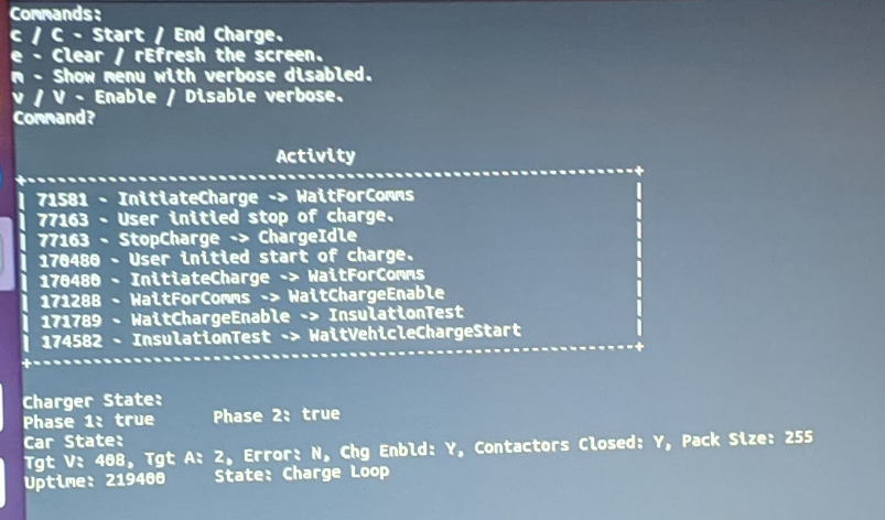

I was going to say bad news: It doesn't work, good news: It doesn't work in the same way..but upon reviewing the photo I took, the car _did_ ask for 2 Amps of current.
I missed a log message noting the state change into "Charge Loop".
Feel free to follow along with my code at https://github.com/mdrobnak/can-dc-fc-rs (this is open source).
Now to fix that log message, and figure out what the car did vs what I'm doing.
-Matt
mdrobnak
Posts: 692
Post by mdrobnak »
Actually the car asked for more than 2 amps. Silly poorly structured code :D
I think the fact that it doesn't see any HV is what is stopping me. I may also be able to make the EVSE side lie and it will take that. More testing...

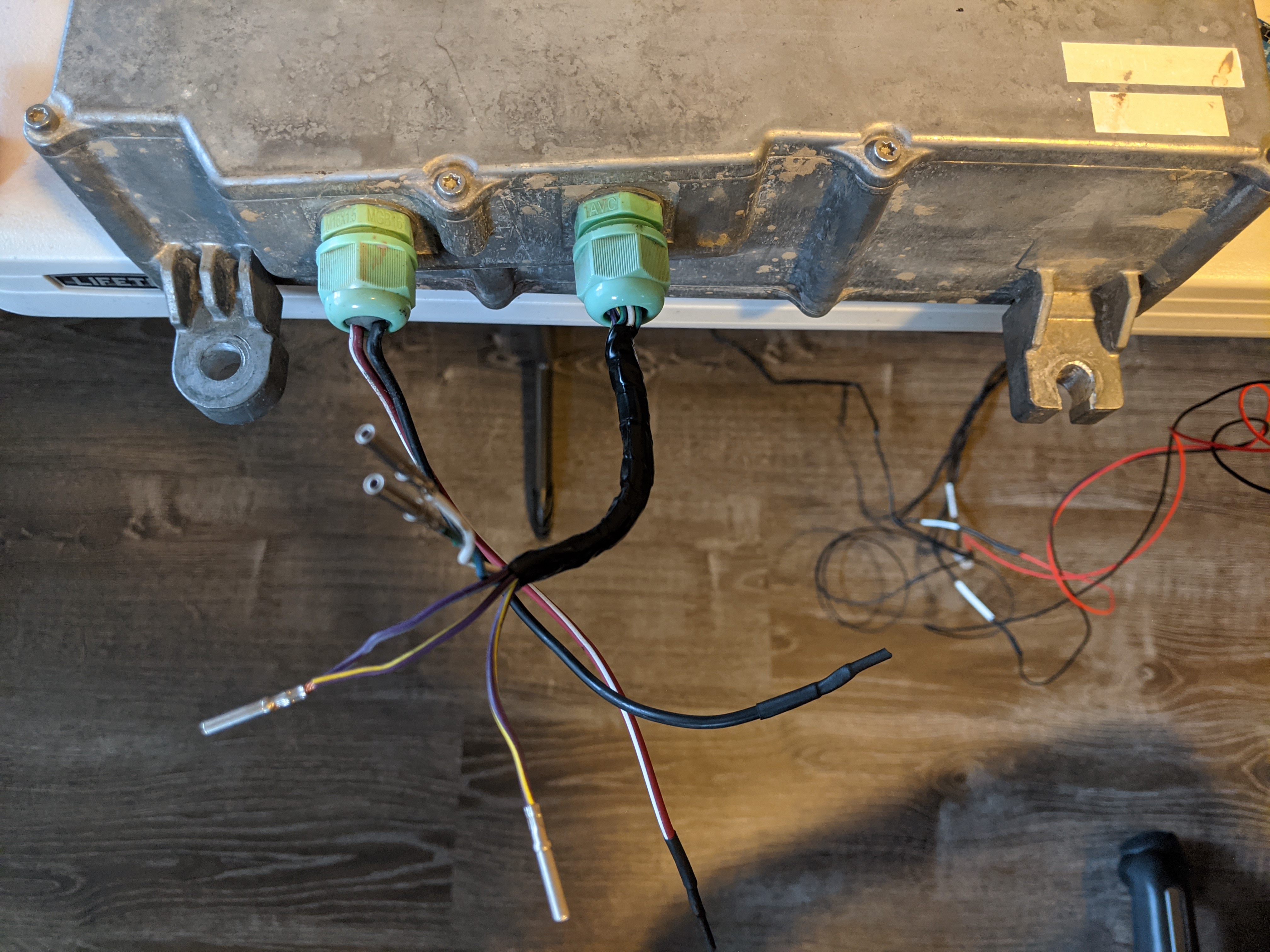

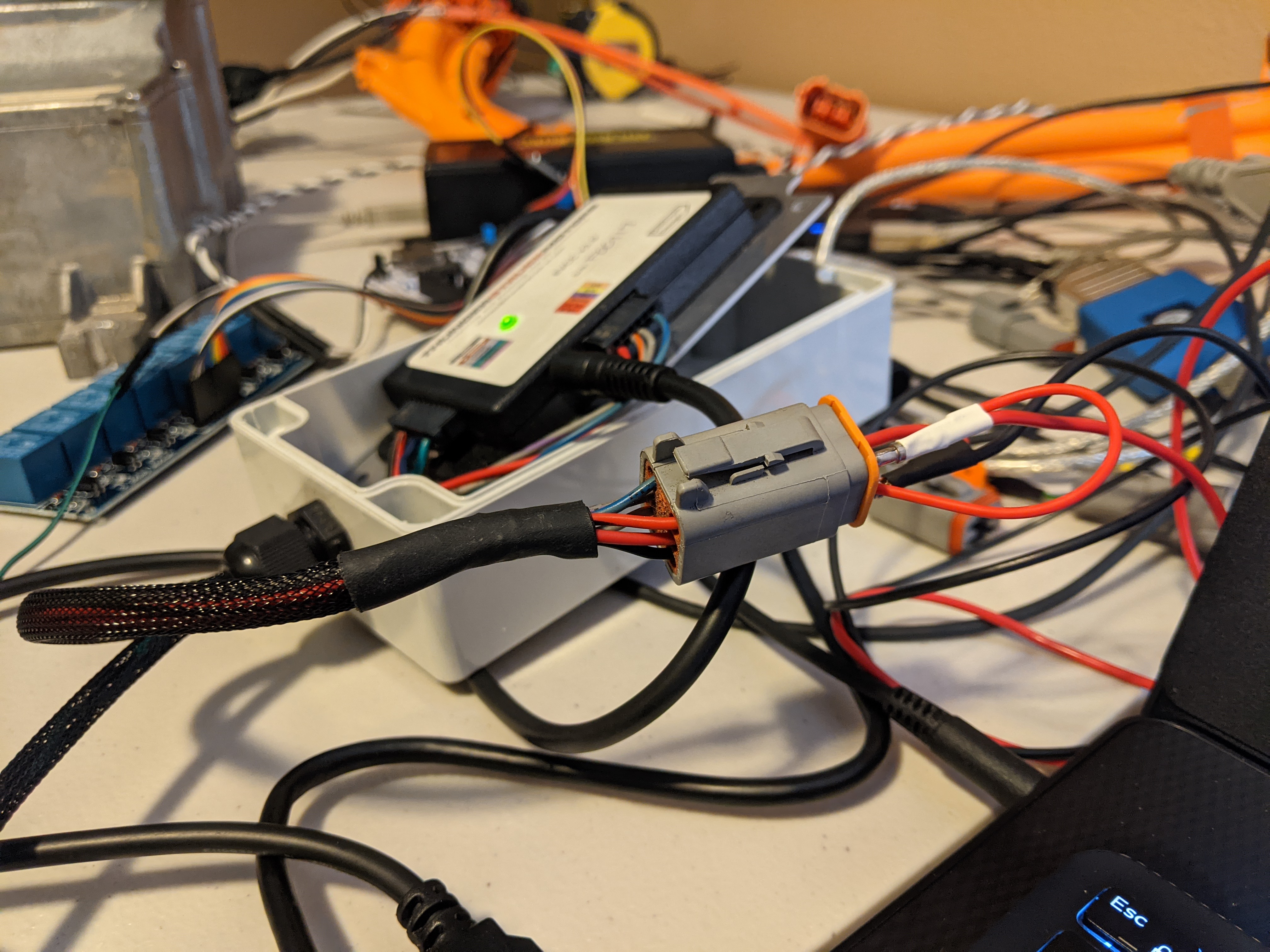

Well, I went to Home Depot, picked up two sockets, two bulbs, an extension cord for connecting AC, and wired up the DC output side. And I then I did something dumb.
The control side of the charger had 4 pins - 2 CAN, 12V and ground. I...de-pinned them before seeing which was which :D
I did find out later what CAN H/L were, but it seems the charger only comes alive with AC input? I lack wire nuts or something to crimp the wall voltage correctly, so that stopped that part for the night. Instead, I tried to get the right CAN message to send - I need to put in a PR for the SimpBMS Chevy code as Tom added the Coda stuff a little _too_ quickly and had some copy paste errors. :) Happens to the best of us though. So I tried to get the EVCC controller I have to spit out messages...which was fun. I did get it to do it, but I had +12V, ground, and some extras :D
You need to give it power, then tell it ignition is on, then tell it the EVSE proximity is grounded noting it's locked, _then_ it will start charging. Also fought with some weird settings to get the terminal program going.
