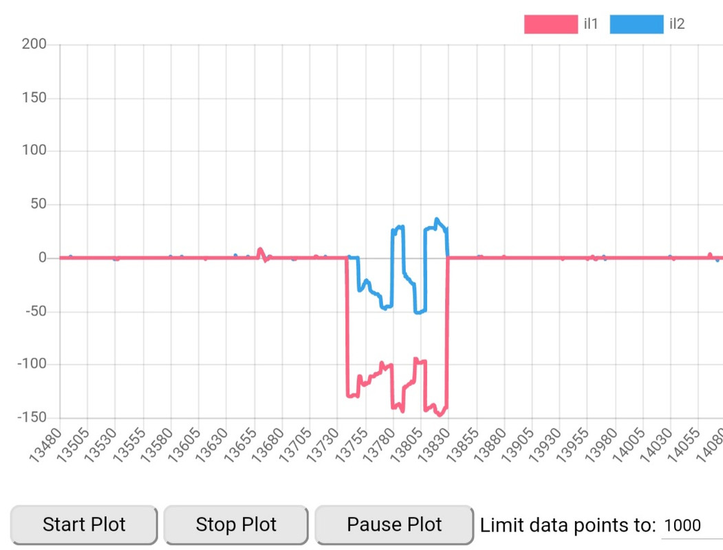

I want to give a bit of a warning to all FOC users on the road. I and others have repeatedly experienced over current shutdowns at high rpms (like above 6000 in the Leaf motor) when quickly transitioning from drive to regen.
As a result the inverter shuts off and cannot be restarted while still moving, because the FOC implementation cannot start into a running motor. Consequently you have to stop and restart the car.
Reason:
The PI regulator for d current has to transition very fast from negative to positive output when going into regen. Any lag in that will interrupt the field weakening process and allow excessive regen currents which then trip out the inverter.
Current fix:
When driving at high rpm come off the throttle slowly. If traffic doesn't allow for that, you're screwed
Planned fix:
I will introduce another ramp that comes in effect at high rpm that slowly brings on regen.
EDIT:
Actual fix: lower regenramp to 0.3
Just did a test drive and it is super smooth and has no problem transitioning between accleration and regen even at 7500 rpm :)

So back to the question, the FOC SW will not rev it down using the POT input, see plot. I need to set the direction to neutral to rev it down to 0.
Is this because I have no load? Too low voltage (80V)?

First I assume you've calibrated your potmin and potmax.
Second, spinning without throttle usually indicates an incorrect syncofs setting. Have you calibrated that yet?

That sounds like the result one might get if the syncof setting is incorrect, has that procedure been completed?

Thanks to both! Haven't calibrated anything, I do the POT adjustment with CAN communication. Potmin=0 Potmax=4095 Throtcur=1
No, I haven't gone through the procedure, as was leaning on this to be correct with syncofs=0: https://openinverter.org/wiki/Configura ... Leaf_Motor
If this is not correct and anyone has done the Nissan Leaf EM57 motor calibration, please share!
EDIT: You are definitely right, ran through the routine and came to syncofs of 16300, now starts at POT=1500 (of 4095), still straight up to 1400 RPM. All POT values below 1500 winds the motor down to 0, so progress at least! Thanks
