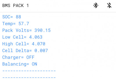

BogdanT
Posts: 9
Joined: Thu Dec 17, 2020 7:52 am
Location: Romania
Re: Simp BMS
Post by BogdanT »
No, neither debug or display will show if it's actually working.
Checking the code I noticed that balancing on Volt/Ampera was never enabled (bug) - I sent it to Tom and he reactivated the balancing commands 2 days ago.
Then, when I tested, it froze my BICMs. I checked the balance code and noticed that it doesn't send the data as per the spec. Further testing revealed some bugs in the voltage decode method.
I'm chatting to Tom but as he doesn't have a test rig I need to try and sort it out before I send the code to him to merge.
On my side it's balancing now, and I'm just waiting to see if the BICMs can discharge 'all' the cells, or if I need to trigger that for odd/even cells sequentially. Testing the balancing takes some time (12hours to discharge ~30mV)

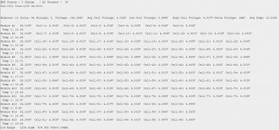

BogdanT
Posts: 9
Location: Romania
Re: Simp BMS
Post by BogdanT »
So far so good on my side. Balanced to 15mV now back to charging.
I do see some modules that report a constant temperature (17C)... Maybe the sensors are broken?

Boxster EV
Posts: 489
Location: UK
Has thanked: 57 times
Been thanked: 49 times
Re: Simp BMS
Post by Boxster EV »
BogdanT wrote: Thu Dec 17, 2020 7:18 pm So far so good on my side. Balanced to 15mV now back to charging.
Good work. Care to share the changes you’ve made to the code?
