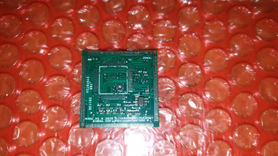

Here is a little teaser of whats on the way...

Right, no where were we.....oh yeah! Pushing the limits of pcb manufacture:)

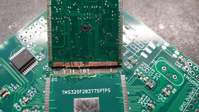

In other news began testing of the new modboard on a demo board with the 28377 footprint. Bad news first, its a little too small. I need to move out the pads about 1 to 1.5mm so the holes hit more of the "motherboard" pad surface. Good news : Once centered and drag soldered the joints are near perfect and rip the pads off when forced and don't bridge over. So we need some more refinement but the basic idea seems to be sound.
To do : increase spacing by about 1mm , increase pad drill to 0.25mm from 0.2mm to help solder flow, continue learning libopencm3 and codeblocks.
Other good news is I now have 2 SPI ports running on the STM32F103 along side the inverter firmware. Just spitting out test messages for now but will be using Colin's decodes soon once we have a board running in the inverter. Oh yeah, pro tip : The STM32 doesn't like you trying to use one DMA controller for two tasks. Who knew.....

I wonder if you could fit some spring contact to the GND pad so that JLCPCB can fit that STM32 for you.
Yes DMA architecture isn't the most flexible on the STM32. DMA channels 1, 2, 3 and 6 are used. Whereas 6 is only used for single channel encoders, if that helps.

Would it be an idea to use castellated holes all around ? Might give a better view at what the solder paste is doing. Or is the pin spacing to small ?

Castellation is not possible on a 0.5mm pitch pad.

Of course I had a guy on instagram today laughing at me and calling me a moron for ripping the pads off a model 3 drive unit:) Exact same pictures as posted above .....

Sure it is, but you'd need to sand the edges of the board down yourself.
JLC PCB and the like aren't going to do it, people would complain the edges aren't perfect.
Of course then you end up having to assemble the boards yourself, which would make the process suck even more.
Yes you could do it, but it's stupid and not worth the headache.
