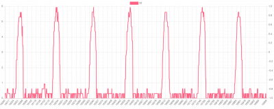

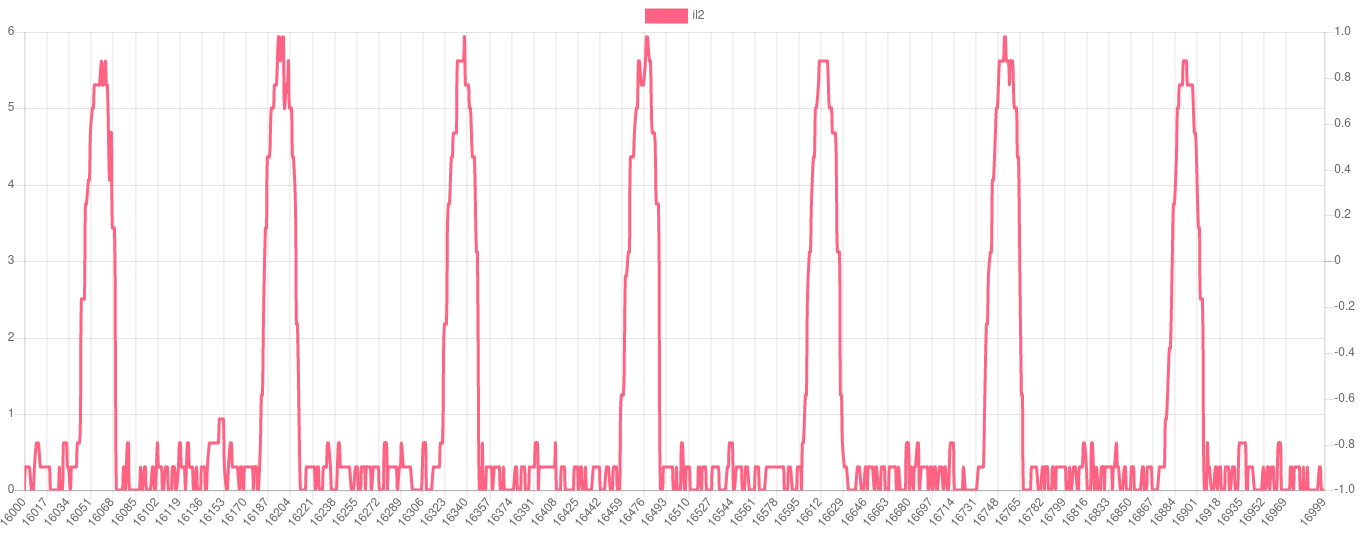

Also did some 230V experiments of my own.
Hooked up 230V to two phases of MG1 with a precharge resistor (always on) and a relay. Relay controlled by the DCSW signal. The DCSW signal also controls the enable signal of the converter. Basically it will first enable the charging PWM at chargepwmin and then close the relay and enable the converter. Thus no unwanted short circuit or boosting.
I found last time I had the controller gains too high, thats what caused the fuse trips. Have chargekp=40 and chargeki=10 now. Also there might have been a glitch in software where PWM was shortly disabled when closing the contactor.
Those things are now fixed. Mind you, the power factor is probably not great, most of the sine wave remains unused as is usual with buck chargers. But it charges :)
Video coming soon!
EDIT: I'm wondering if for some reason the plot only shows the positive wave... Current passes through sensors BEFORE rectification so should swing both ways. Hmm.
