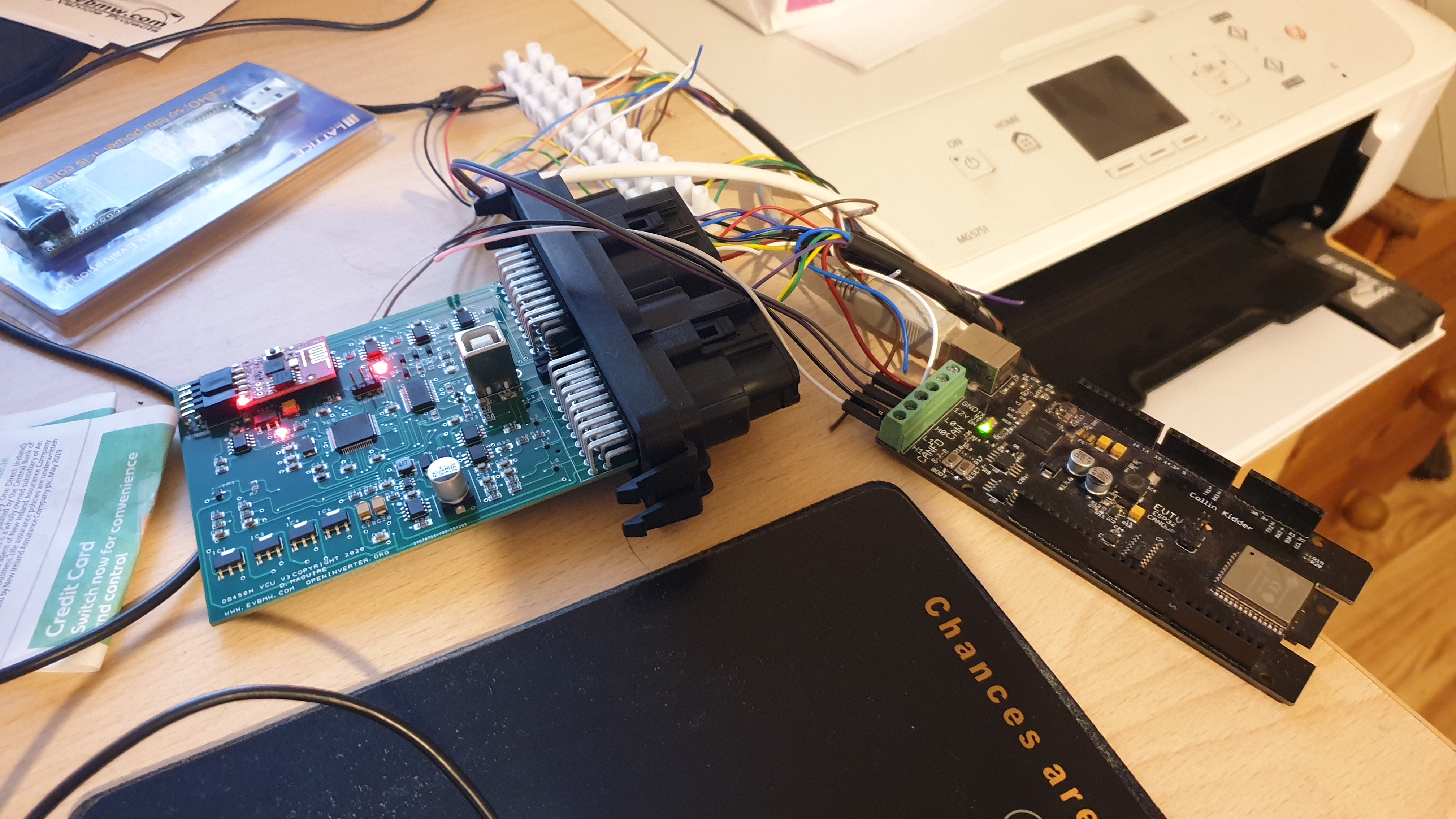

So over the past few days I've been mashing together a project from these and other code and learning fun stuff like : Whats a static and when (not) to use it:) , How to hard crash an STM32 and other fun things. But yeah this is addictive. I'm loving the edit in a text editor and compile from the command line approach.
So what we have as of now is the openinverter wrapper with things like :
Throttle cal and mapping,
Precharge and contactor control,
Temp derating,
BMS limits,
for/rev/neutral control,
Graphing and monitoring,
Firmware updates via the web interface,
Cruise control,
Fuel gauge driver,
etc , etc
BUT, rather then driving an inverter powerstage this version sends CAN for the Leaf inverter or Sync serial for the GS450H and of course can be expanded to any number of others. This will be the default firmware for all vcu products from now on and future hardware will support future fun packed stuff like FLEXRAY!!!
As of now its a bench queen but its pumping out can that may or may not spin a leaf motor and talking to an isa shunt. Hardware should arrive next week and Dilbert is working away on the GS450H part. So that's all for now......where was i....oh yeah

Ok so we are up and running on a 105:) Just using a spare bms master board as still waiting on the vcu hardware. Due tomorrow now according to good old DHL.... Now on to porting Dilbert's GS450H code over to libopencm3.
Pro tip : writing or reading IO pins you haven't defined really annoys the STM32. It just sits there and mocks me like Nelson from the Simpsons....

Good news : boards arrived. Better news : they power up and program:)
Full kit on the way to Dilbert today to assist with the GS450H module development.

This was a Tour De Force :
gpio_primary_remap(AFIO_MAPR_SWJ_CFG_JTAG_OFF_SW_ON,AFIO_MAPR_USART3_REMAP_PARTIAL_REMAP);//remap usart 3 to PC10 and PC11 for VCU HW
Moron here had decided when designing the hardware that it would be a good idea to have the option of using Uart4 for the wifi. As the Uart4 pins are capabale of hosting Usart3 it was win win.........Yeah right. All day yesterday I struggled with trying to remap USART3 onto PC10 and PC11. OF course I made the usual mistakes like not enabling the AFIO clock etc but would they work? HELL NO. Got up this morning and decided to do it in assembler. And it worked! So not a hardware issue but libopencm3 just kept laughing at my attempts.
What am I doing wrong? I had been using AFIO_MAPR_USART3_REMAP_FULL_REMAP because that makes sense right? We want to remap the pins.... I'm sitting back in my office chair looking at my good old Commodore 64 which I still get a kick out of using connected by RS232 to my pc as a terminal. Ah the good old days, just rx,tx,cts,rts,dsr,ri.dtr..........wait........oh you are F%^King kidding me!!! change to AFIO_MAPR_USART3_REMAP_PARTIAL_REMAP and everything starts working. Because of course a FULL REMAP moves ALL the USART pins!
So yay. Bootloader and firmware now running on the V3 vcu.
