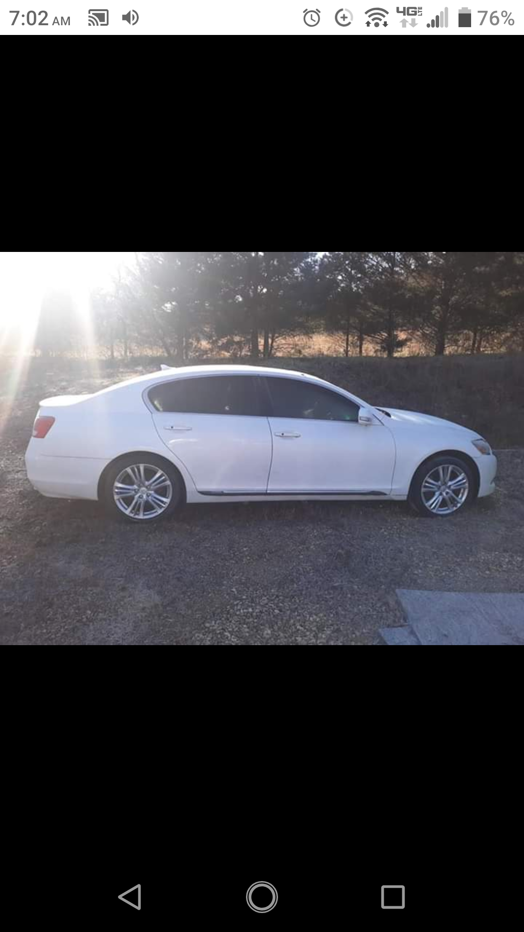

Here's what I hope it's the beginning of a fairly quick conversion of my recently purchased 08 Lexus GS450H with a dead hybrid battery for $1500. I'll get it home today and start pulling the engine immediately. I have ordered the VCU so that will be my first part in waiting on, I already have a 13 Chevy Volt battery from a previous project (Nissan Leaf powered grasshopper mower) that I'll use initially until I get the funds together to purchase around 40 kWh of batteries to fit in this car. The plan is majority of the batteries to go in the front with a few mounted in the place of the hybrid battery.
