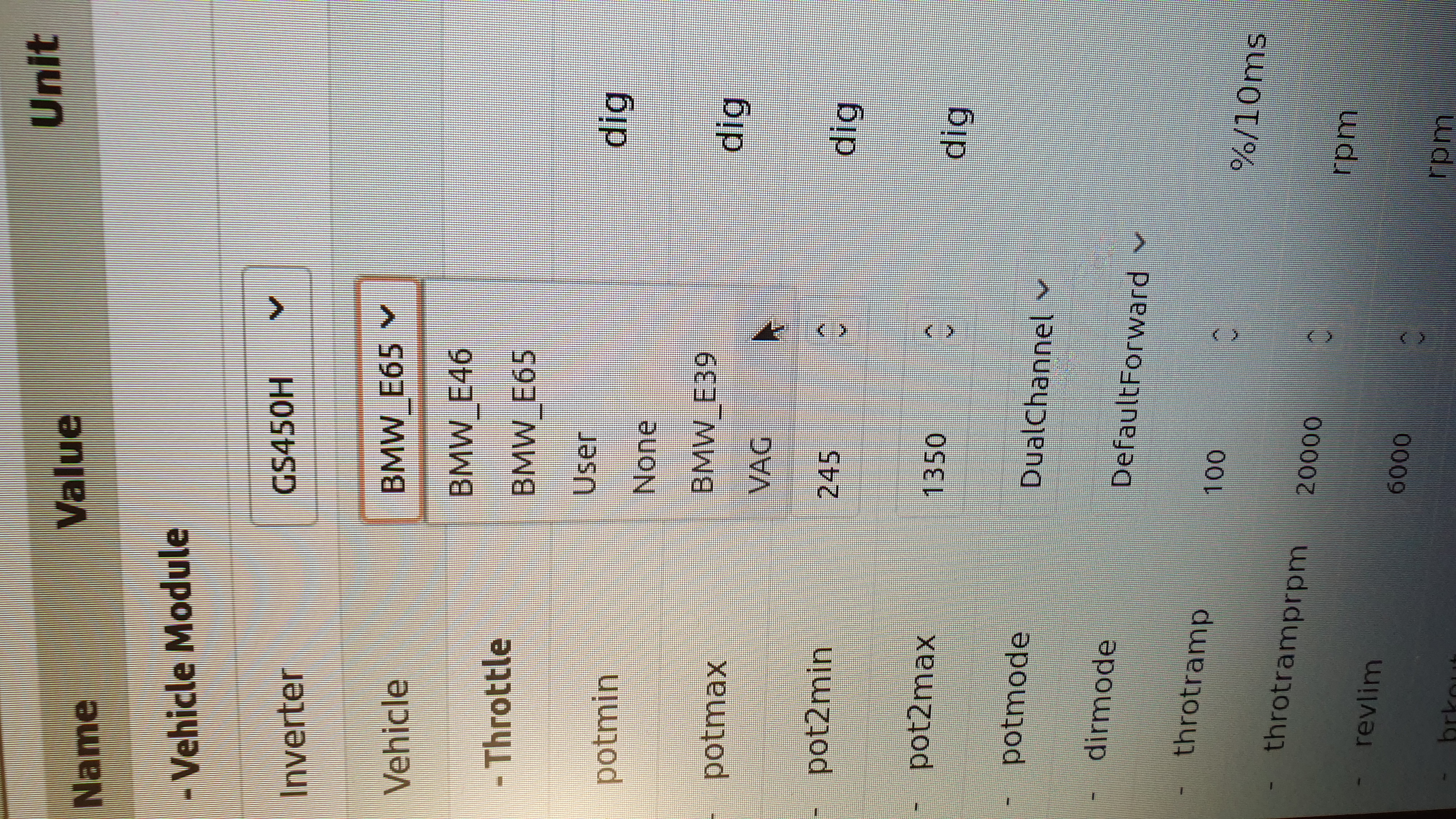

Thanks Johannes. I have added a VAG module as a way of saying thanks:)
OK, i can select GS450H now and i'm seeing HTM / REQ & CLK being generated. All 3 signals look good.

I won't be using the pre-charge, i'll just have a 24V PSU connecting to the inverter, is there any way to disable this? do i just set a low value for the pre-charge voltage?
I've calibrated my BMW pedal, but i'm not seeing the "potnom" parameter move, even when i give it a direction input. So i need to look at that, I think i haven't given the ECU the "start" input.

Ok great. Just set udcsw to 0 to bypass precharge. It won't command torque unless in "run" mode. Easy way to enter run is just select bmw e46 vehicle and give a 12v pulse to the In1 pin then set direction to default forward and torque should increase linearly with throttle. All going well I'll test in the E65 tomorrow also.
OK that's a good tip.
So in E46 mode, IN1 will bring it into run mode. Which pins are mapped for the direction inputs on the E46?

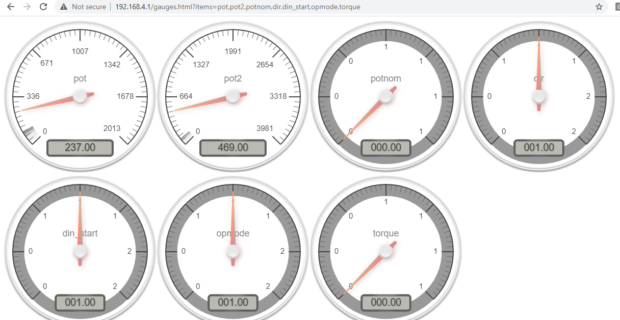

OK that brings the "din_start" to 1 and "dir" to 1.
I don't seem to be getting anything on "potnom" when i push the accelerator, have i the name of that parameter correct?

Ok should say "run" under opmode but 1=run. Should show potnom and torque now.
See attached the guages and param export.Jack Bauer wrote: ↑Sun Jan 03, 2021 5:06 pm Ok should say "run" under opmode but 1=run. Should show potnom and torque now.

Ah yes you need to set udcmin to 0 also. Sorry forgot that one. Also you only need to pulse in1 high start is a momentary signal.
