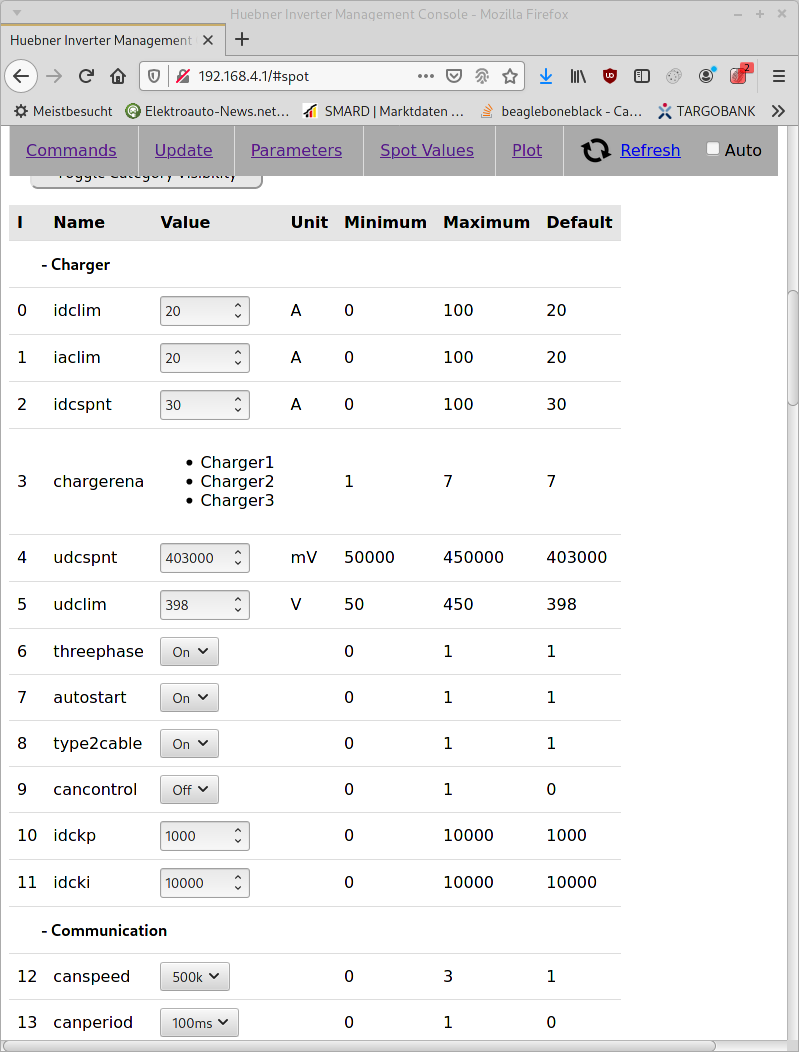

I have developed an openinverter-style firmware for the Gen2 Tesla charger, more specifically the boards with STM32 processor like V5aB2.
UPDATE:
Manual in the wiki: https://openinverter.org/wiki/GEN2
Download link: https://openinverter.org/files/stm32_charger.zip
Shop link: https://openinverter.org/shop/index.php ... duct_id=67
UPDATE2:
the firmware will be published as open source soon. If you want to grab it earlier jump on to patreon: https://www.patreon.com/openinverter
I have annoyed Damien by sending him outside in the freezing cold to test it in his BMW :P It works.
More specifically it features
  • All features of the original firmware
  • openinverter parameter handling via web interface
  • openinverter spot value handling via web interface
  • Over The Air update via bin file
  • Plotting and logging
  • DC current set point
  • external CAN control
External CAN control requires routing to internal CAN bus onto the external header as shown on the picture. It has quite a few IDs on it so check for collisions with your existing CAN infrastructure before doing this.
I have mapped out CHAdeMO so it will accept like this
#0x102 - 8 - 0 udclimh udcliml idcspnt 0 canenable soc 0
Sending SoC will allow implementing a SoC limit in the charger and might be handy for just displaying it.
It will also generate the 108 and 109 message CHAdeMO style.
