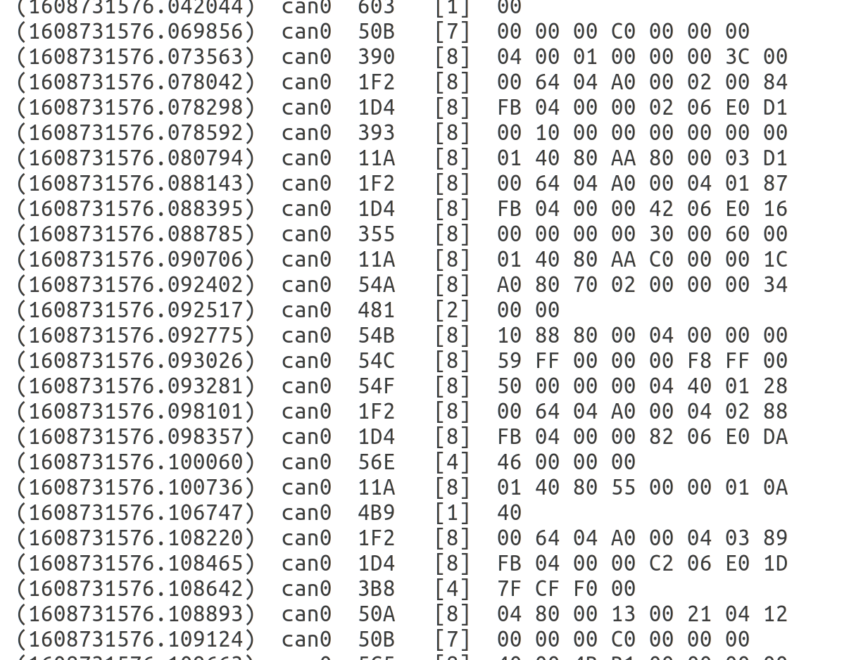

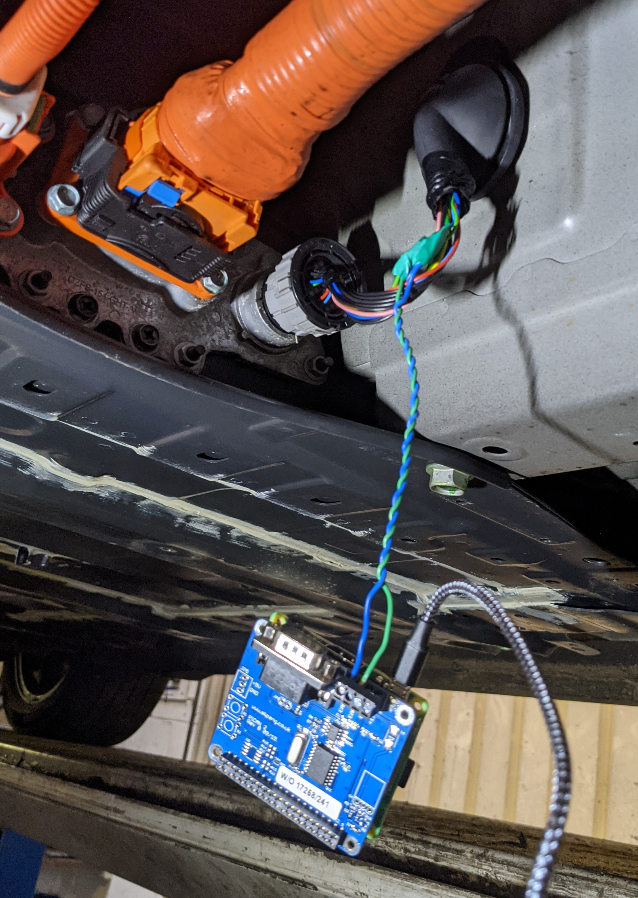

attached a CAN dump of a 2018 40kWh Leaf Gen 3. Taken at battery box.
Might be useful for someone. Looks largely identical to the smaller packs according to Johu.
My understanding is that the LBC/BMS sends messages faster than the previous ones.
