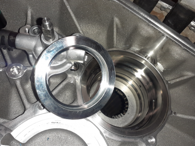

At first test i heard a light "vining" noise, Probably some bad bearing i suppose, time to tear apart.
All gears look fine, the bearing at rotor was fine but at first axle the bearings was very bad,
They have tried to use standard steel bearing, not a very great result unfortunately, eaten by currents.
The new bearings will be hybrid, aka ceramic balls.
The rest of the bearings in gearbox is fine but it is simple to replace so i change them all.
Problem was to find internal seals, after 1 month of research i luckily found it at an Chinese Tesla supplier
This is the new controller that should make my life easier, Maxecu Sport, Canbus ready.

That will be a big challenge, especially accommodating the model 3 battery will not be easy.
I solved the problem with the seal with an adapter ring to use a standard shaft seal.
What does the surface for the teflon ring on your motor look like? I think you bought the sealing ring for the coolant from the same Chinese. Do you have any plans to use a sleeve?

The coolant pipe to the rotor Will have The same sealing as original(just hope it Will fit). Small sign of leak som very satisfied that i made a full teardown
The new hybrid Bearing to the first axle is sealed, and inside there against the motor there is very special sealing, the mesures is no where standard... My idea is to fabricate än adapter ring like you Did so i can use some standard piece of the shelf :D
Inside the first Bearing there is an oilflow, i need to plug that line because my new Bearing wont need any external lubrication, i have seen that some have remove the sealing just to let the oilflow cool the Bearing, skf Did not recomend that, dirt Will find its way in there.
Have you find any new carbon ring to minimize the risk of induction current, i have removed the old one intact and cleaned it from all the oil, old sealing was doomed...

For the cooling water I will use a sleeve from SKF to repair the shaft. There could be a solution here https://www.maier-onlineshop.de/produkt ... ungsringe/ for grounding the rotor.

muehlpower wrote: Tue Nov 17, 2020 10:46 am For the cooling water I will use a sleeve from SKF to repair the shaft. There could be a solution here https://www.maier-onlineshop.de/produkt ... ungsringe/ for grounding the rotor.
Thats i nice solution from SKF, but i wont bee needing that for now,
I think i have cleaned the original grounding ring to its former glory, and besides that i now have the 1st driveaxle and rotor fitted with ceramic ballbearings :)
