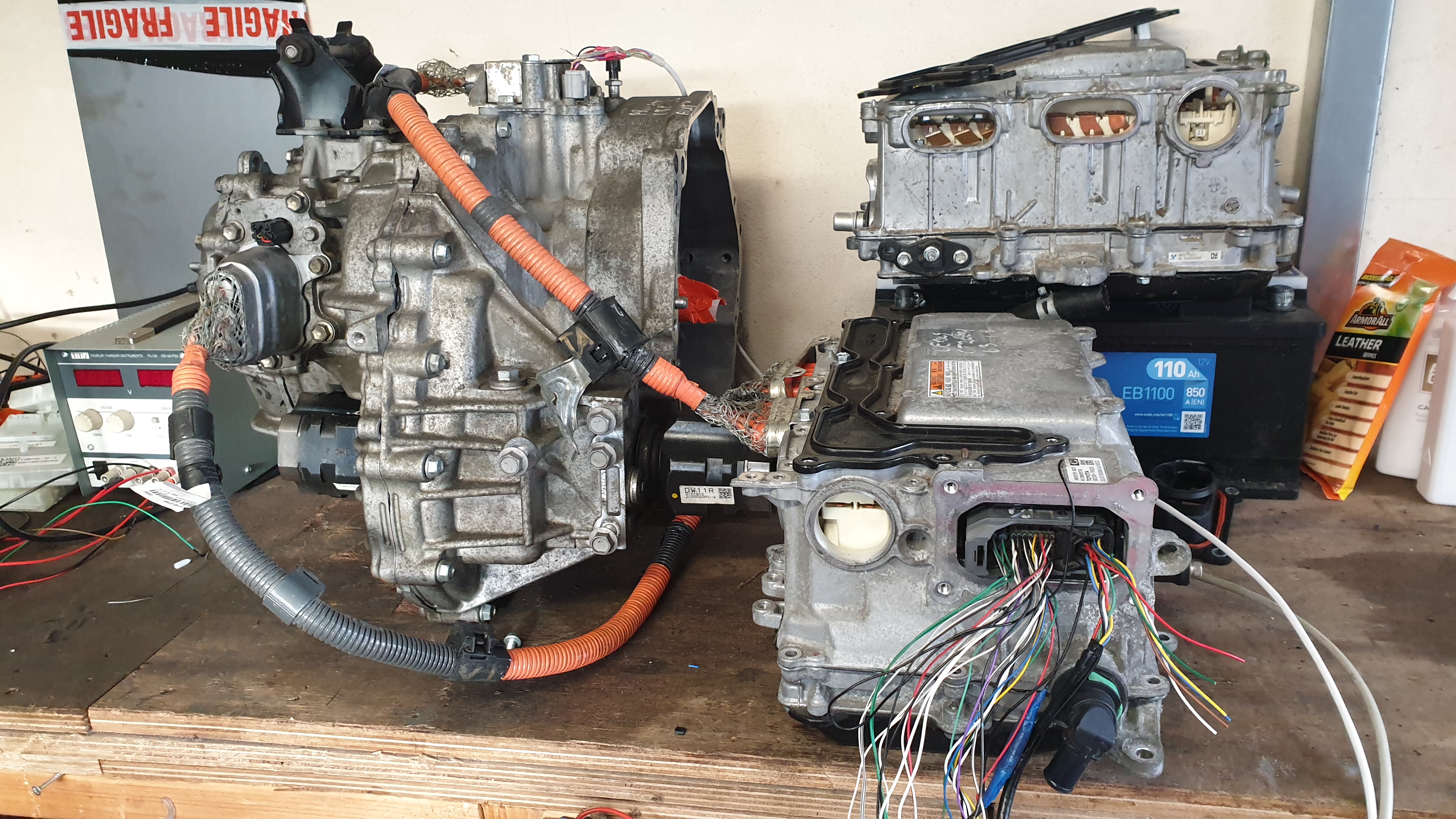

Thanks Matt I think we're back in business:) Got a little time today to start wiring up a test bench for gen3 prius inverter and transaxle. Going to see if we can make the gen3 system work like the gs450h for front wheel drive projects. And by we I mean Dilbert will do the hard work and then I'll take the credit and retire to Lanzarote a year earlier than planned:)
Posts: 3668
Has thanked: 12 times
Been thanked: 356 times
Here is my attempt at a pinout. If anyone has any more info please add onto it.
OEM_PIN_CONNECTIONS.odt
(107.02 KiB) Downloaded 454 times

FWD Plug and Play: Gen3 transaxle + Inv
RWD Plug and Play: GS450 box + Inv
Anything else: Prius Gen 3 + Replacement PCB
Posts: 3668
That's it exactly:)
