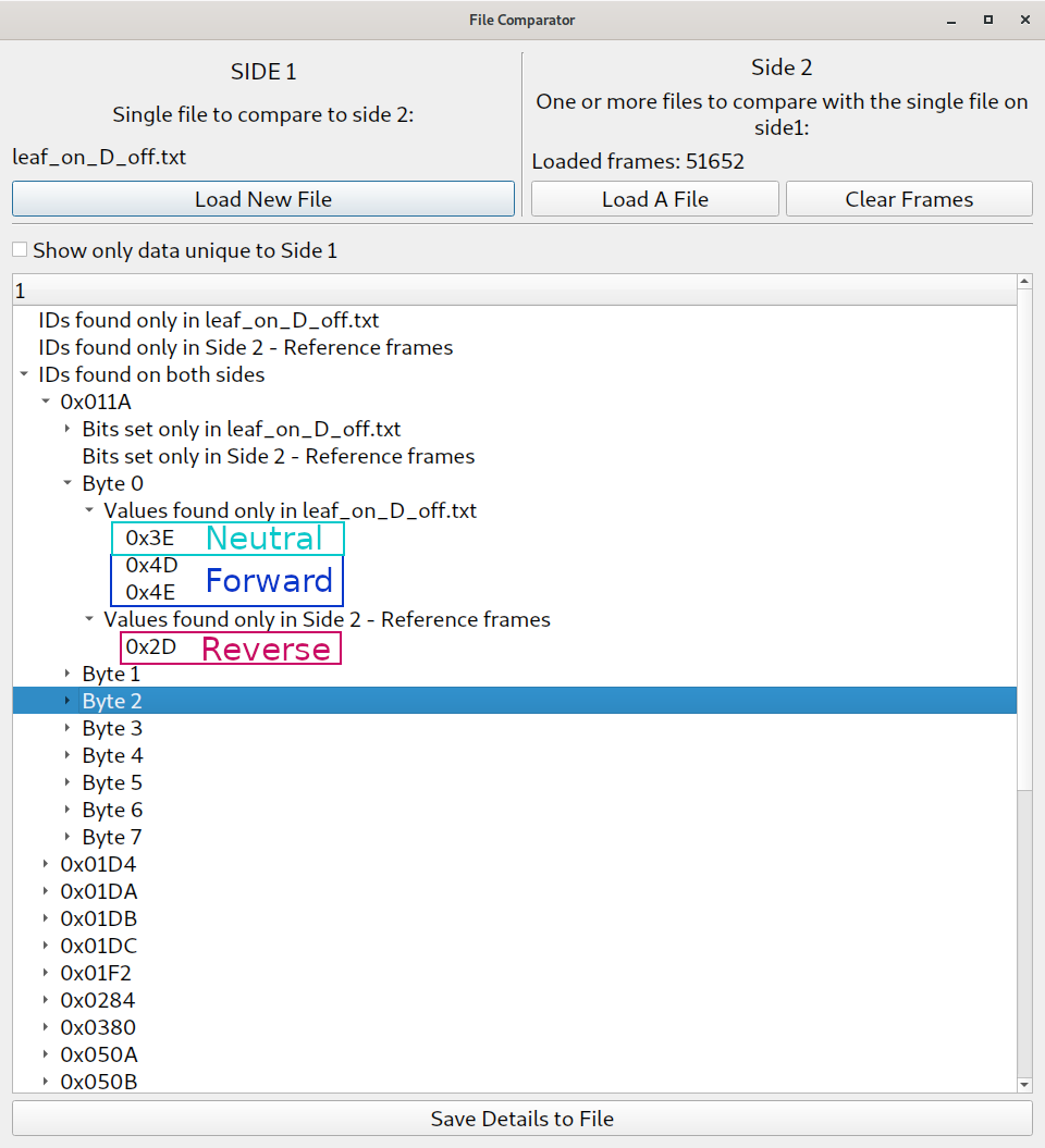

Re: Leaf Gen 1 Inverter Board
Try sending these values on the first byte in message 0x11A to the inverter. The data is from your CAN-logs.
Robin Guldmyr
So good news is we can now command positive and negative torque and regen the motor in both directions.
- Posts: 4000
- Been thanked: 1117 times
0x1d4 byte 6 needs to be 0x30 before the inverter will accept a positive torque command. Updated the software on github for running on the open source vcu. All I need to do now is get it to read the throttle pedal and send torque commands that way.
