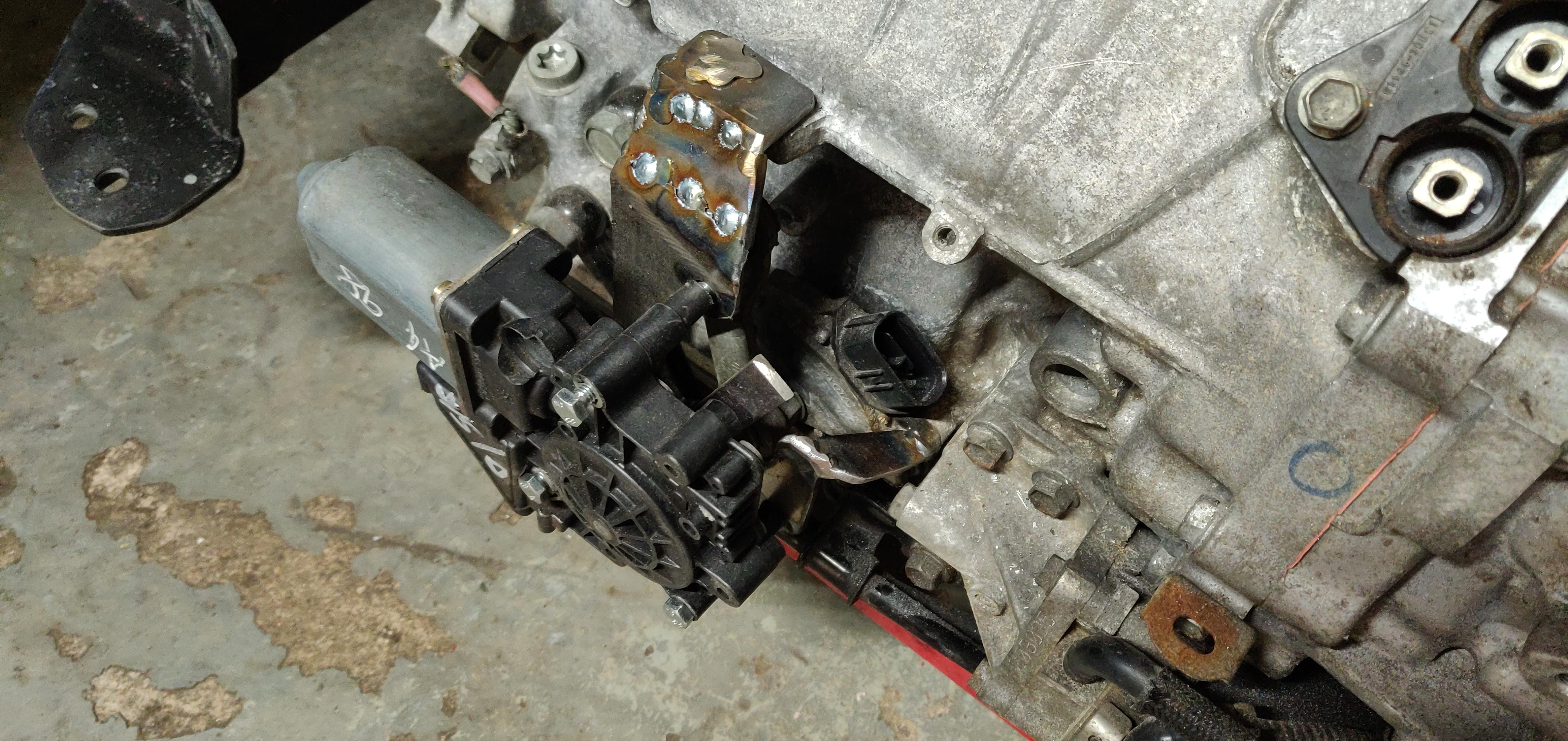

Yep, the GS has a solenoid as part of the shifter assembly. For a bare transmission, you don't get that.
Since I used a motor to move in/out of park, I do the lockout in software (I take the two brake pedal sensors as inputs).
I'm not sure how you'd implement a lockout solenoid, to be honest, it might be best to find a suitable shifter assembly from an existing car (maybe a Ford or GM or something common/cheap to play around with).

What sort of motor do you use to move in and out of park, trying to find one now (maybe you could send me the one you use)xp677 wrote: ↑Tue Jan 05, 2021 10:38 pm Yep, the GS has a solenoid as part of the shifter assembly. For a bare transmission, you don't get that.
