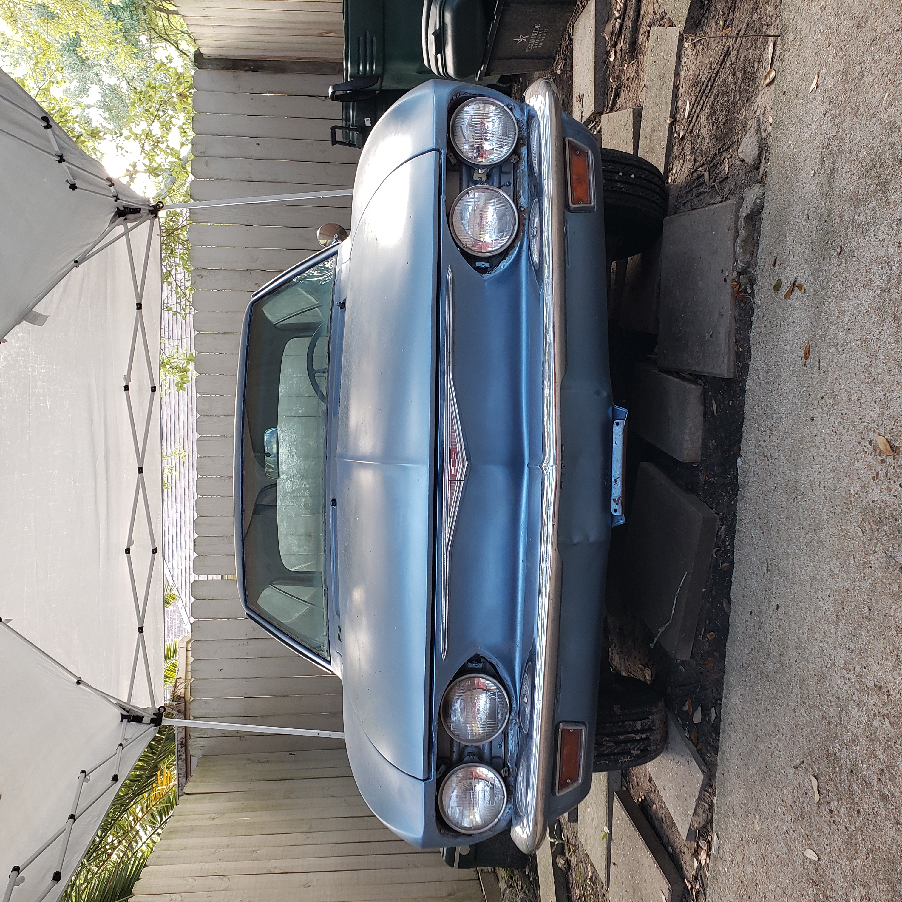

Hello everyone,
I'm still pretty new here (bare with me) and working on my first EV build using a 1965 Corvair Monza as a donor:
Originally, I was going to attempt a conversion similar to that of the Electrovair 3 done by High Voltage Hotrods:
https://www.youtube.com/embed/84xgjU1V0Ws
They accomplished this by mating the motor via adapter plate to the bell housing 86'ing the engine as seen in the following:
This would limit me to stock performance at 110hp, about 80kWh on a good day. The Powerglide transmission for this year is pretty solid from what I've gathered in Corvair forums and can take some tactical abuse. BUT even if I were to modify the governor, trick the vacuum modulator, and pray the hollow input shaft holds, I still would not be able to find out what a motor can handle.

Next step is to remove all the ICE systems and check the integrity of the frame while my bench test parts come in.
Note: If I misinformed anything in my ramblings, please call me out as I am novice at best and still striving to better understand this stuff!

That's a good lookin' 60 year old car! I am so excited for this project; I've loved the Corvair since seeing a V8 mid-engine conversion at the local car show. Do you have any suspension upgrades planned for after the drive swap? Also, what batteries are you thinking about?

Thanks Fire! The frame seems to be straight by the way the doors, trunk, and "frunk" close, but I won't know until I remove the ICE systems and get further into it. The driver rear is lower than the rest of the car so that shock must be bad, but I'm going to upgrade the set anyway, possibly doubling up with new coils as well. I haven't done too much homework on upgrades because it's hard to tell what I'll need until I've got the final weight of the battery pack squared away. Let it drag, am I right? jk
I've been on the hunt to find a couple 2016-17 Nissan leaf packs, but I haven't had any luck.
