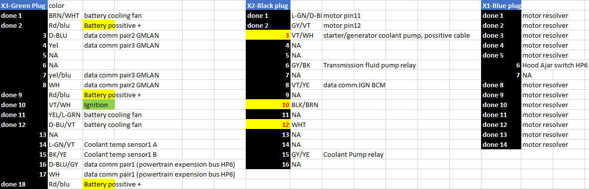

Post by winreboot »
Hi all, do you guys have any update on this? I managed to get my hands on shop manual and below are the pinouts from the battery back. Ignore my notes on it, but it looks like it needs canbus from BCM and canbus expension bus from engine ECU. If anyone have any more info please let me know
