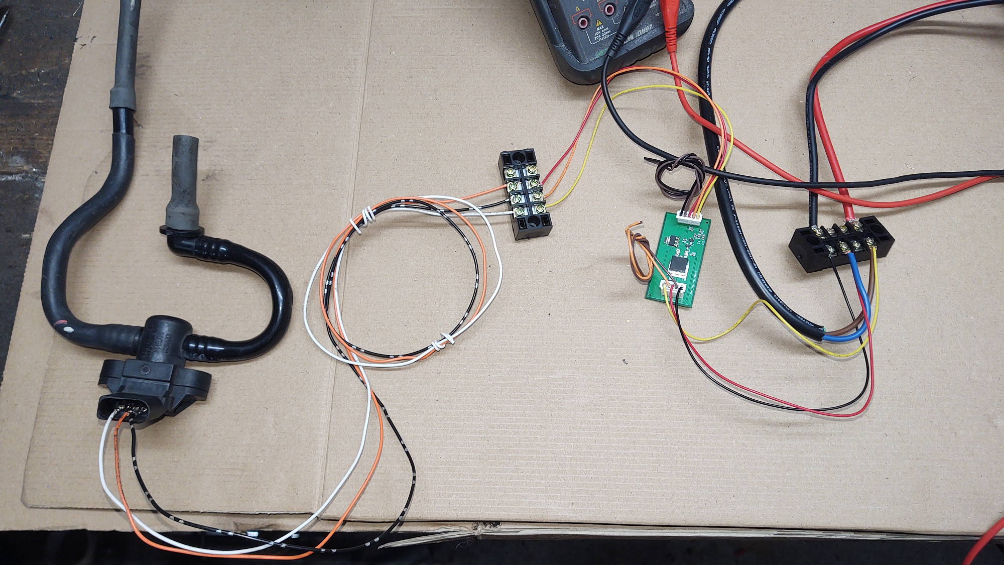

While I'm waiting for the coupler to arrive I'm doing other things that will need done anyway.
I bought a Zafira power steering pump but I think it's faulty as it spools up to full power but won't fall back to normal power.
So as the Zafira pump seems to be faulty I decided to see if I can drive the Freelander PS pump with an alternator adapted to run as a motor.
Also I've just tested the circuit board sent by Johu with the Audi sensor and pump and all working perfectly so far. :)
Thanks Johu :)

Great work! I would be wary of running the power steering that way. My smith Edison van does it that way albeit with a larger motor and it is very inefficient from a power and space perspective. Just a thought would the leaf rack be usable? . Have you a plan for the leaf shell?

paaa wrote: Fri Jan 22, 2021 12:33 pm Great work! I would be wary of running the power steering that way. My smith Edison van does it that way albeit with a larger motor and it is very inefficient from a power and space perspective. Just a thought would the leaf rack be usable? . Have you a plan for the leaf shell?
This car is just a test mule so if it turns out to be a bad option I will rethink it. The Zafira power steering pump draws 25A continously and more when you turn the wheels so it's not particularly efficient . I still have the Leaf power steering so if any one comes up with a way to use it I'll give it a try.
The shell was sold to a scrap yard.
