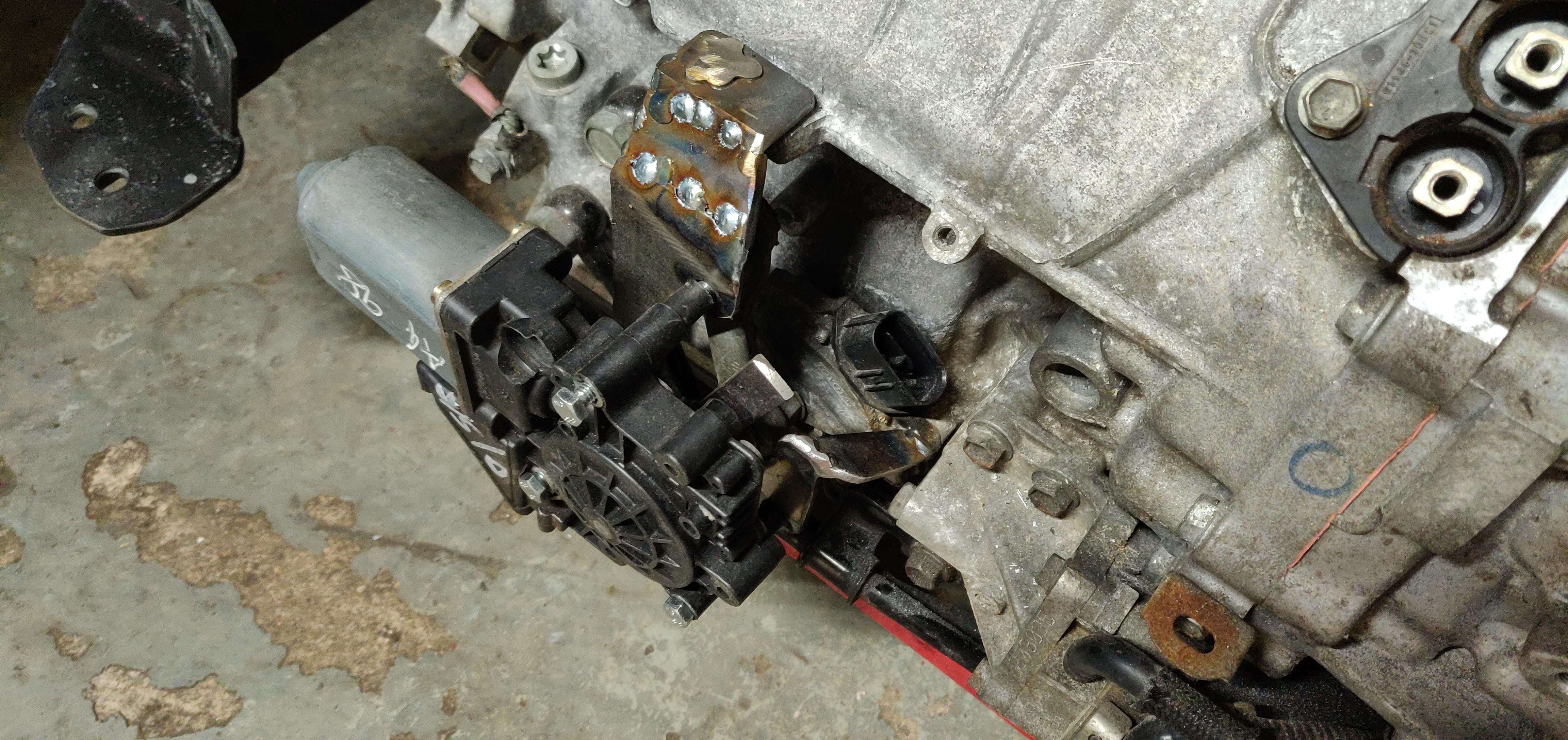

What sort of motor do you use to move in and out of park, trying to find one now (maybe you could send me the one you use)
I used a window motor from a 1998 Audi A4 (looks like offside/ right hand side). I made sure to get one with some wiring attached.
These motors have a control PCB inside with two relays and some various components, I stripped the components out and wired the relay coils to two of the pins on the connector. This gave me CW / CCW control without having to add my own relays or driver.
I bonded a steel crank onto the output shaft with some epoxy, and made up a linkage to connect it to the transmission.
I chose the window motor because they are cheap and powerful enough. I couldn't find a suitable solenoid. The motor cost something like £5 from eBay.
Video here: https://imgur.com/9qusPSo
Here's the code I used. This is not compatible with the VCU, but it works fine for my application. You can maybe use it to get started? Sorry, I don't have time to talk you through it.

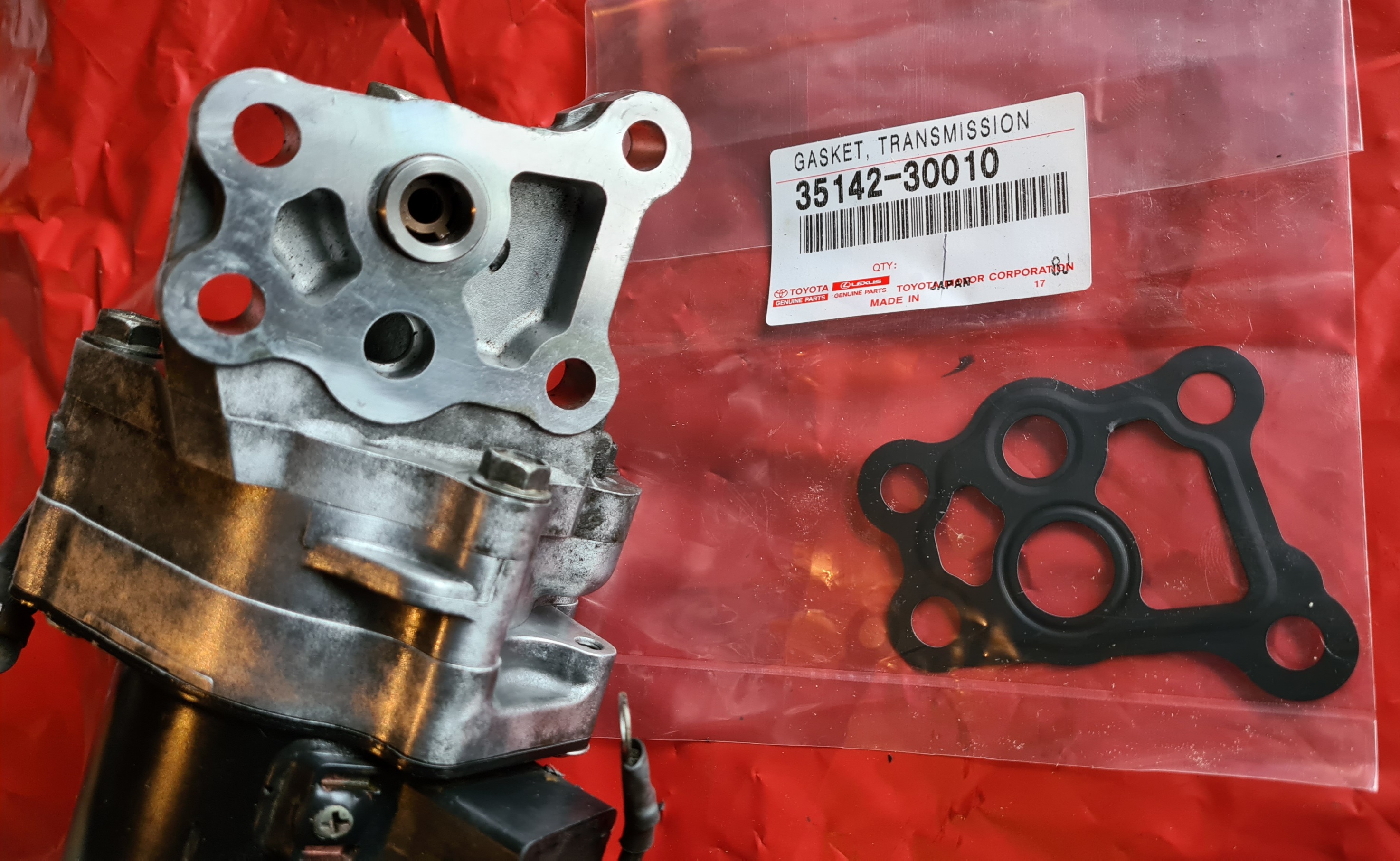

ggeter wrote: Thu Jan 21, 2021 10:35 pm GS450h transmission oil pump bolts and gasket...
Bolts (4) 90080-10197 $2.76 ea
Gasket (1) 35142-30010 $14
Has anyone got any suggestions for where to source these oil pump bolts, ideally in the UK (found a US website asking for $50 to post them here!)
Possibly there's an obvious solution I'm missing, like just ordering bolts of similar dimensions/specs?
Btw the gasket you mentioned is a rubbery plastic thing, i ordered mine from an official Lexus parts placed here in the UK...

slanceley wrote: Sat Jan 30, 2021 2:56 pm
Btw the gasket you mentioned is a rubbery plastic thing, i ordered mine from an official Lexus parts placed here in the UK...20210130_130718.jpg
Rubbery plastic? Mine is very stiff. Odd.
Just looked at my gasket again, and definitely metal. Like anodized aluminum is how it feels. Surface is black, but edges are shiny.
The bolts have an '11' on the hex head. Head flat to flat measures 11.8 mm. Bolt length top of head to end is 36.8 mm. Thread part only length is 30 mm. Thread peak to peak width appears to be 1 mm but don't trust my eyes on that. I count 8 threads per 10 mm. There are 9 peaks per 10 mm. I count 16 threads, 17 peaks in 20 mm
Someone out there who knows their fasteners knows what this is...
Edit: yes, I forgot to measure the diameter.... will do that once I get back to the garage.
Edit2: Got it... diameter 7.8 mm across top of threads

Bolts are probably just regular M8, 1.25mm pitch, 35mm long.

xp677 wrote: Sun Jan 31, 2021 12:55 am Bolts are probably just regular M8, 1.25mm pitch, 35mm long.
Makes sense to me. 1.25 x 16 = 20 so that works out.

That's a cool idea to use a window motor to shift. But I would be concerned about moisture and grime fouling the mechanism. what is the IP rating of the window motor?

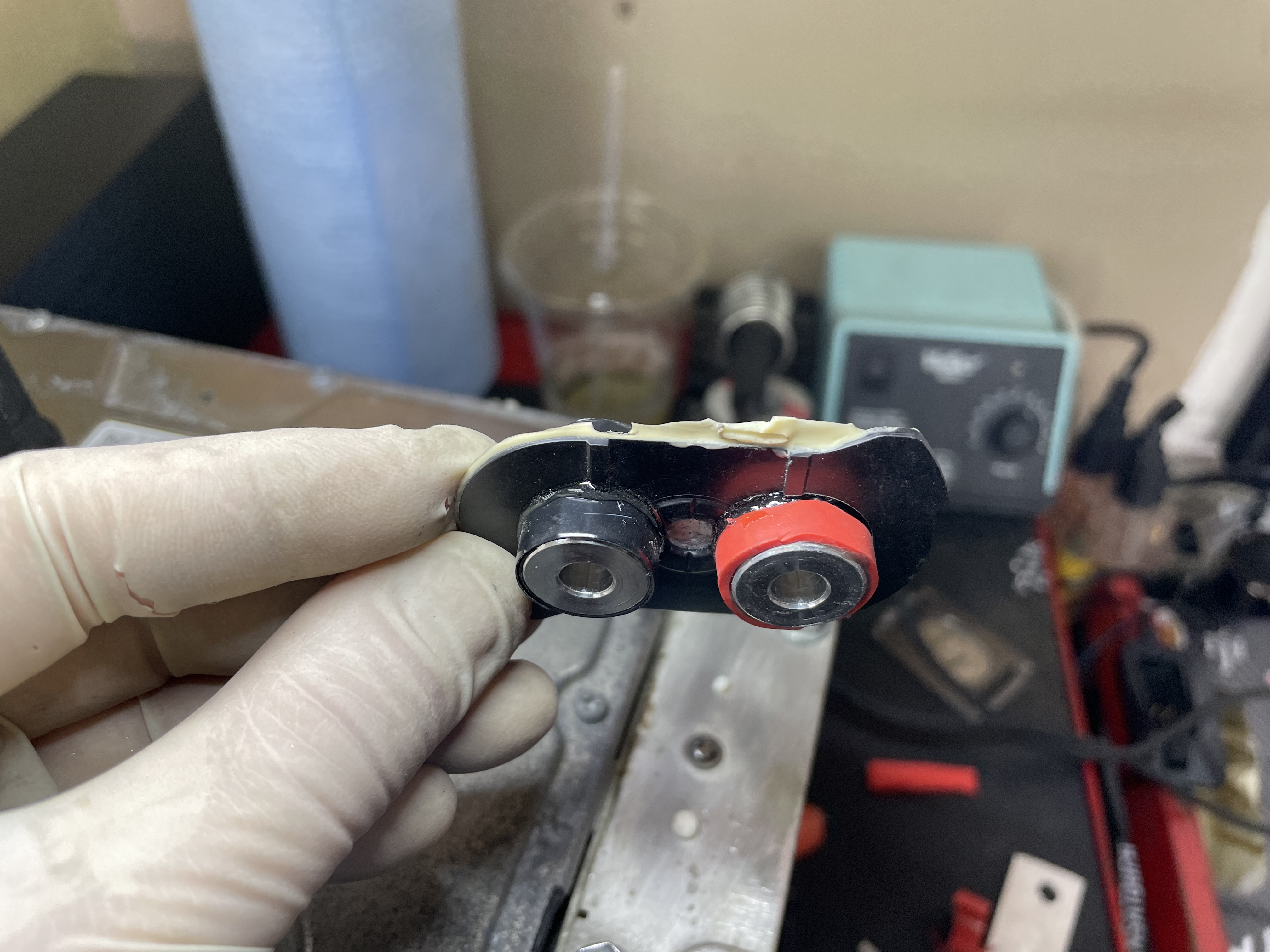

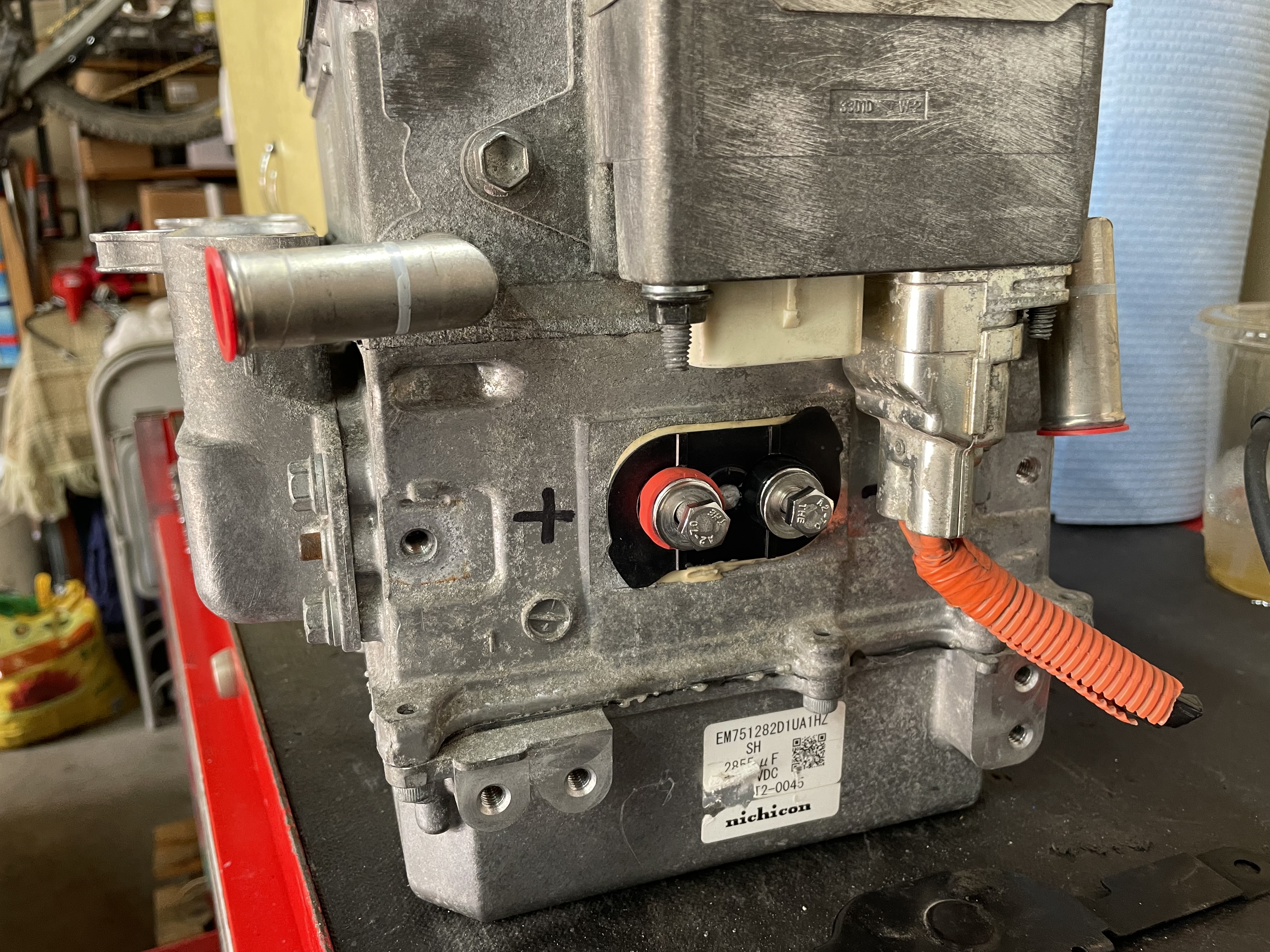

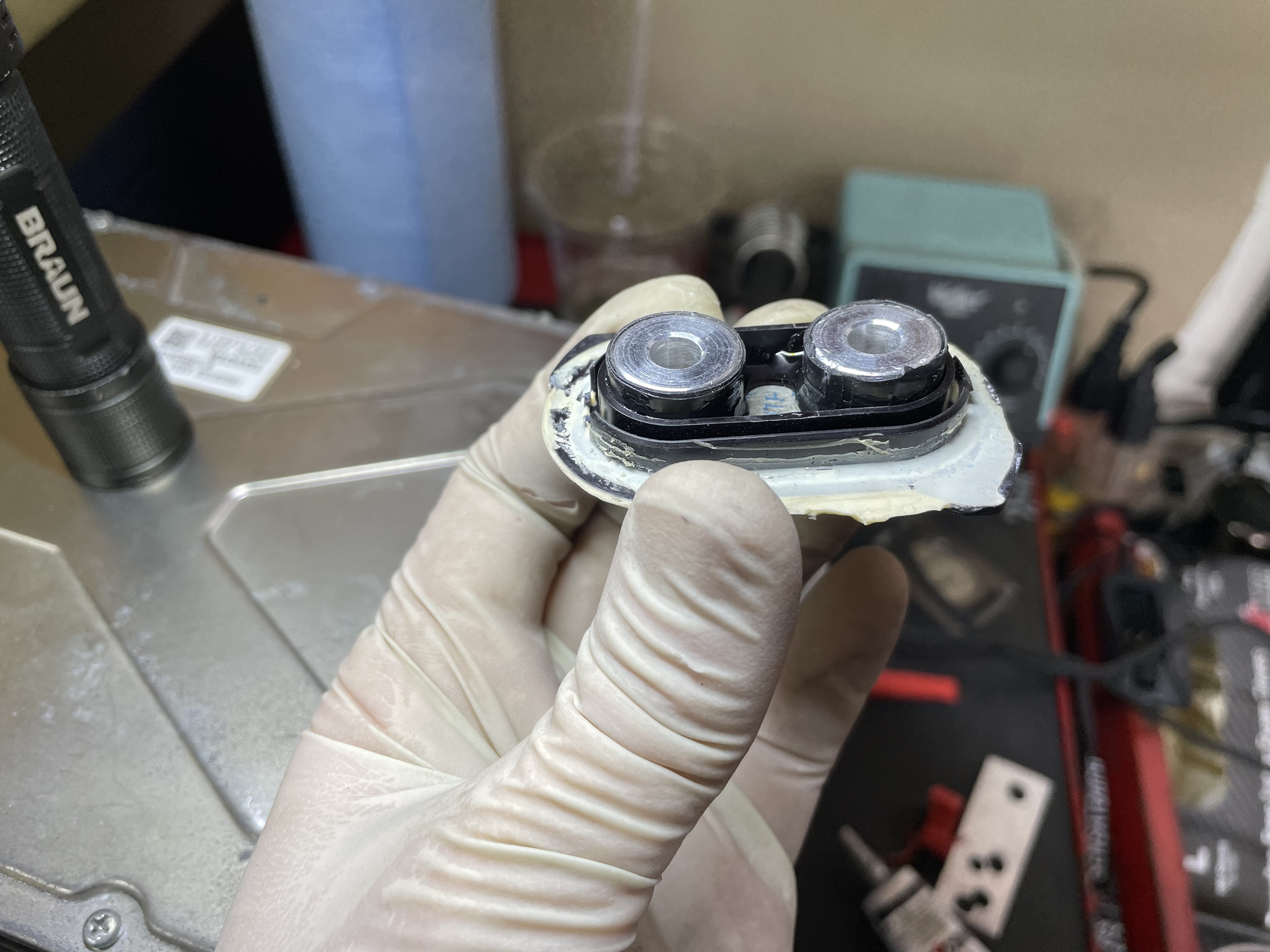

I don’t know the best place to put this, but 3/4” long, 5/8” OD, 1/4” ID aluminum spacers are around $5 on the McMaster website and are perfect standoffs for the inverter DC connections. Check it out:
More fun news, I got my setup up and running today..

Great work on DC connection standoffs. However based on my experience I would recommend copper or brass spacers. Since you already used aluminum, you could use brass M6 bolts to help with conductivity.

Brass is actually half as electrically conductive as aluminum! Copper is almost 2x aluminum but the standoffs in aluminum are equivalent to 3/0 copper wire almost exactly. I’d venture that we’re fine with aluminum.

Bryson wrote: Sun May 30, 2021 3:56 am Brass is actually half as electrically conductive as aluminum! Copper is almost 2x aluminum but the standoffs in aluminum are equivalent to 3/0 copper wire almost exactly. I’d venture that we’re fine with aluminum.
Well copper is best obviously. But it has some properties that limit its use. Namely softness when cutting it and can oxidize...
Yes alu is more conductive than brass, but you need to use correct alloy since some alloys have more resistance than brass or oxy layer on top. Your find is really good priced. Are they made from series 5 alloy? I think that is the best alloy.
Brass is better to work with, it is good hard surface can be threaded and does not oxidize that easy. It can be soldered effectively to PCB surfaces when you need standoffs and brass nuts on the underside.
I made several pieces of standoffs with internal thread to connect phase cables across inox inverter case.
I like brass better, just my prefference.

5052 is often chosen for bus bars due to its formability on a [brake] press even though it has slightly lower electrical conductivity than 6061 alloys - https://www.makeitfrom.com/compare/5052 ... 6-Aluminum but 5052 is indeed very corrosion resistant.
The McMaster standoffs can vary apparently between 6061 and 2011, so using a product like Noalox would be wise (this is what I use on my aluminum electrical joints): Noalox Anti-oxidant Compound (4 Oz. Bottle) https://www.amazon.com/dp/B0019KHHRE/re ... HC6C0JJJEB
You can find the McMaster standoffs here (actually $2.50/ea): https://www.mcmaster.com/92510A783
I’m not an aluminum salesman, but we do use quite a lot of it (and copper wire, but we’d like to switch to all aluminum for weight savings, because aluminum actually has better conductivity by weight) in the course of my work where its properties are very important. :)
