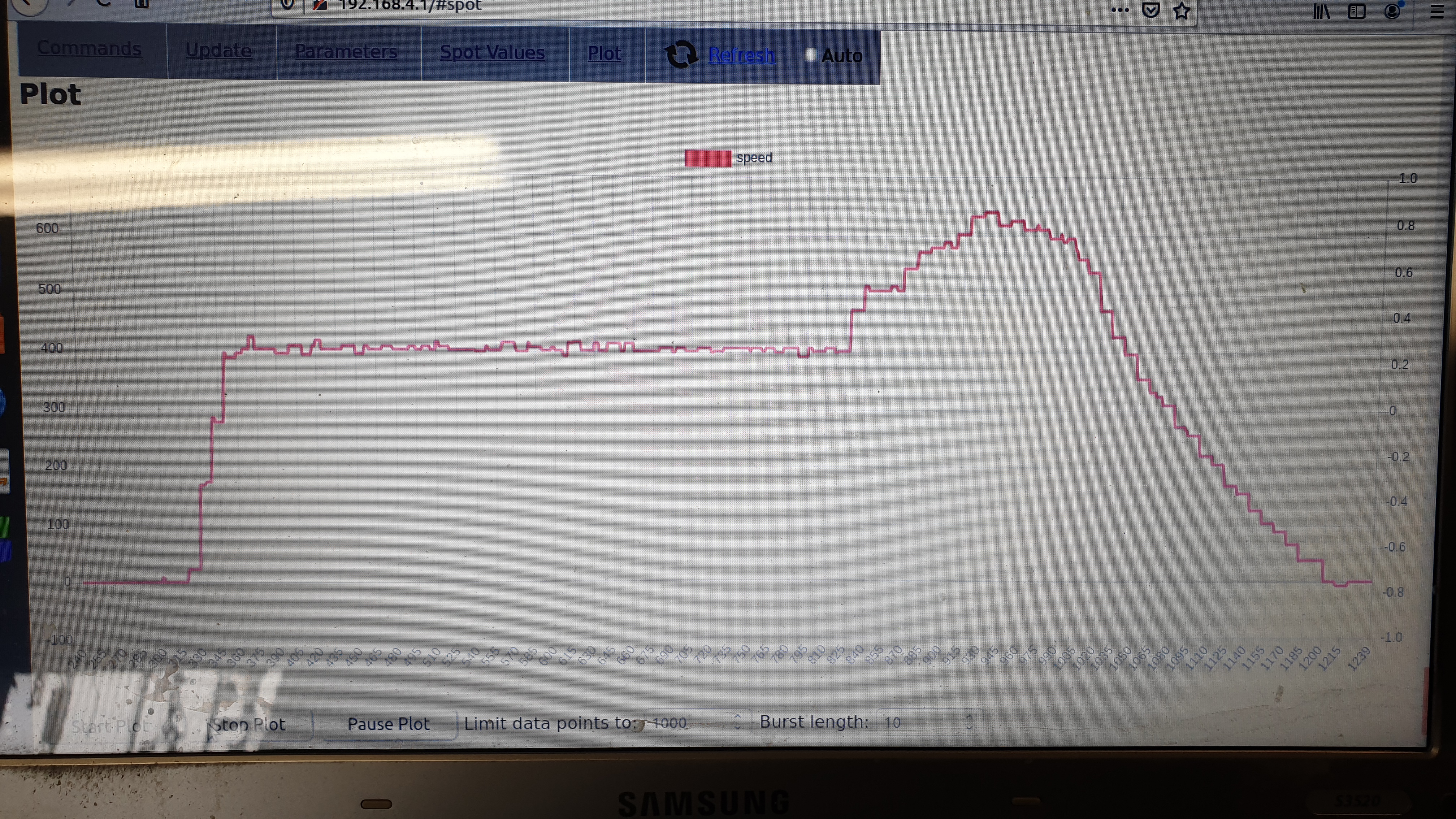

Dilbert, No I don't think so. The control loop would be designed to see some resistance from the car and as we had no regen dialed in it just kept spinning would be my guess.

Ok so over speed like that wouldn't be unusual for one of these motors, so we need to command a negative torque to bring it back to rest on the bench, rather than zero torque, provided we can take back current. OK so maybe we should look at decoding more of the MTH return data and maybe get the RPM indicator working on the ECU, so we can see the real speed. I've been looking at the mth data, bytes 38-39 and 40-41 appear to be MG2 speed if we want to map either of them back for monitoring.Jack Bauer wrote: ↑Mon Feb 01, 2021 8:08 am Dilbert, No I don't think so. The control loop would be designed to see some resistance from the car and as we had no regen dialed in it just kept spinning would be my guess.

Yeah that makes sense. I'm gonna run some more tests this morning just with the stupid power supply. At least we know the issue with mg2 hunting was just the power supply hitting a limit.

So we can now run mg1 and mg2 together or on their own in forward or reverse. Brilliant work on this Dilbert:)
