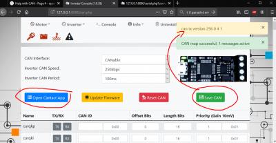

Hello,

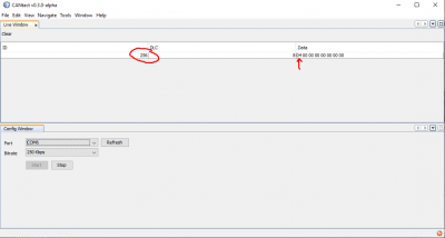

@ Dima: I can receive the CAN message, but interpret what I should say the number (see screenshot) I can not. For me, I see no connection with the value that should actually be transferred (V.4.7.0).
What would help me:
An exact example like me put the value "Version" on the CAN and how I interpret the value read there again.
An exact example like me can set the value "Direction" for direction selection with command "X" via CAN.
Unfortunately, I can not find such a simple example anywhere, either it explains the signal structure, or it is about complex things. How a CAN command from the controller board is placed on the bus and interpreted via sniffer is somehow missing.
With such an example, I could deduce the rest myself.
Greeting,
Patrick
PS."can tx version 001 0 16 1" be a C ++ command? I only use the web interface of the Tesla board, as well as a "CANUSB" sniffer ... I do not know what to do with your hint (entered into the web interface is the sniffer's read result "08 00 00 00 00 00 00 00 ", which has no connection to the" Version "Value for me.)
doobedoobedo
Posts: 260
Location: UK
Re: Help with CAN
Post by doobedoobedo »

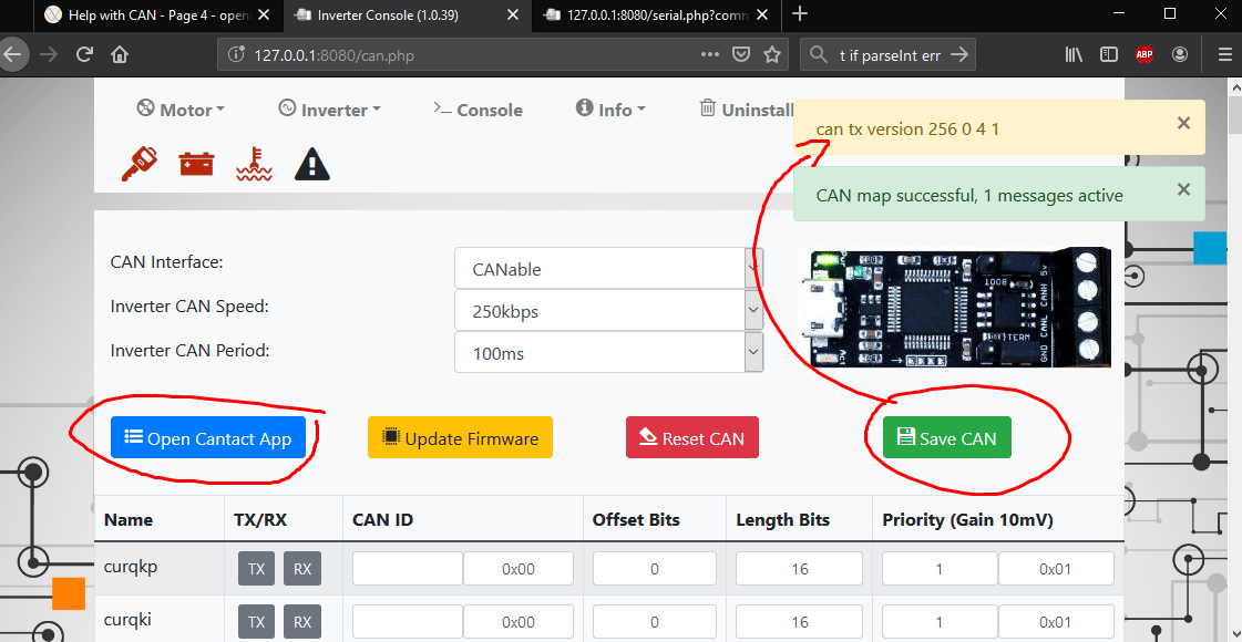

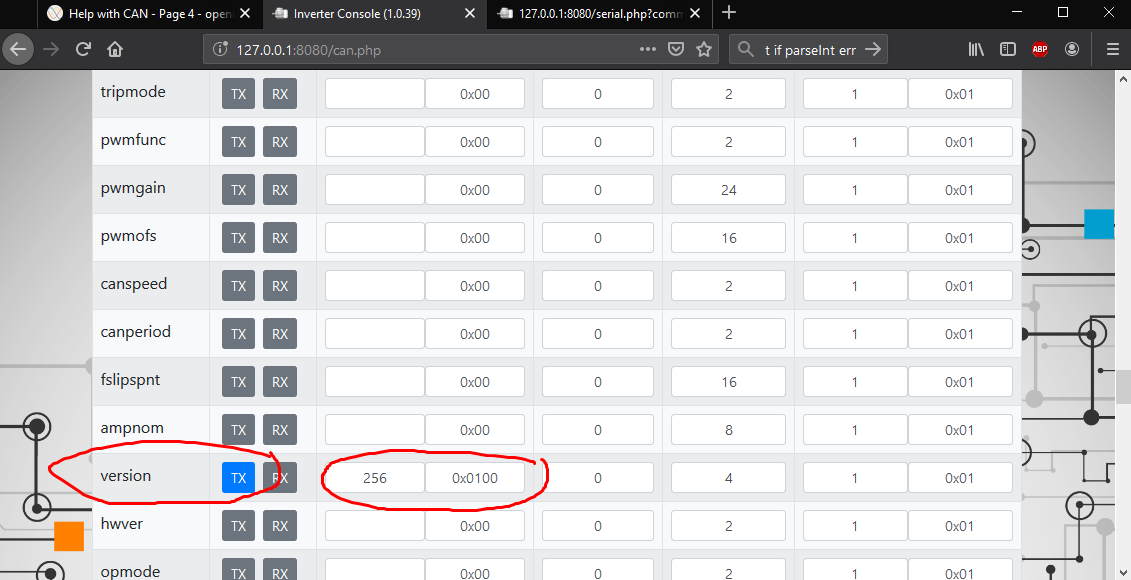

You put the command into the 'send custom command' box in the web interface, then click the button.
Version only transmits the major part (in my case 4) so to see it on CAN id 0x100 you'd use:
can tx version 256 0 8 1
The numbers in order, left to right, mean:
CAN id in decimal (256 = 0x100)
start bit (bit 0 of first byte)
length of the value in bits ( 8 = 1 byte)
multiplier (1 = send as-is)
This is how the message looks to me on my sniffer
can0  100   [8]  04 00 00 00 00 00 00 00   '........'
Avoid using very low CAN ids as the precedence of the message depends on how close it is to zero, flooding the bus with id zero messages is a known attack.

great, this works. So i tried to send the "boostcalc" (Value = 2200). The CAN Massage says 98 08 00 00 00 00 00 00 '........'
The "dir" equals "00 00 00 00 00 00 00 00". Is there a Table that show what a bit means in such situation?
But ive could controll the "pot" for Regen over CAN :)
