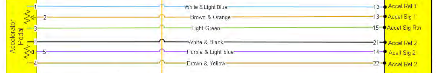

I found this info on the forum but it took a bit of digging so I thought I would create a post dedicated to the topic for others in the future.
Here is the Tesla throttle pinout:
Here is how those pins map to the 23-pin on the drive unit (image courtesy of EV Controls manual):
I had to search this out because the colors of my wires on the Tesla pedal didn't match the colors in the EV Controls manual. Lining this up with the wiring diagrams for the Openinverter it looks like we only use pins 1-3 just like the BMW pedal.

I'm trying to get my head around it, my LDU came without the connector from tesla + it came with a Prius Throttle pedal, have they working together before by any chance?

Most automotive pedals use a dual hall effect sensor design. Use whatever pedal you want as long as it returns a proportional signal. People are using pedals out of Honda/Toyota/Telsa/BMW. I use a Subaru STI pedal to avoid paying the insane price increases on used Tesla parts.
The pinout is not standard, but there is always two sets of 3 lines.
power (usually 5V)
sig (connect to openinverter throttle input)
gnd
While manufacturers use both for redundancy, openinverter only uses one. In my build, I'm reading both signals and using a comparator to make sure the pedal isn't bad, and then feeding into openinverter board.

amzoo wrote: Thu Feb 11, 2021 4:26 am While manufacturers use both for redundancy, openinverter only uses one. In my build, I'm reading both signals and using a comparator to make sure the pedal isn't bad, and then feeding into openinverter board.
Small correction here: the secondary throttle input can also be used for redundancy.

I'm not seeing the second input in the SDU pinout. Am I missing something obvious?
Been thanked: 1918 times
Re: Tesla Model S Throttle Pedal to 23-pin
It is called "BRAKE_TRANS" on pin 10. Obviously you loose the ability to do analog control of regen with the brake pedal.

Ah, that's why. I use a secondary MCU to process error handling for both brake and throttle inputs and then feed into the board since I use analog control for both. Appreciate the alternate use case.

johu wrote: Thu Feb 11, 2021 7:41 pm It is called "BRAKE_TRANS" on pin 10. Obviously you loose the ability to do analog control of regen with the brake pedal.
Which can be fed to the controller by CAN.. so pedal is secure and Regen still proportional.. :)
