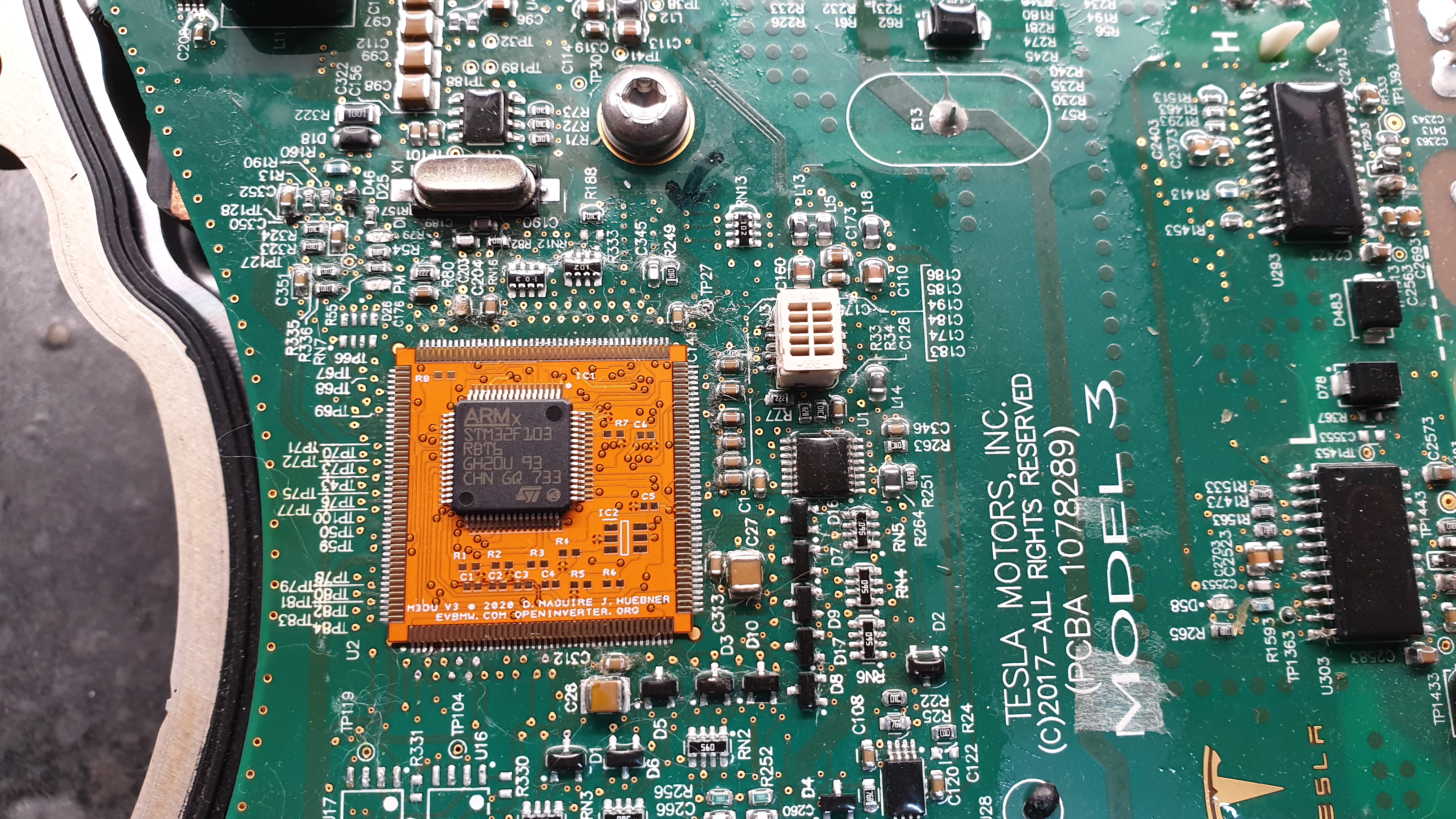

Ok folks long time no update. Thanks to PCBWay I think we have a neat solution. Won't be cheap (bare boards a little over $100USD each!) but I think this is going to work. Basically taking the provious design, shrinking slightly to allow more overlap of the adapter board and main board pads and going to a flexi pcb material with gold fingered ffc connections on all 4 sides to solder to the pads. Need to do some back and forth with their engineering people but should have boards very soon. I should also note that PCBWay are sponsoring these boards for me. If it works out I'll get them to populate the next batch so wish me luck:)

Boards are now in production at PCBWay.

Just got a shipping notification from PCBWAY. Boards are on the way:)

Got a little present from PCBWay:) I think we have a winner. Video and reveal soon.

I'd call that more than a hint.
In a way this is the best of the both worlds - massively engineered acquisition / power supply circuits, with a just-as-complex-as-needed motor control firmware.
Nice job!
-Matt
Nice job!
-Matt

Internet : You can't run a Musk motor with a measly little Stm32.
Johannes : Hold my beer.
This is an amazing job. While I'm sure someone will figure out how to flash the OEM chip over CAN like Tesla does, this is a great alternative.

I've just watched this despite no intention to use any Tesla parts, frankly i'm astounded this is possible from a DIYer position. Incredible

The biggest issues are:
1. You'd have to pretty much 100% reverse engineer the whole pinout for the OEM chip so that you're sure you don't have it doing anything too dumb. Now, you nearly have to do this anyway with Damien's approach because you still are connected to the same pins and have to write code to do the same things. I imagine he's using a chip that the community knows well to hopefully shorten the process. Using the OEM chip would be an additional big learning curve for everyone.
2. Once you figure out how to write the code now you need to flash it. While some of us know how to flash stuff over CAN to a Tesla device we're not really releasing that info publicly because Uncle Elon will pee in the punch if we do. That is, what's possible now would probably get locked down if too many people knew about it. That's really the double edged sword of open source. Some things you can't give specifics about because once they're in open source someone from the OEM will make sure you can't keep using the same methods.
Thus, while it is 100% possible to flash the original chip it's potentially fraught with future issues. Damien's approach is much more difficult for Tesla to work around. And, frankly, I don't think they'd bother. Having to cut the legs off of the chip, desolder it, and use a custom board that you then have to solder on is a LOT of work. The barrier of entry is so high that I think they'd just figure it's a niche market of no concern. Contrast this with someone spilling the beans on how to flash custom stuff over CAN. That approach conceivably affects every single motor in every single car. A much bigger target, much easier to pull off rapidly, much more worrisome to an OEM. Then they send the black ops people and the bean spiller gets their patties wacked and thrown in the back of a nondescript van. So, I think the likelihood of custom firmware to be flashed over CAN is slim.
But, Damien has perfected a different approach and I think that's pretty cool. I wish I had the hardware skills to do stuff like that.
