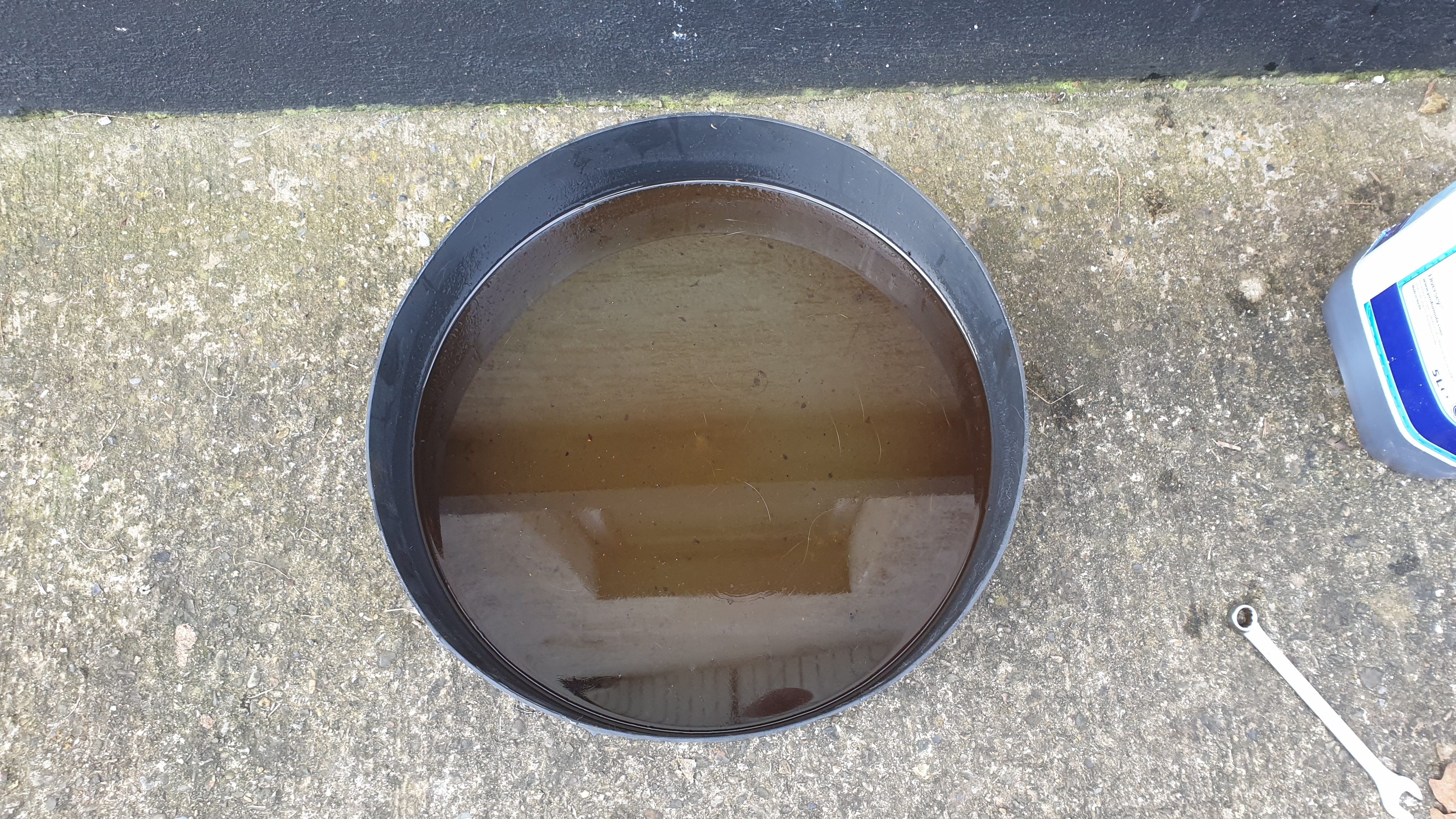

I was once asked by a friend to look at "an oil leak" on one of these.
I got it on my ramps started looking around and found it was leaking from many many locations. I did not fancy tackling the job of fixing all the leaks.
That undertray cover thing looked totally black, when I jet sprayed it clean to my surprise it turned out to actually be a silver colour LOL

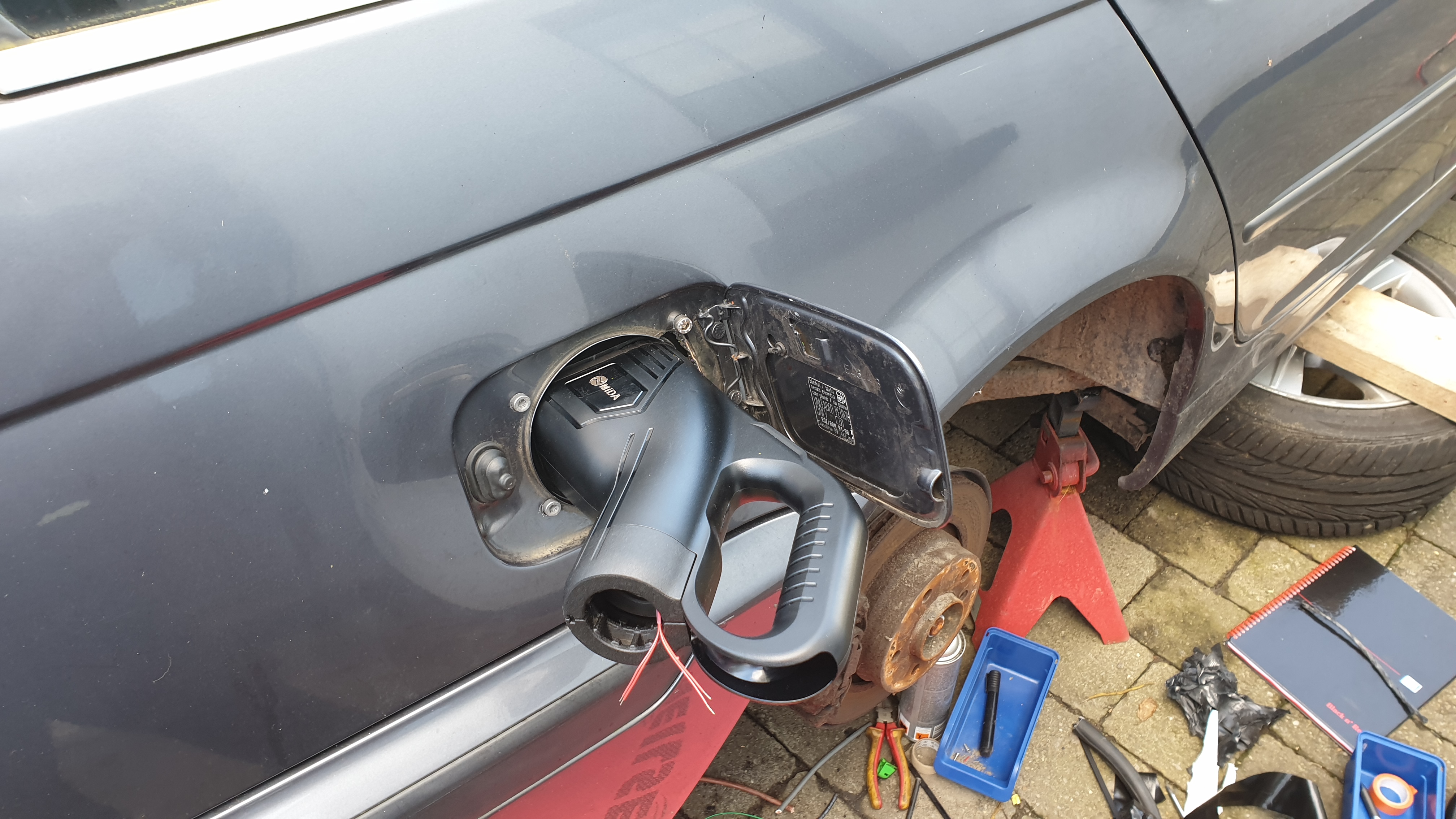

Some grey goose progress thanks to a few fine days. CCS charge port fitted. Planning to use the i3 controller for the CCS side of things. Two new tyres for the front and changed out some horrible looking brake fluid. While doing that found some genius had repaired a blown brake hard line with some tube and hose clips. Now that I have a vac pump running in the car it made enough pressure to blow it off! So yeah, after my pulse rate cooled off I did a proper repair.
Next job : fit the pcs controller and start trying to wake up its sleeping Elon brain. That's always easy ....

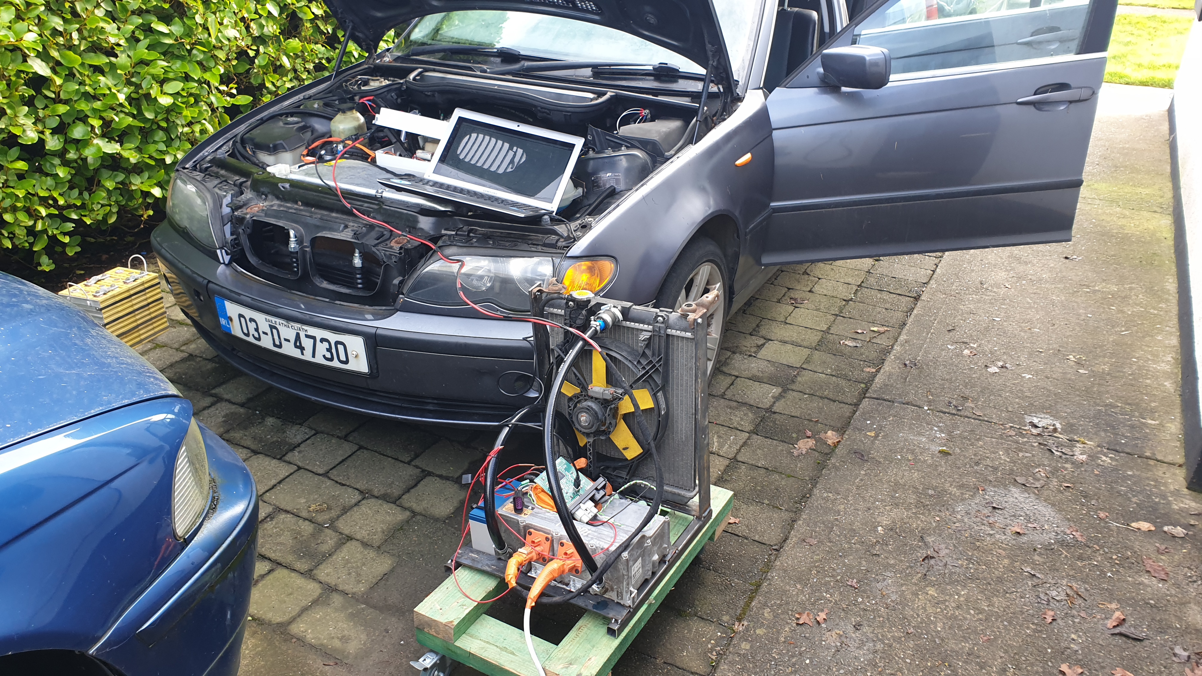

Few photos from today. PCS controller fitted and wired in. Starting to do some can on that tomorrow. i3 LIM and CCS contactor boax fitted to the rear.
