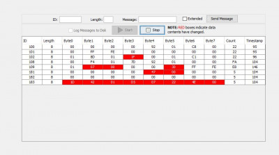

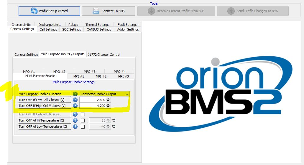

Dear community,
i really would apprechiate your Help here. I've set up the CHAdeMO as Ewert Energy suggested it and hoped it'll work right away. Unfortunately if i connect to a charging station it starts to communicate but then it ends the "charging" after approximately 21 seconds every time. It doesn't really start to charge, there is no amperes or anything. But the EVSE knows my SoC obviousely! So the CAN-Communication seems to work.
Can anyone see something in these Pictures or in the Video of the CAN-Sniffing?
Thanks a lot!!!! Philip

Here's my quick run from the screenshot:
0x108:
500 V max
125 A max
402 V threshold voltage (aka stop)
bytes 6-7 0 - correct
0x109:
CHAdeMO 0.9
7 volts on the wire
0 current
byte 4 reserved
byte 5 - 0x30 -> 48 decimal:
* #define EVSE_STATUS_BATTERR 16 //something wrong with battery?!
* #define EVSE_STATUS_STOPPED 32 //charger is stopped
So there's your issue...
255 minutes allowed
0x100:
402V max voltage
20 kWh pack size?
0x101:
Charge time estimate ? Not sure.
0x102:
Voltage target 397V
Current target 31A
Charging Enabled
SoC is 193/255 -> ~75.6%
I'd have to watch the video again, but I'd imagine it's something with the analog signaling part that's broken, not the CAN part. If you don't have the relay setup right, it's not going to to work.
-Matt

Matt, that's incredibly helpful! Thank you SO MUCH!mdrobnak wrote: ↑Wed Mar 03, 2021 12:23 am You may wish to look here: https://github.com/mdrobnak/can-dc-fc-r ... ms_loop.rs - for 108/109

Re: CHAdeMO on Orion BMS - please help

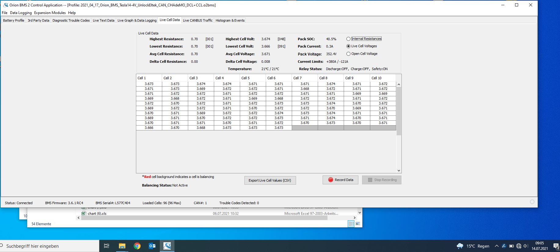

Solved! The wiring was correct, the CAN-Messages where correct, too!
Just one setting in the software prevented it from working. That took me hours to figure out, as in the Orion BMS manual the setting described as recommended, but not clearly as necessary!
Finally charged at 70 Amp max due to my already high state of charge. I've set the Maximum under ideal circumstances to 125A at 397V - is that correct?
Thanks again for your Input, it helped a lot!

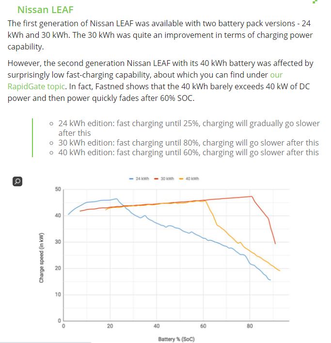

As already said i set the max to 125A at 397V.
Also i reduce the current at 81 percent to around 8 Amps at 100%.
Is that too much charge power for the high level of state of charge?
Thanks again!
Thanks again!

Re: CHAdeMO on Orion BMS - Solved!
Found the answer with google very quickly
my 30 kWh pack should be fine with my settings according to this graph
I'll leave this here, maybe it'll help others somewhen, too.

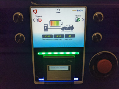

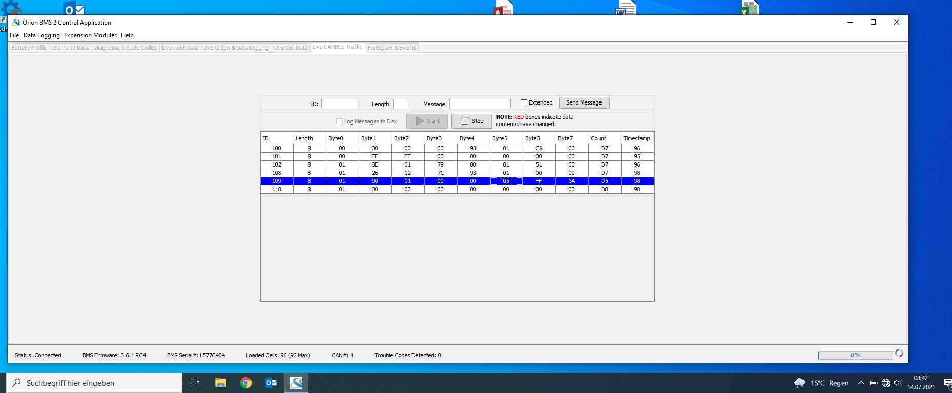

Re: CHAdeMO on Orion BMS - Need Help Again Please
i drove almost 400 kilometers with Johannes last week and every fast charging session worked fine. Yesterday i wanted to drive another 150 kilometers and hooked the car up to the fast charger. Unfortunately it did not charge. I've tried 3 different fast chargers!
I can see the voltage ramping up to just above 400 Volts. The charger does not get in error state neither does my BMS. Everything works fine it just doesn't start charging. It does not ramp up the amperes.
I made a video of a charging session - maybe someone sees something on the canbus???
https://photos.app.goo.gl/a7hn13ZHUQndRiYX8
So nothing changes from this point on:
0x109 01 90 01 00 00 05 FF 3C
0x108 01 26 02 7C 93 01 00 00
Thanks a lot again!
Seems to be nothing wrong with the 100, 101 and 102 messages. Charge requested at 121A, 398V, 403V over voltage.
Charger reports max current of 124A in 108 message and 400V output voltage, charging and connector locked in 109.
Do you hear your contactors close? Can you check if they are ok?

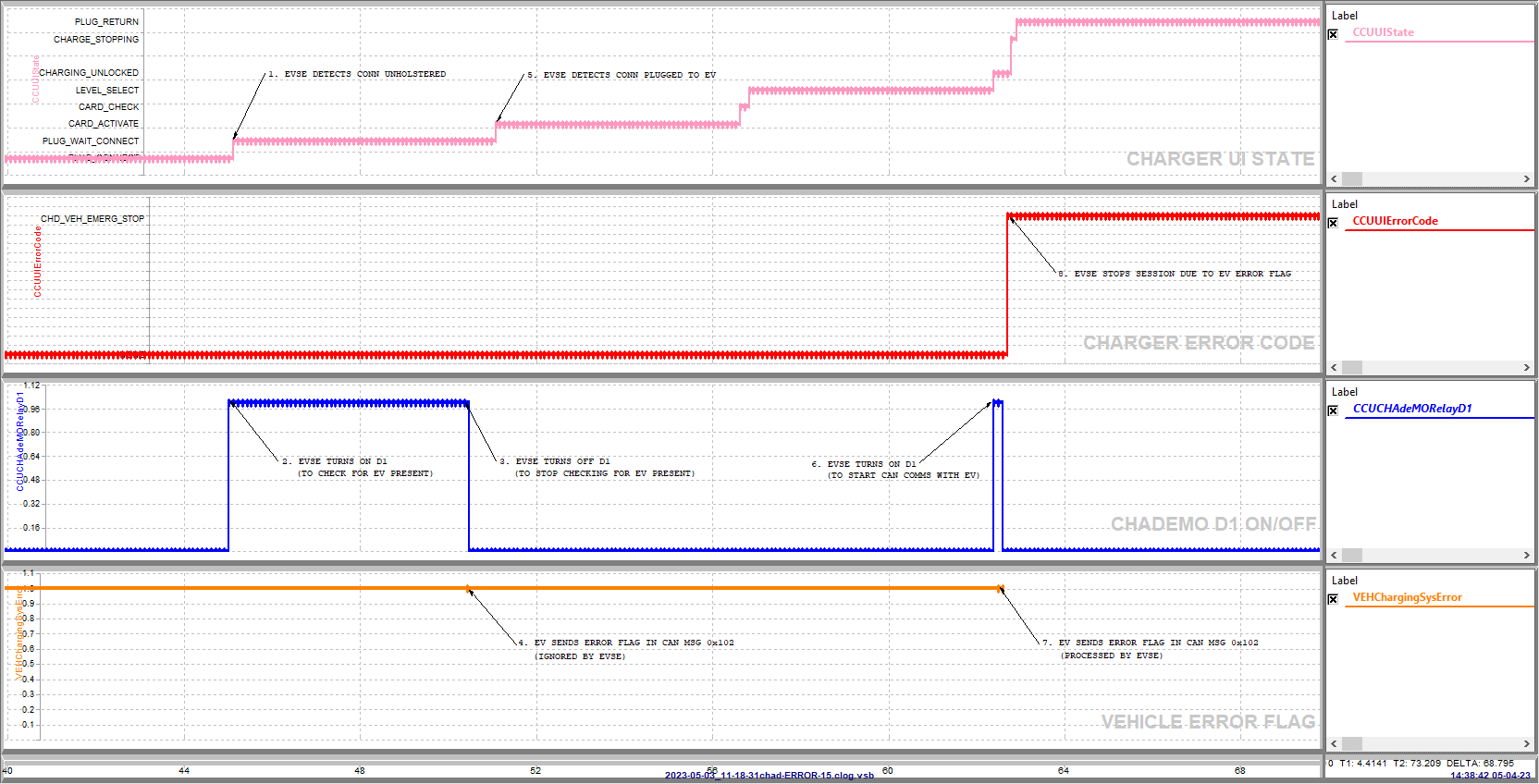

It's very weird!!!!!!
I don't understand this at all. To me the canbus commands seem correct, too. But it does not ramp up the amps.
BUT (!) there are 0,3A of current flowing! WTF? So it is actually charging, but in a ridiculous slow way. I was thinktink if this might be a BMS fault, bit it actually does send the correct information, or doesn't it`?
Here another try: Here you can see, that current flows: After almost 5 minutes of charging: After 12 minutes of charging:
Does anyone have any ideas what could be the cause here?
Thanks to everyone helping me on this - i really apprechiate it a lot!
In the end it was the relay of the positive side wich barely closed but didn't have full contact. So the station thought everything is all right, as the relay closed, but wasn't able to push the current through. I've exchanged the relay and now everything works fine again.

Can someone tell me what program is being used here, over the top of the Orion utility, to get the explanations of the CAN messages?
- Zapatero
- Posts: 445
- Location: Germany, Ulm
- Has thanked: 25 times
- Been thanked: 42 times
It is the Orion Software. It has this feature to show the can live messages
