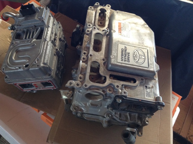

Just seeing your post now. I received a spare Smart inverter from the San Diego scrapyard. Haven't opened the box yet but anticipated that no one yet has pursued liberating the Smart ED3 thus having a spare on my bench would prove useful and avoid having to crawl back under that car (makes me dizzy). Dealer says parts chart calls the inverter a "battery charger unit" and the VCU a "Power Train Control Unit". This VCU is at rear on the passenger side according to the chart. I will need to order a spare VCU since this might be modified in future. Meanwhile asap I'll open the inverter and record the space available for a logic board and itemize the MOSFET etc.

To open SmartED inverter requires a penta-allen wrench which I can either make or just grind a slot across this plug to extract it. The other plugs require a knurled rod or, again, I'll just grind a slot to unscrew them. Four plugs cover up security straps which keep box together. So by June I can get the little box opened up and determine the power devices that run the ED inverter. Meanwhile to assemble open logic board kit for prius Gen3.
Prius3 inverter is mucho huge:
More dramamine, Ma!
