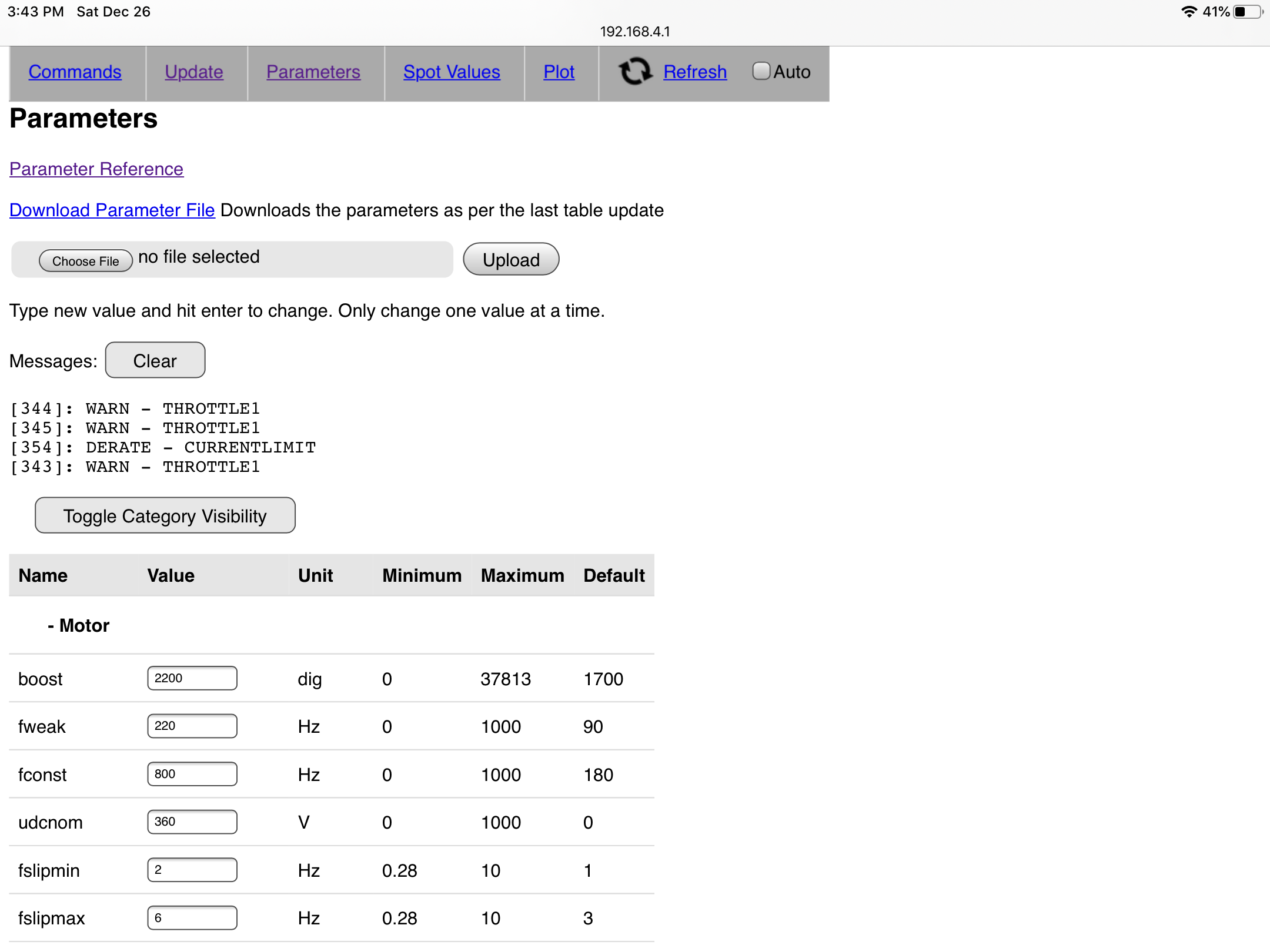

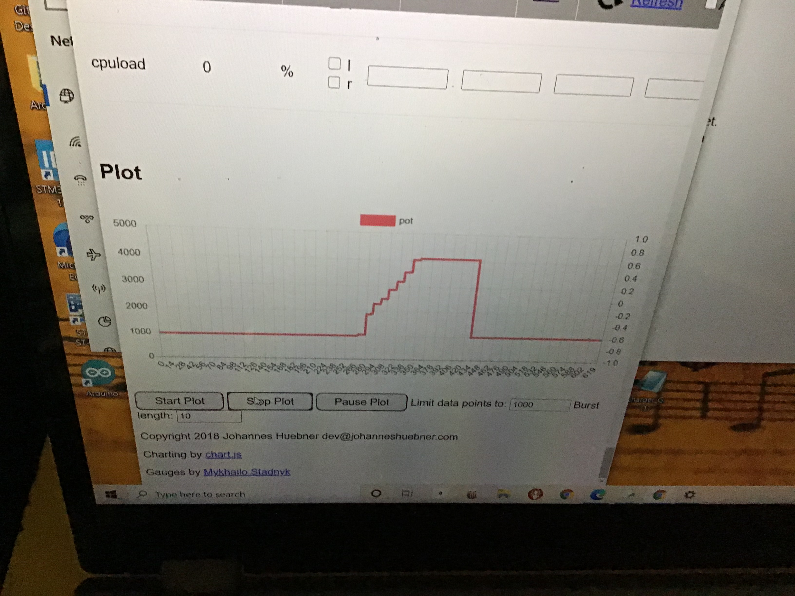

Both contactor close first one on power on and second one at start signal.
With or without Hv Derate error current limit and also error throttle1.
But could be the possible reason.
Attached screenshot

Re: Tesla SDU drop in board current gains
Post by Johaljaswant »
Throttle1 issue is solve wiring problem.
Motor spin but still have currentlimit error.
Please advice any clue.
Using latest firmware? 4.96.R
Johaljaswant
Posts: 56
Joined: Wed Jul 03, 2019 1:35 pm
Location: USA
Re: Tesla SDU drop in board current gains  [SOLVED]
I update firmware and it’s work no more currentlimit error.

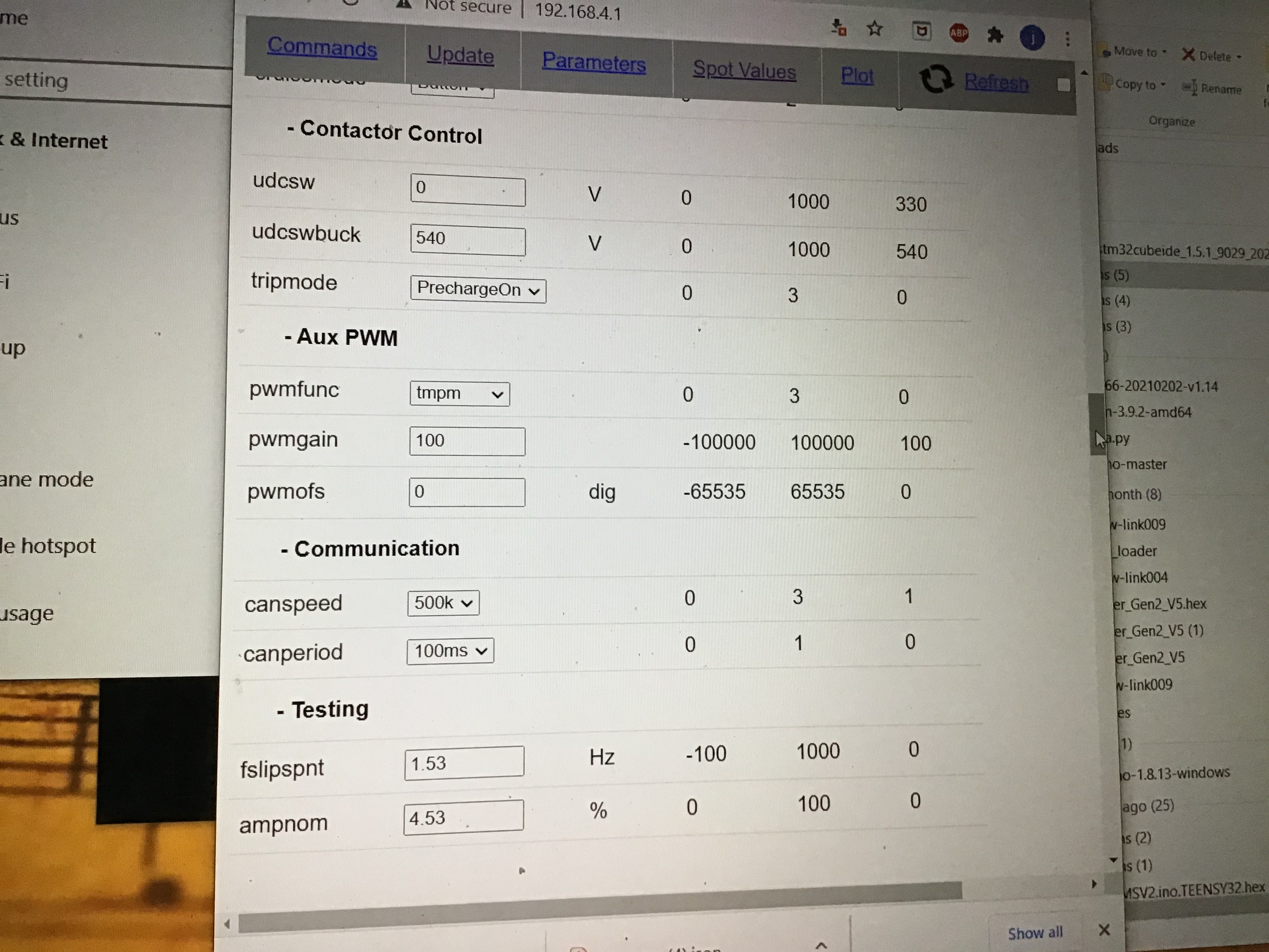

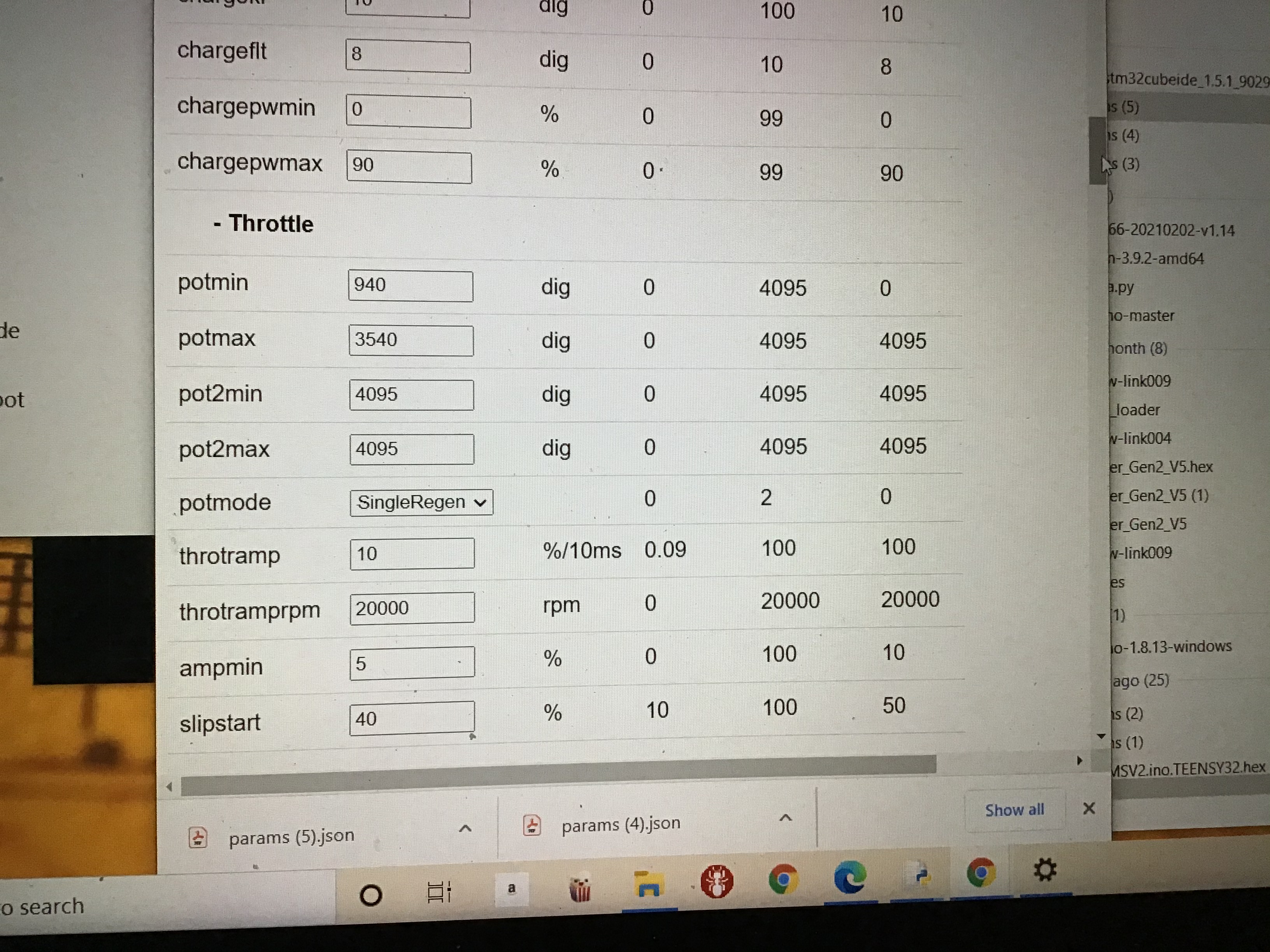

1.Main contactor close at only UDCSW =0 while battery voltage is 365 V. If I put UDCSW =10 contactor does not close.
2. Tesla SDU Motor spin very fast when pedal just engaged . Pedal signal voltage is Fine 0.7 v to 3.8 v. So pedal does control speed.

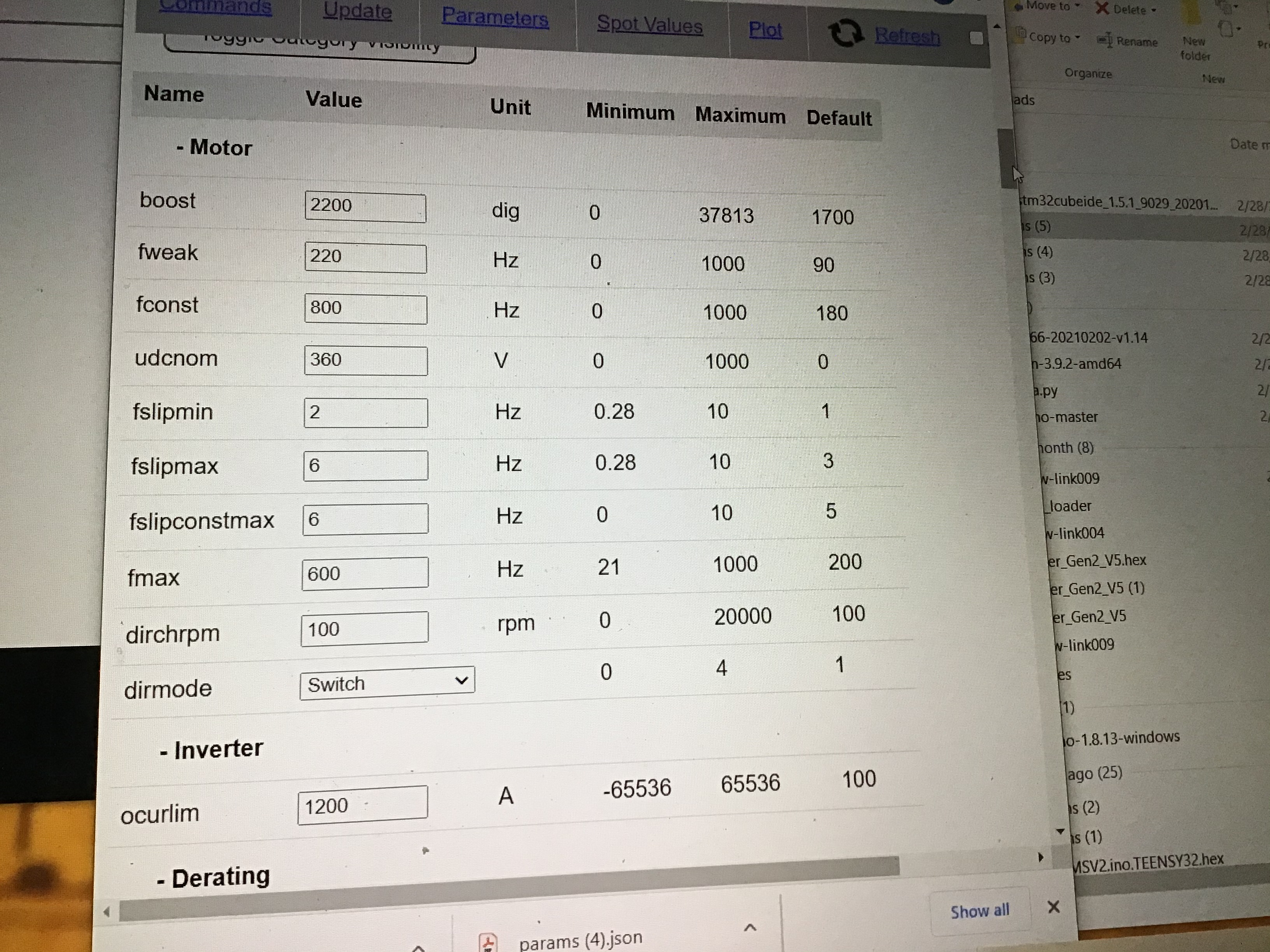

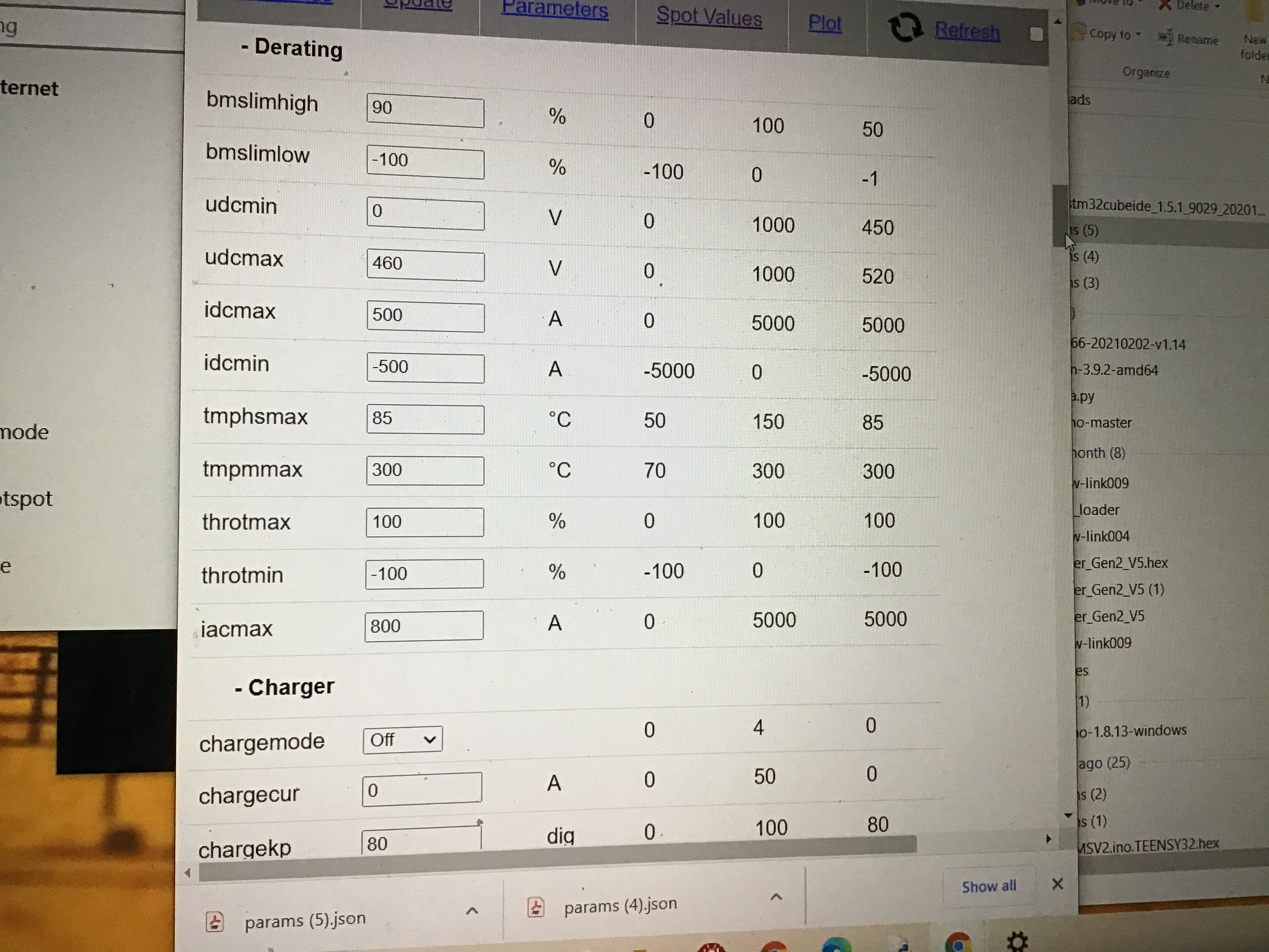

Attached parameters
Can you set udcnom=0 just to check.
Something is probably not right with your bus voltage measurement or precharge circuit
Did try with UDCNOM =0.
Motor does not spin.
No any error code store.
Main contactor engaged sound is different than before I’did not check precharge relay circuit yet.
Please advice
Posts: 6754
Has thanked: 382 times
Been thanked: 1575 times
Well, setting udcsw=0 on a HV pack will definitely weld your contactor and it will then sound different to say the least. Sorry I didn't catch that one before.

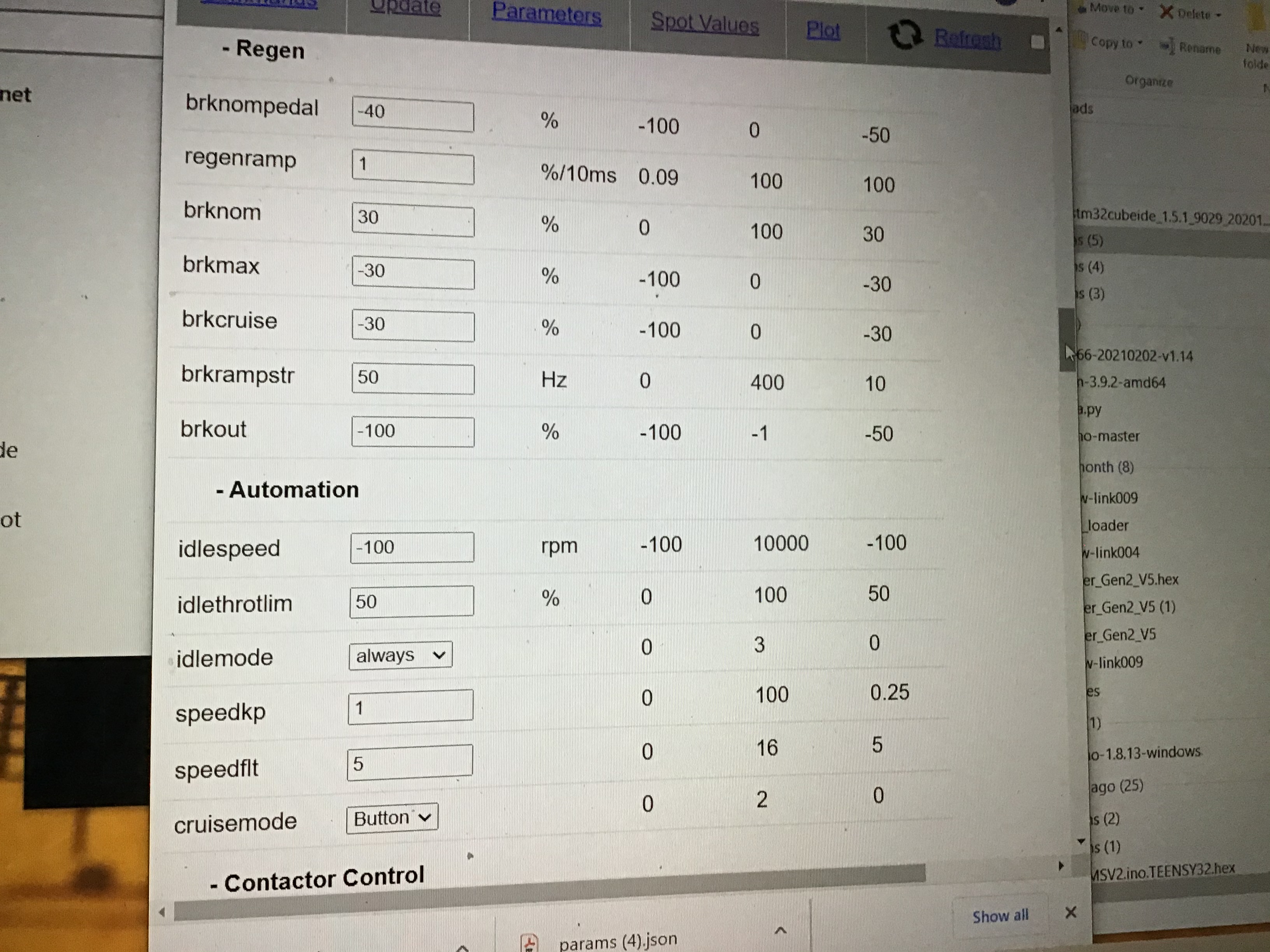

My car pre charge relay was gone. Change the pre charge relay.I test run, wheel up, on idle speed it is fine.
Also with pedal it run but still fast. But controlling the speed with pedal.
How I can make less aggressive .
My car has brake sensor as will. But car get ready Without pressing the brake,
It should be ready while brake on.
Please advice.
Attached parameters

Posts: 6754
It is hard to control speed with the pedal, as the motor torque is controlled. Once the vehicle is on ground it will make more sense. If I understand correctly you only want the inverter to change to run mode when brake pedal is pressed?
Your parameters look ok but are different from standard. If you want to revert to standard parameters, look here: https://openinverter.org/parameters/view.html?id=15
Did your main contactor survive switching into a discharged capacitor?
