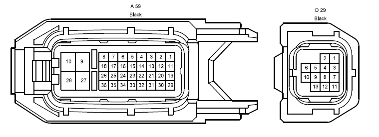

Here are some connectors and Toyota part number for connecting to the Prius/Yaris gen 3 inverter. Still need to find the tails for the small signal wires and the resolver plug.
Perfect, thanks for posting! So the repair wire is one of the main 12V/Ground connections to the inverter.
I'll see if i can identify a crimps for the smaller signal wires, i would guess the same crimp would be used for the resolver connector. I have measured the pitch of the connectors and they seem to be 3mm pitch. I guess from a manufacturing point of view they don't want to use too many different crimps, so they must be used in other connectors.
The larger repair wire (82998-12440), is listed here:- https://www.ih8mud.com/tech/pdf/WireHar ... pairwi.pdf
Looks like this is the larger crimp terminal https://www.bmotorsports.com/shop/produ ... ts_id/1762
Sumitomo TS 2.3II Female Terminal
It says that its a 6mm pitch on the larger terminals.
If the whole connector is Sumitono, the only crimp that seems close to the right pitch for the signal wires is the type 1.0II or 1.0III, which are 1.8mm wide...

Here's the Pinouts for the GEN3 Toyota Inverters, we will probably move these over onto the wiki when there is some time.
gen3 pin out.xlsx
- (37.3 KiB) Downloaded 212 times

@Dilbert yeah lets start putting this on the wiki. I have a sneaky suspicion the gen 3 inverter will drive any Toyota motor...... Don't want to say that too loud or I'll get mobbed by even more emails:)
