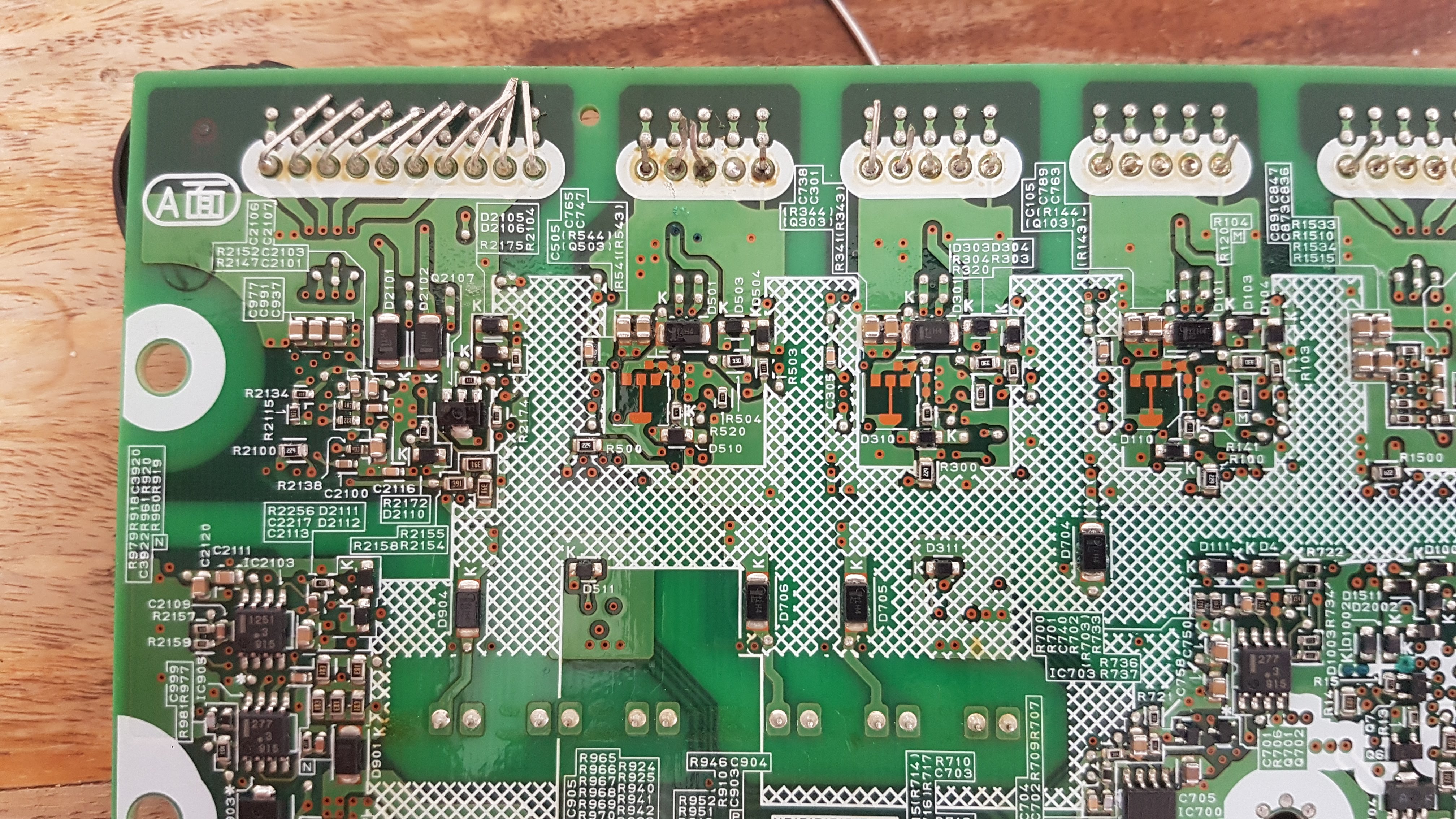

Ok, so the Yaris and the Prius Gen3 look alot different when it comes to the voltage measurement.

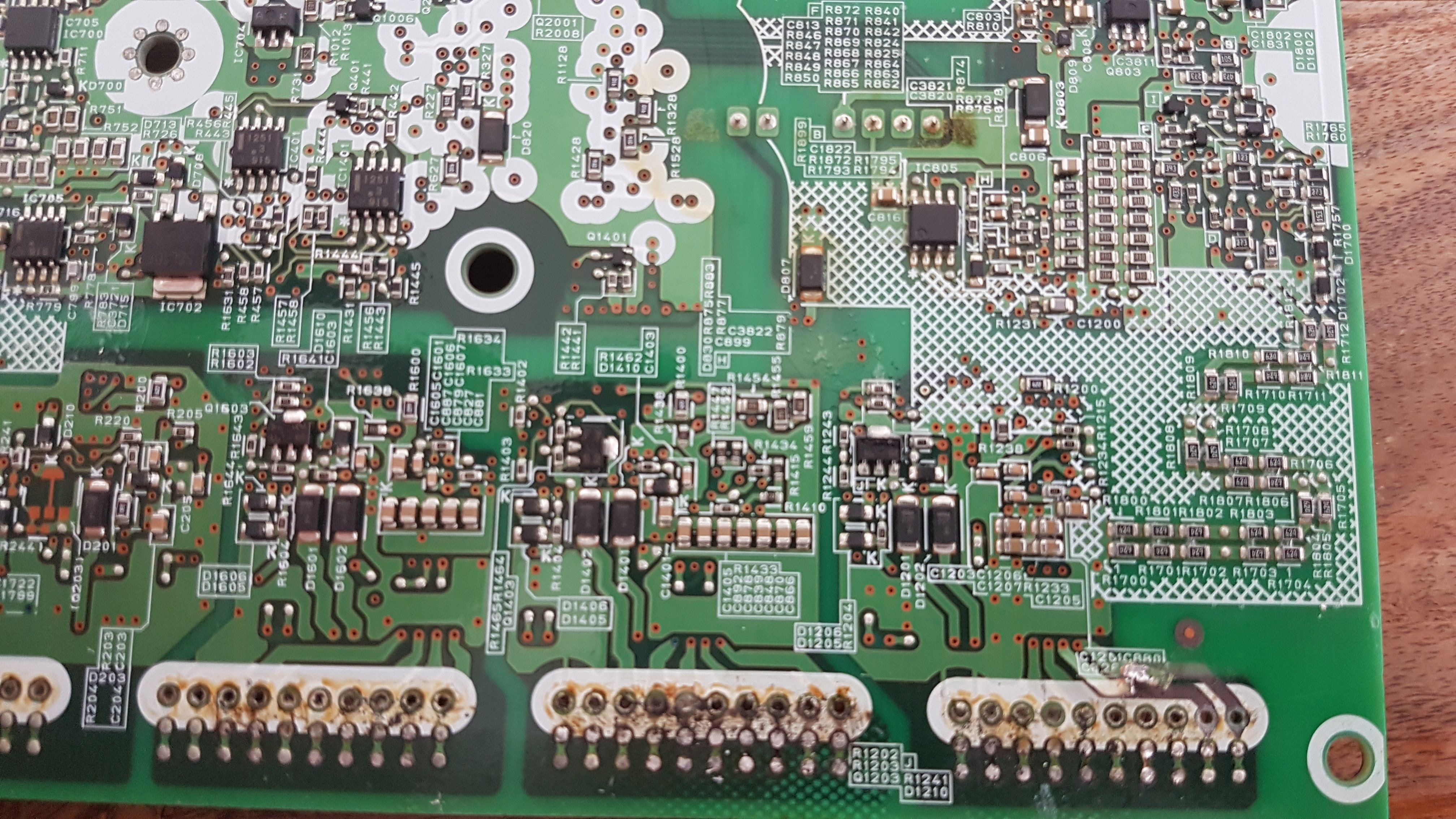

Pulled my Prius inverter of the car, to find out that many of the components are on the underside of the IGBT-driver board, specially the dc-bus1 measurement.
Does anyone have detailed pictures on the underside of the Prius Gen3 IGBT-driver board??
I'm not very happy to desolder all 90 joints to the IGBT:s just to have a look...

This is a Gen 3 board, happy to send it to you if it's of any use.

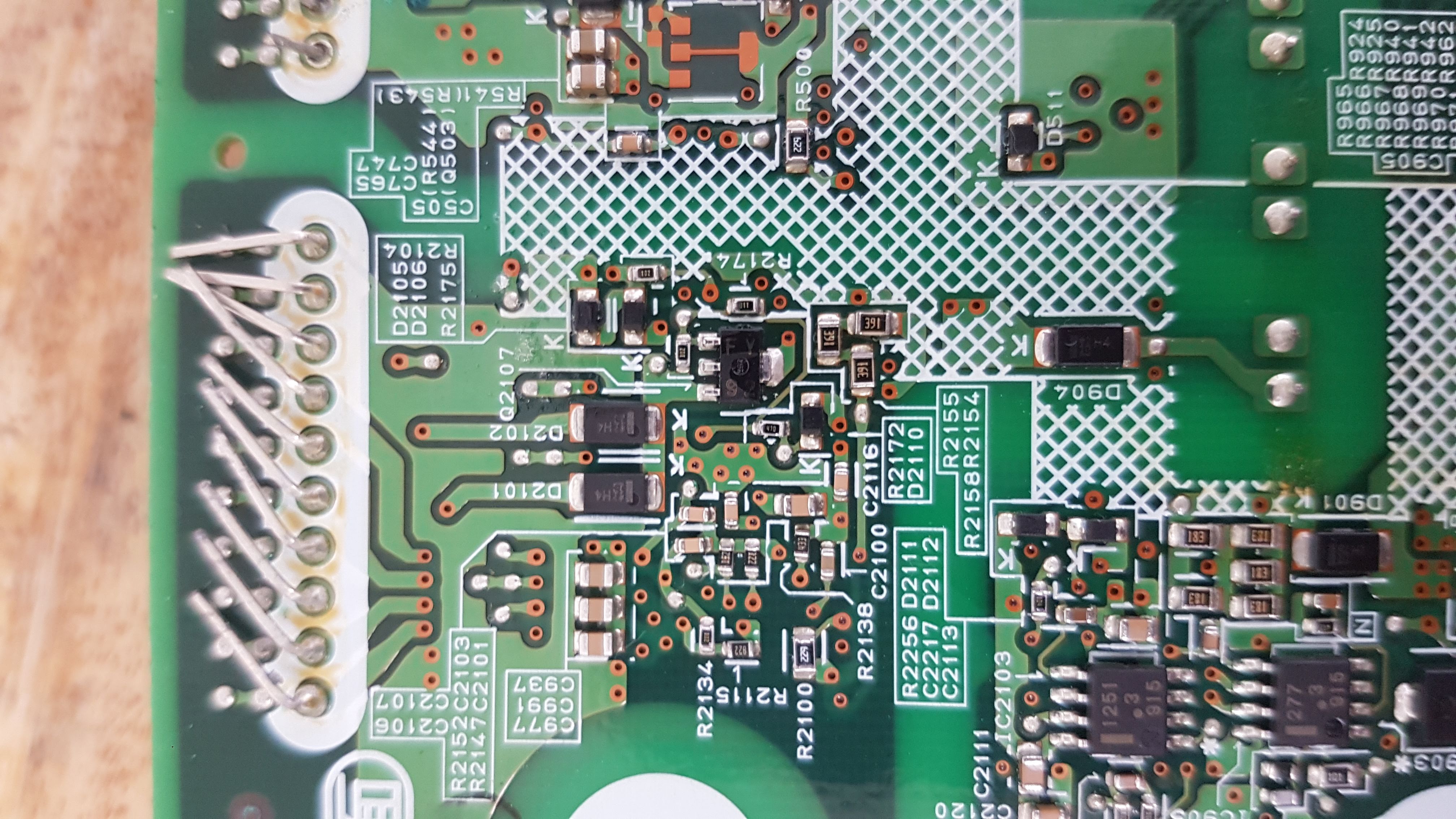

If it is possible, the area I marked in red in these two pictures, could you take one picture of it? Please, use more light making the picture clearer so I can read the component values more easily.
I appreciate your offer about sending the board! Hopefully the pictures will suffice.

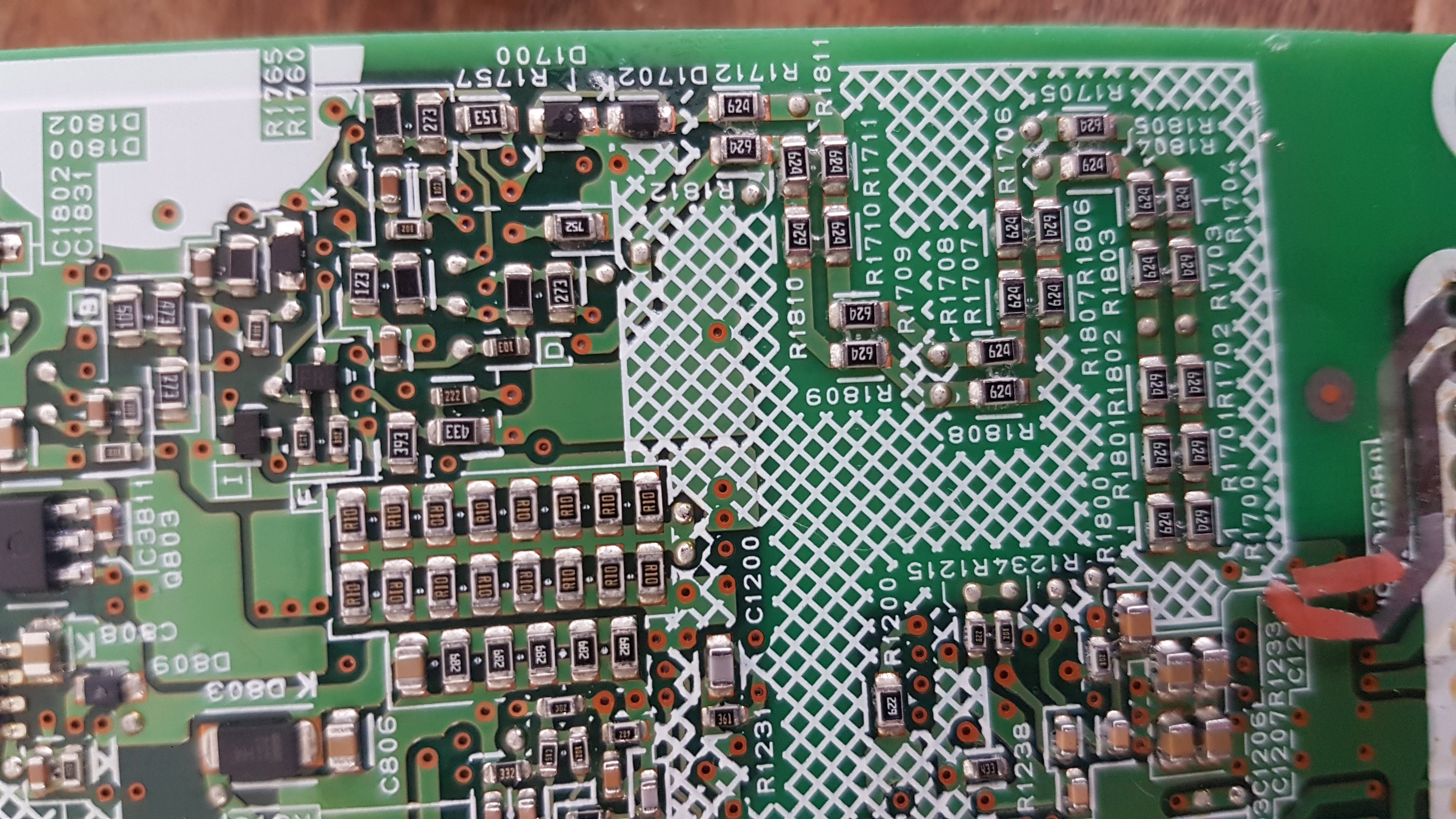

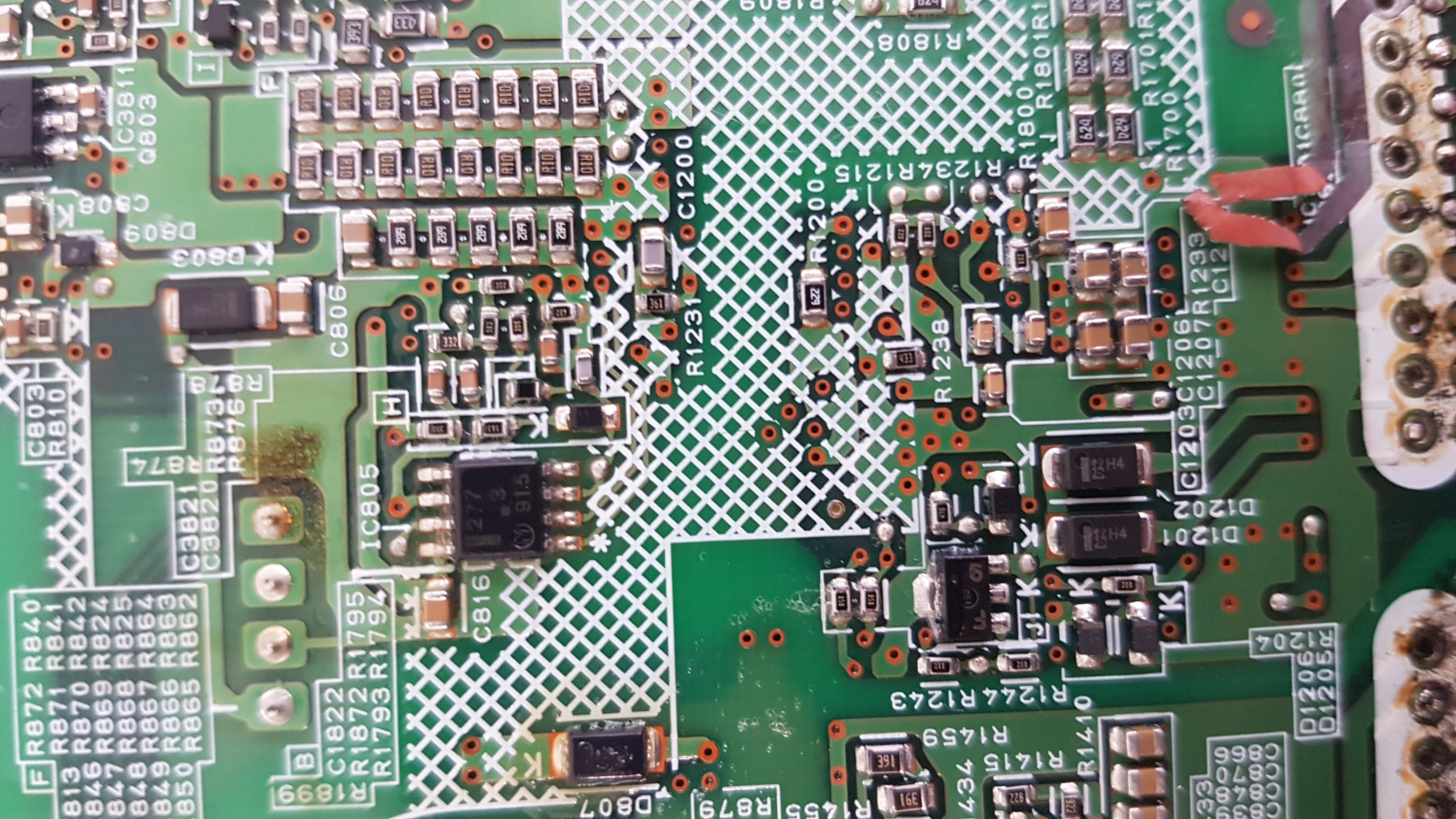

Re: Prius Gen 3 DC-BUS1 voltage measurement
Hopefully I've got the area you're interested in.

Thanks to the pictures from Bigpie I could find out that the input side is very similar to the Yaris one.
8Mohm in series and 15kohm in the feedback. So I decided to test and reduce the feedback to 12kohm for a bit lower signal, hence larger measuring range. This could be done adding a few resistors.
Will share more details about this when tested and verified.
bexander
Posts: 867
Location: Gothenburg, Sweden
Has thanked: 71 times
Been thanked: 97 times
Post by bexander »

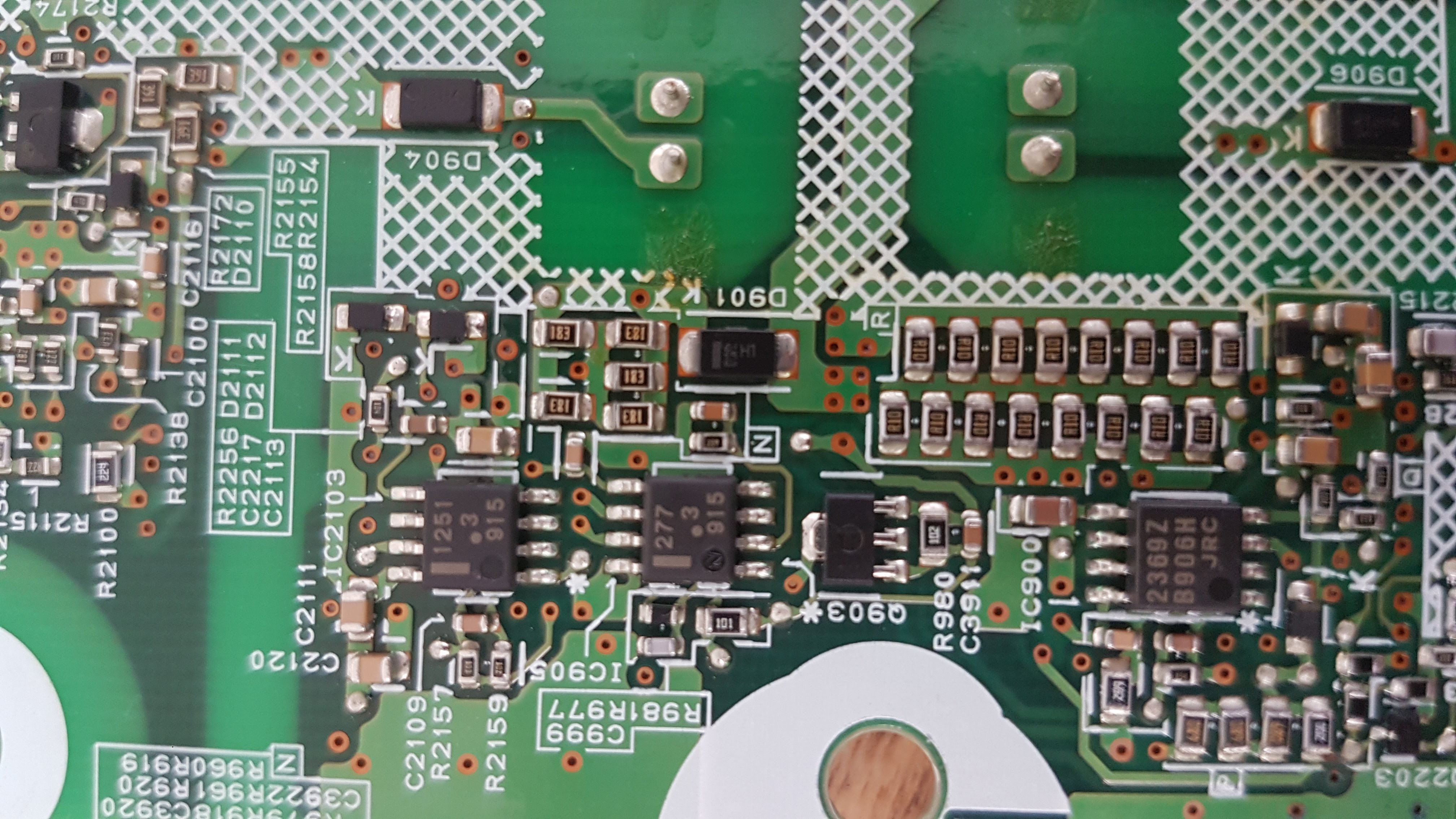

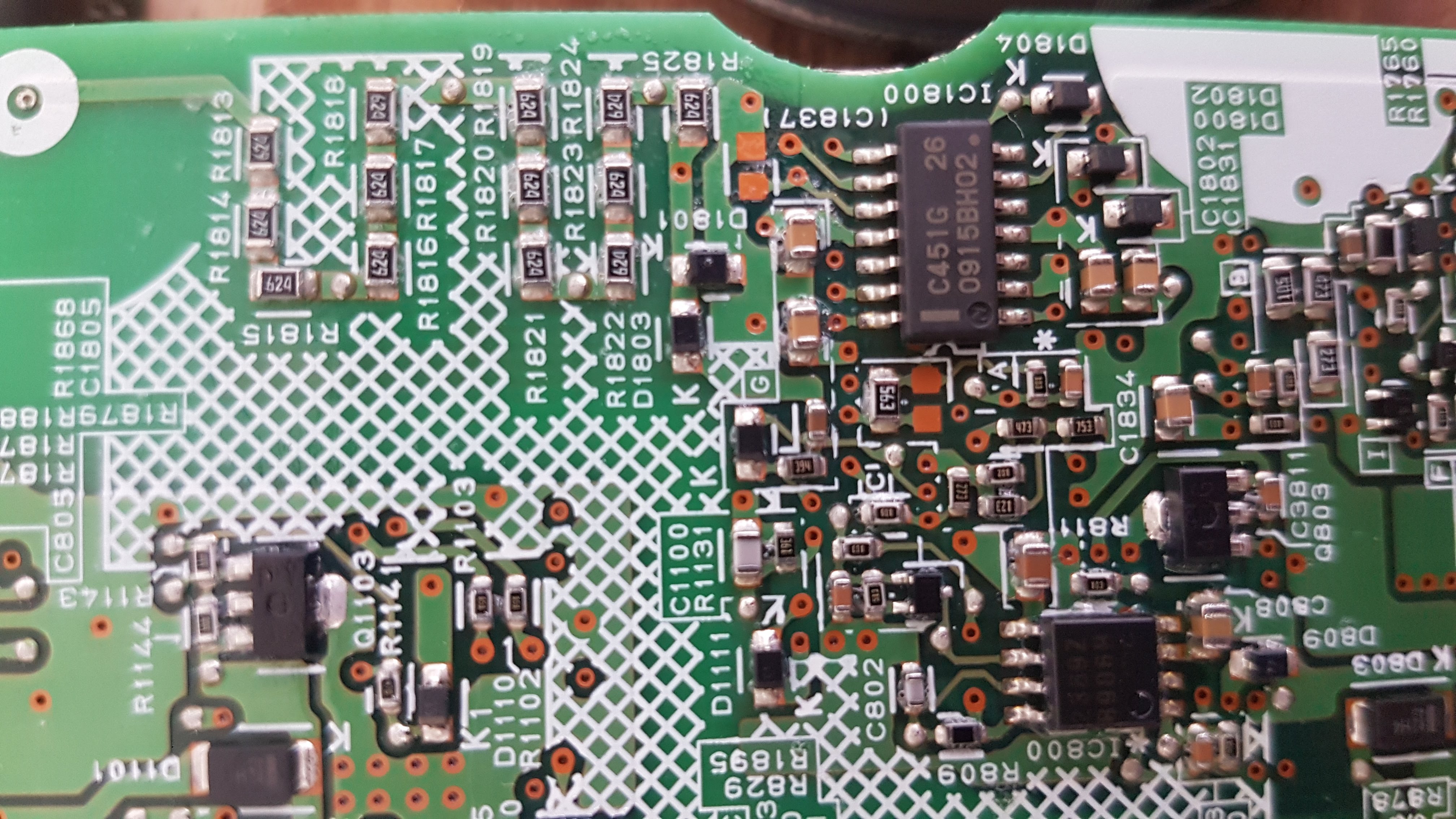

Realized that the components needed to be changed are all on the top side of the board so I removed the paralleling resistors and replaced the resistors I wanted to have new values.
The resistors in red circles are now 12kohm, was 15kohm, and the resistor in blue circle are now 6,2kohm, was 7,5kohm.
I also have removed R90 (10kohm) from the logic board. The 328p can handle 5V input to the ADC so no need to dampen the signal with a voltage division.
After a new voltage measurement calibration in the SW I now have a voltage measurement capable of measuring up to 450V.
