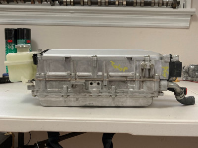

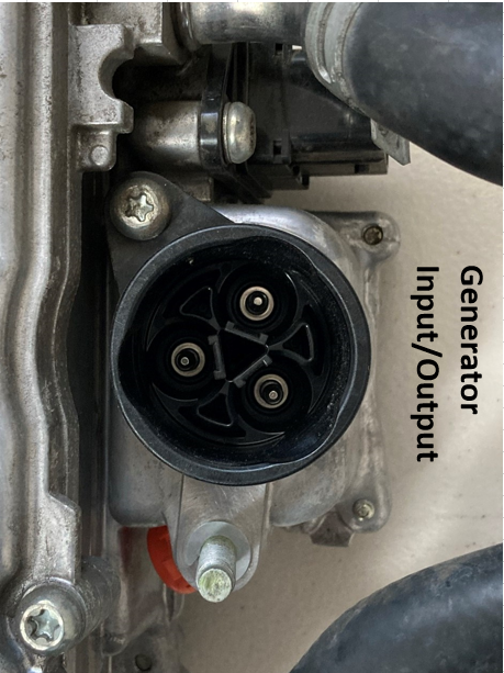

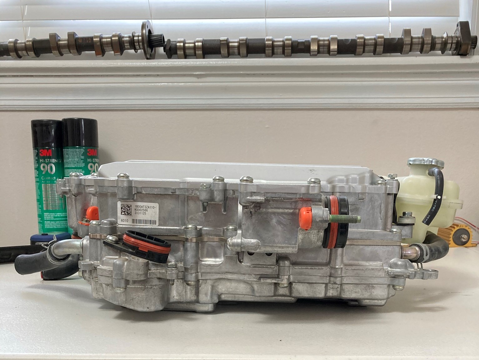

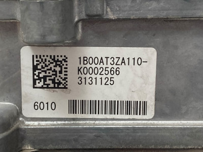

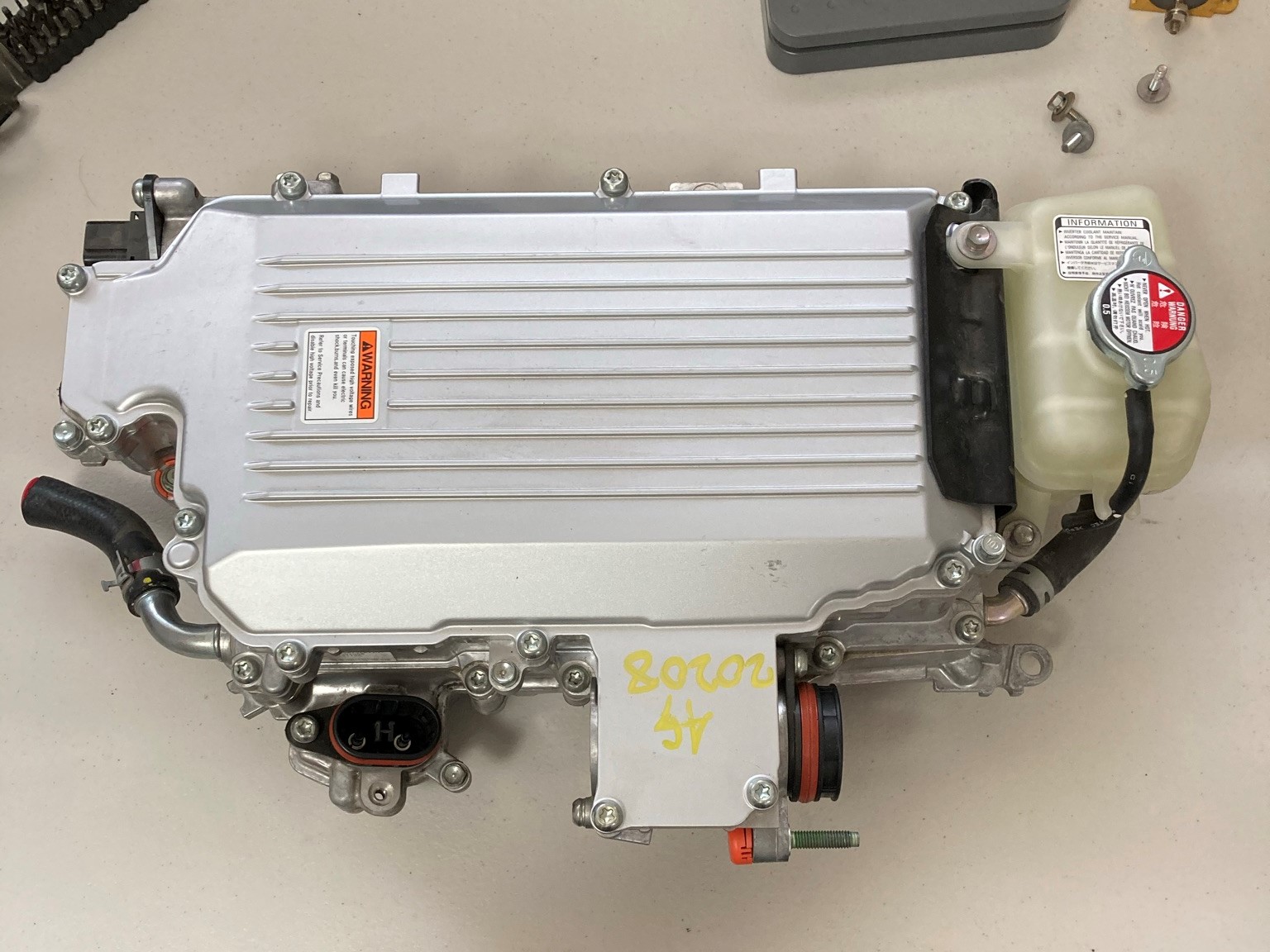

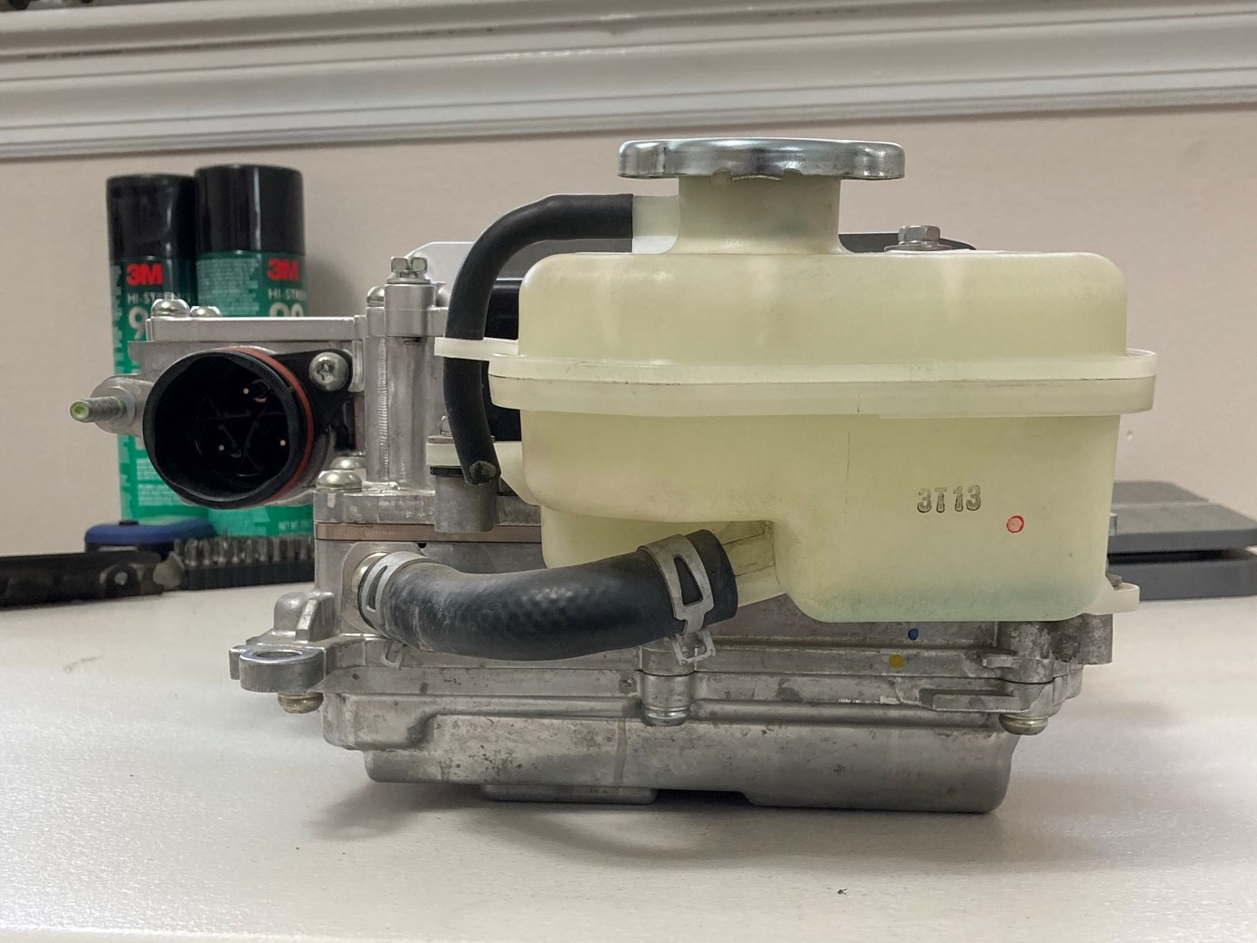

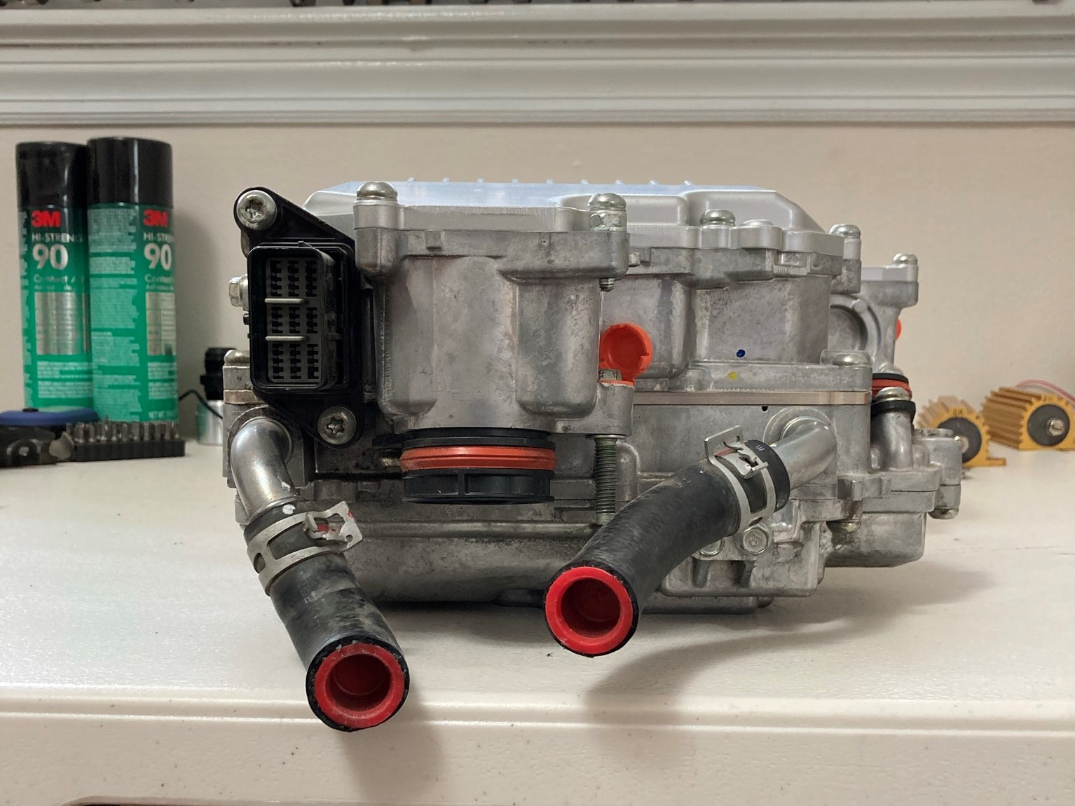

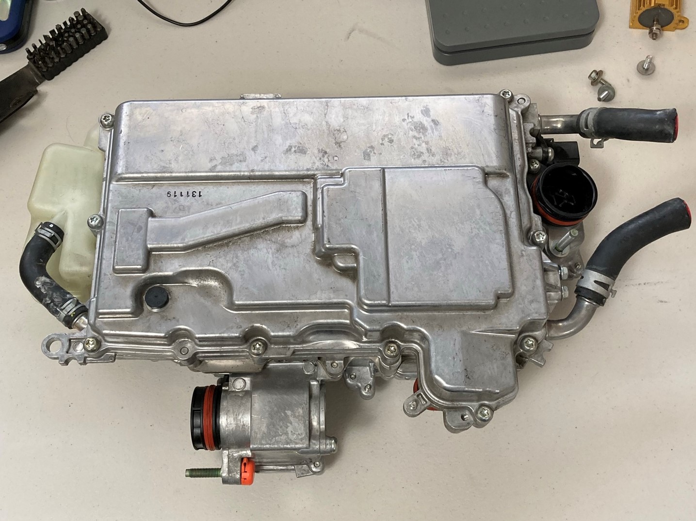

Here are some external pictures of the inverter. Ran out of attachment space. It's a nice shoebox design, 20x14x7 inches (508x356x178 mm).

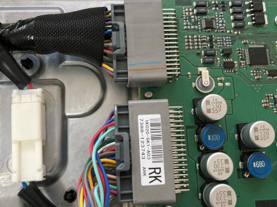

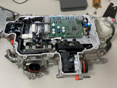

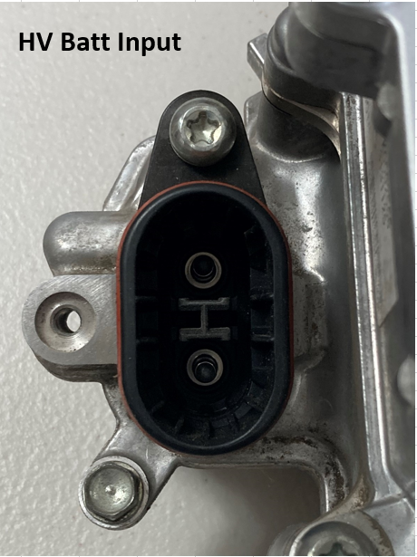

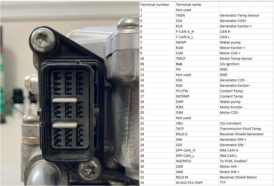

The Motor Control Module connector has a few inputs to the outside world which I have listed in the in the photo. The majority of them are resolver inputs, temperature sensors and water pump control. This shows me that the control of the inverter is done through the CAN inputs. I don't have the time for all that, so I'm going to crack this thing open and take a look inside.

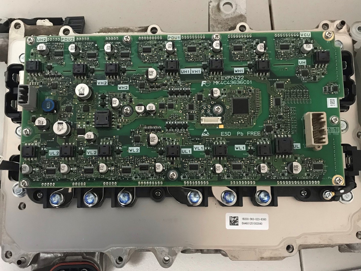

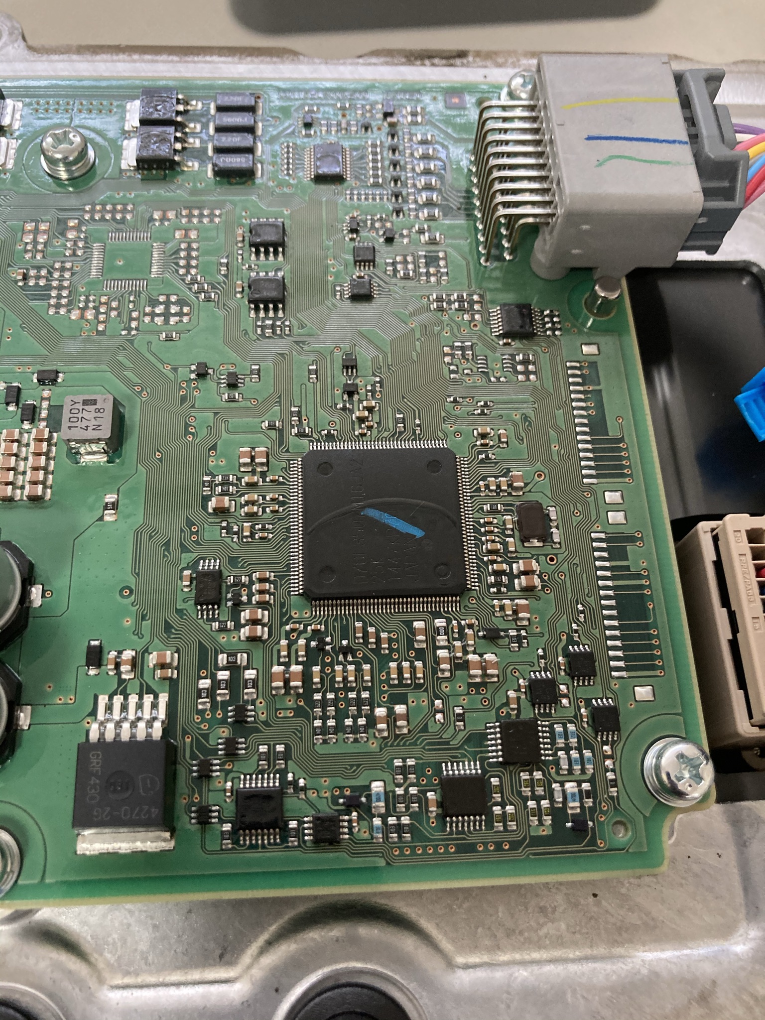

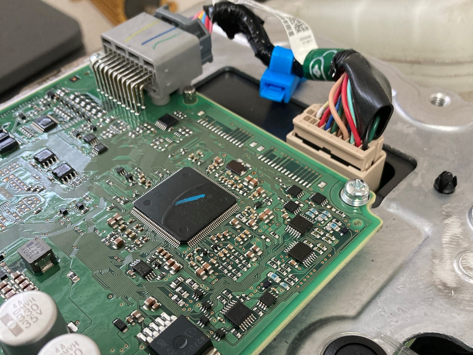

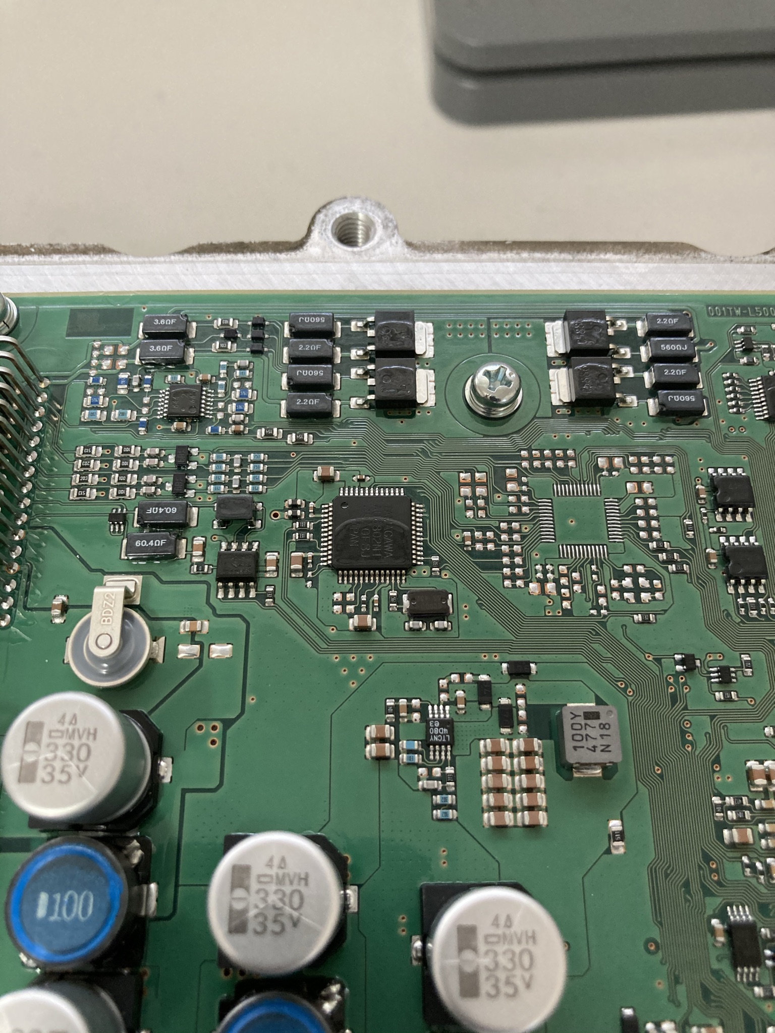

Here are some photos of the control board and the gate driver board. Interestingly, the Honda service manual states that two of the pins that are "not used" (pin 13 and 21 of the 33-pin connector) but they seem to be connected internally to the gate driver board from the cars 12v ignition and ground? Weird. Anyway, I'm working out the V850 pins now.

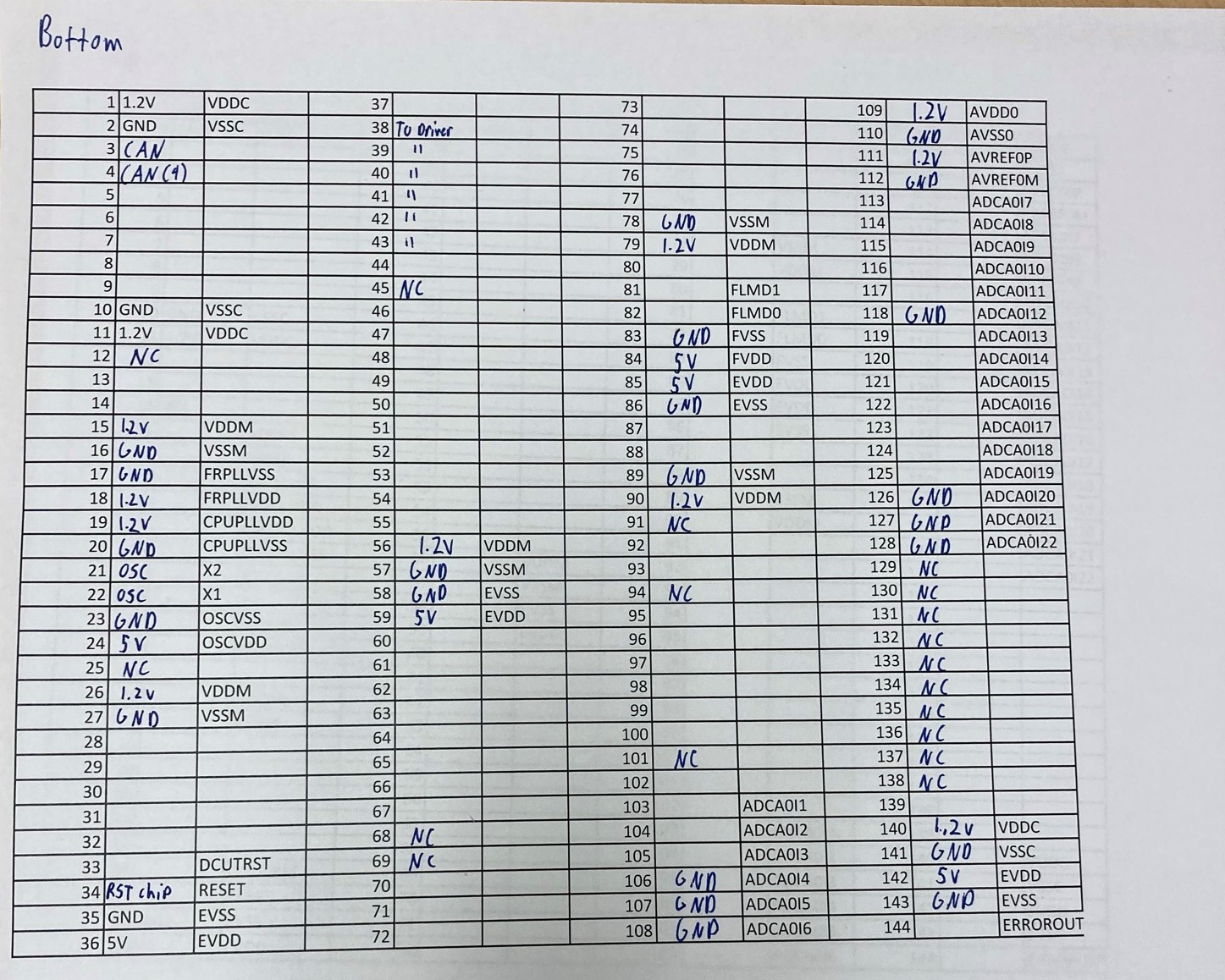

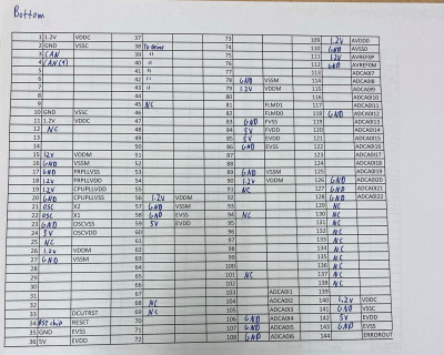

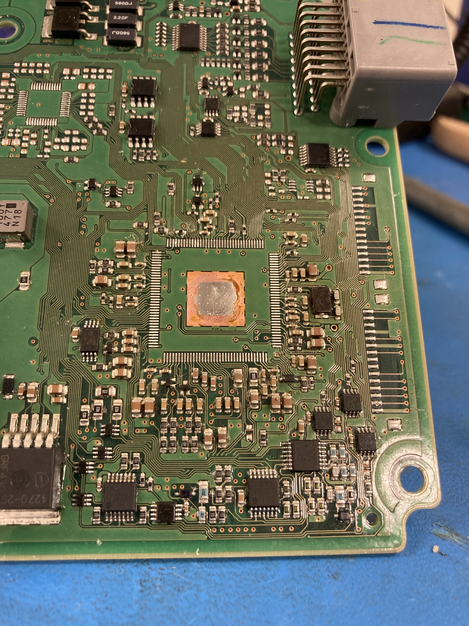

The micro was in the way, so I took it off. It gives me a clear view of the pads. Oh, did I every mention that the bottom of the board is a almost a mirror image of the top? The top and bottom micro are almost stacked on top of each other. I'll grab some more pics so you can see what I mean. The top controls the motor section and the bottom controls the generator section.
Removing the micro allowed me to easily figure out half of the pins. I have 72 remaining. The traces are annoying as most of the vias tie to the inner layers, and makes it slightly more difficult to follow.
I grabbed the datasheet for the V850 and traced the outputs that weren't configurable. Now I have to do the configurable ones. No telling where they go. The ADCs probably go the current sensors and temp sensors. I also know that the resolver-to-encoder spits out a 10 bit (12?) line.

The board is manufactured by Fuji Electric: https://chargedevs.com/features/pushing ... ectronics/
