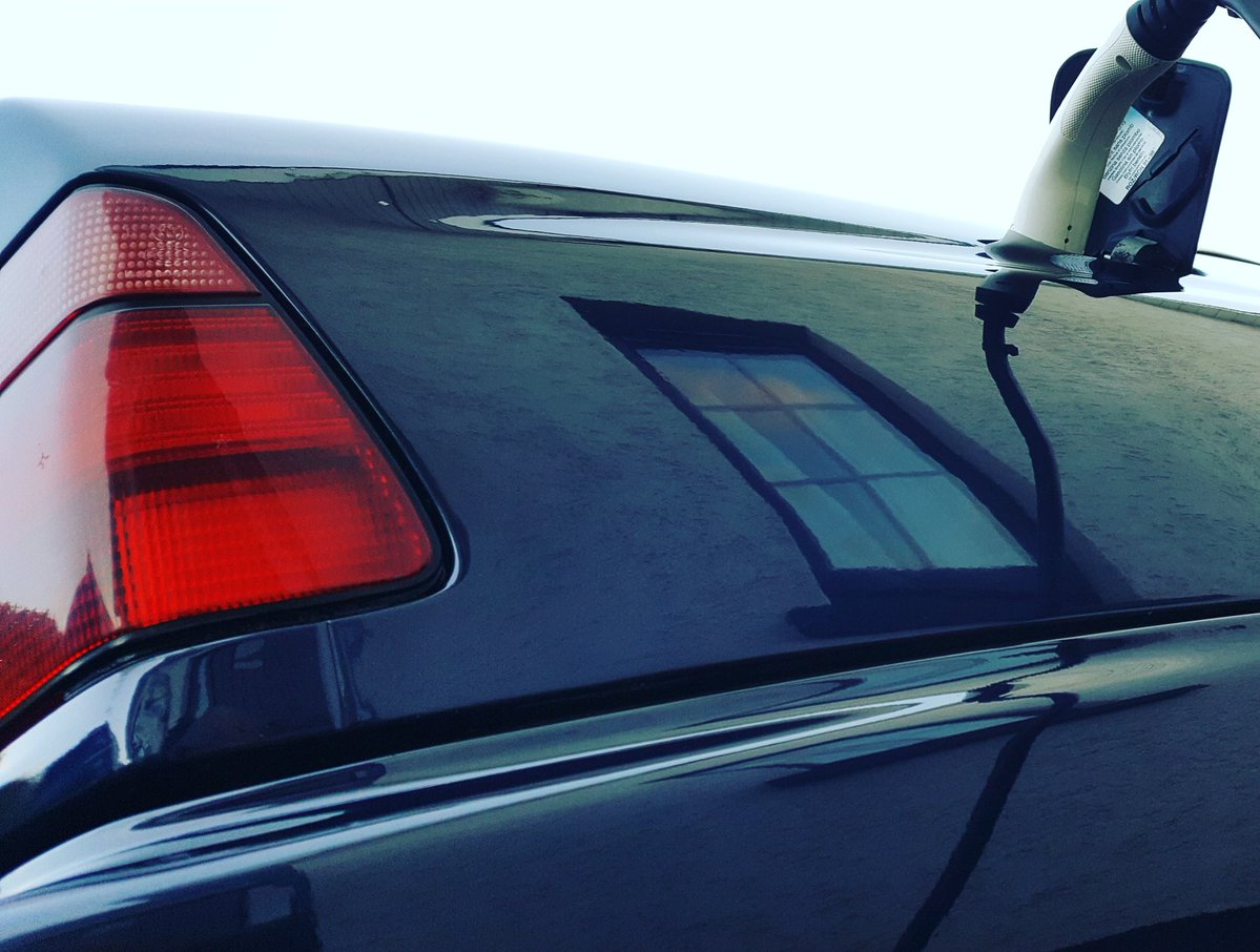

very shiny Panzer getting ready for a magazine photo shoot
