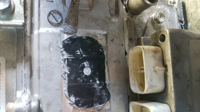

After having 6 or 7 inverters apart now this is a must for inverters that are more than 10 years old and i would do this for a inverter 6 or more years old as u can see in the second and third pics the paste has completely broken down

Now strip the lower half of the inverter off by
First removing 2x 10mm bolts on the coolant conection side holding the black plate on
Then pry the black plastic plug out ( dont damage this to much u need it)
Undo the 2x 10mm u see in the hole
Now undo the 4mm allen bolts holding the lower half on
And very cearfully pry the base off (note the 2x dowels i start at the end with the coolant connections at the dowel) remove base

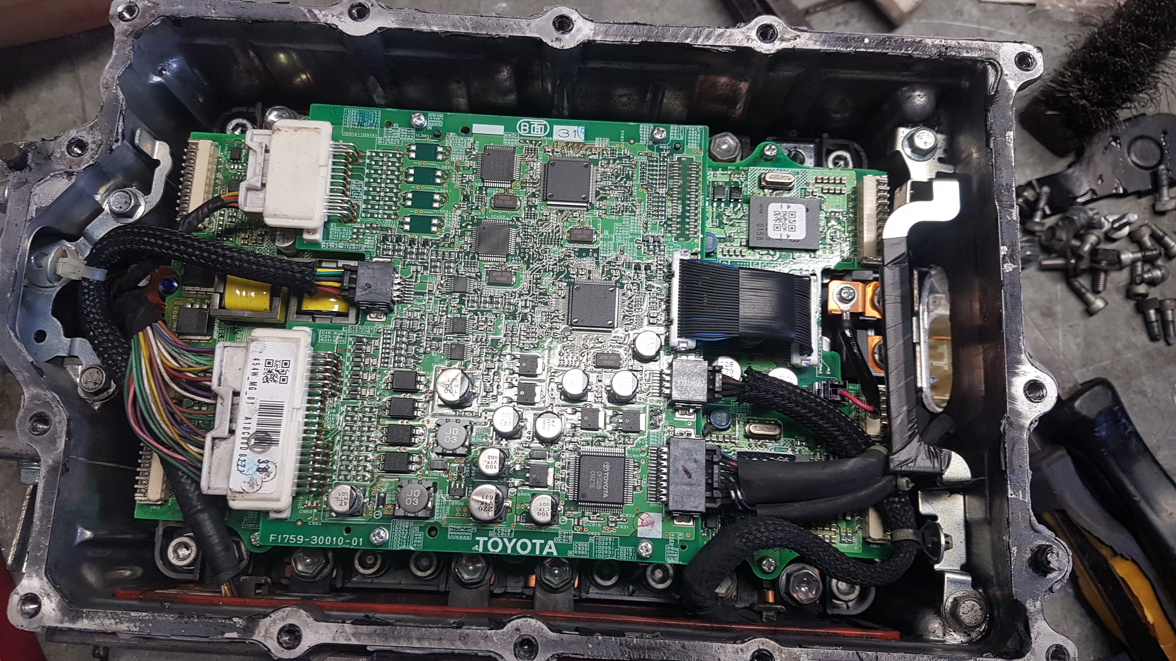

Remove the board in 4th pic with 4x screws and 6x plugs

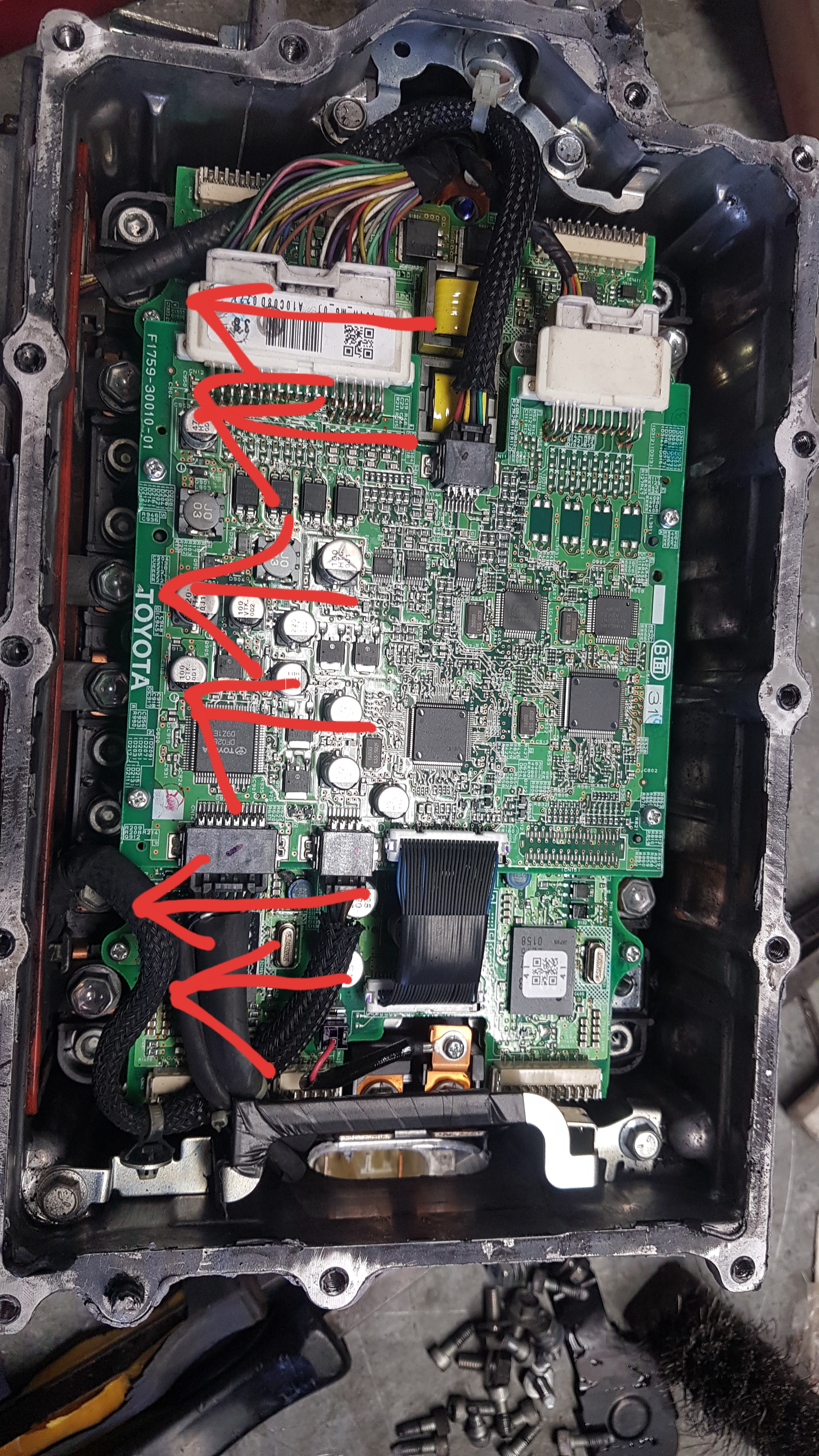

Now undo the 4x 10mm in the side that hold the two motor/gen cables
Now on the inside remove the 6x 10mm bolts (marked with red arrows in pic )holding the motor/gen bus bar connectors onto the IGBTs and pry the connector and housing off the side of the inverter
Now remove the 12x6mm allen screws holding the IGBTs to the inverter body
Now remove the IGTBs and soldered on board (this is the only bit u need to re paste in inverter)
Clean the inverter and the IGBTs and reaplay a very thin layer of thermal paste to the IGBTs only (note i found if i left the paste in hot water for awhile it was much easier to apply)
Reasamble the lower half of the inverter
