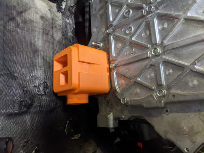

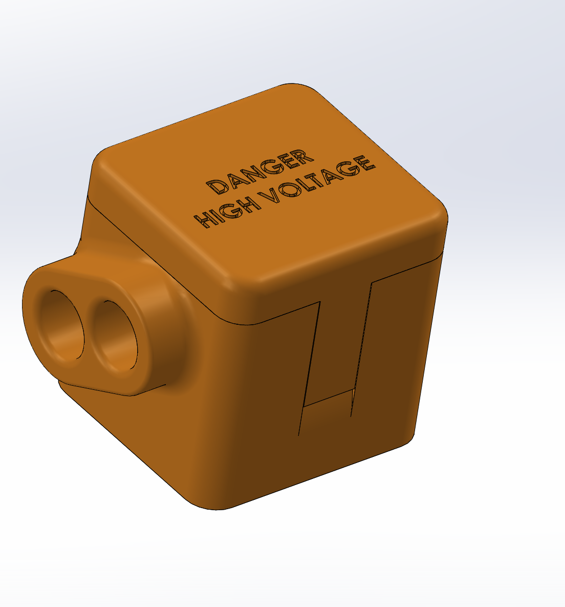

cad files for the em57 inverter dc connection cover iv been working on
updated design: https://github.com/bratindustries/leaf-inverter-cover
designed for use with
- m8 hardware to bolt to the inverter + phase connections.
-2/0 cable and crimps.
-14mm(?) cable glands
work in progress. recent updates and changes haven't been tested yet.
may have to change the cable layout.
-no seal yet for the removable cap
- potential clearance issue with bolting one of the dc connections
- no threads for cable glands currently

This is glorious, we will put one in our printer today!

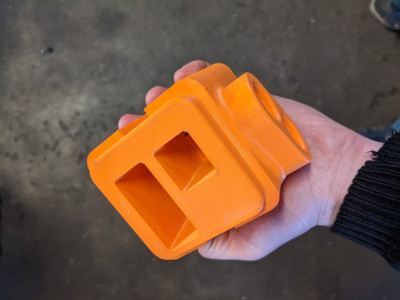

Very neat so far, the lid is printing now. Tight fit with the seal at the bottom is also good! Thank you very much for sharing.
Only thing we were thinking about this morning was, how are you going to tighten the nuts in there properly. We will struggle to get a spanner in there, might amend the design either in CAD or with a rasp!

Wow looks great in HV orange! yes that was my concern aswell. Was going to continue to add in features for nuts to lock into. Then bolts just screw in. The hardware for locking the the entire assembly to the Inverter is designed as such. As well as the larger opening for the dc connection.
maybe have to just change the entry point for the cables, and use the larger hole opening on both dc inputs.

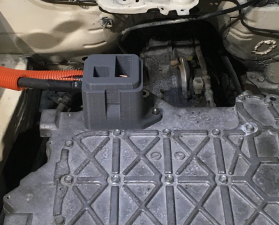

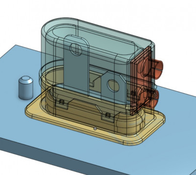

my EM57 inverter DC-in cover. I printed a test part and it's pretty thin and fragile. I've since decided to run these busbars directly into my High Voltage Junction Box and just design a seal to go between. For anyone interested in printing or modifying my design it can be found here: https://cad.onshape.com/documents/ff8b4 ... 81dd039fa4
If anything there's a decent reference of the EM57 you can use to design your own.
it's in 3 parts and designed to be printed without supports.

updated my inverter cover, cad files on github. uses m6 shcs and pressed in nylocks
