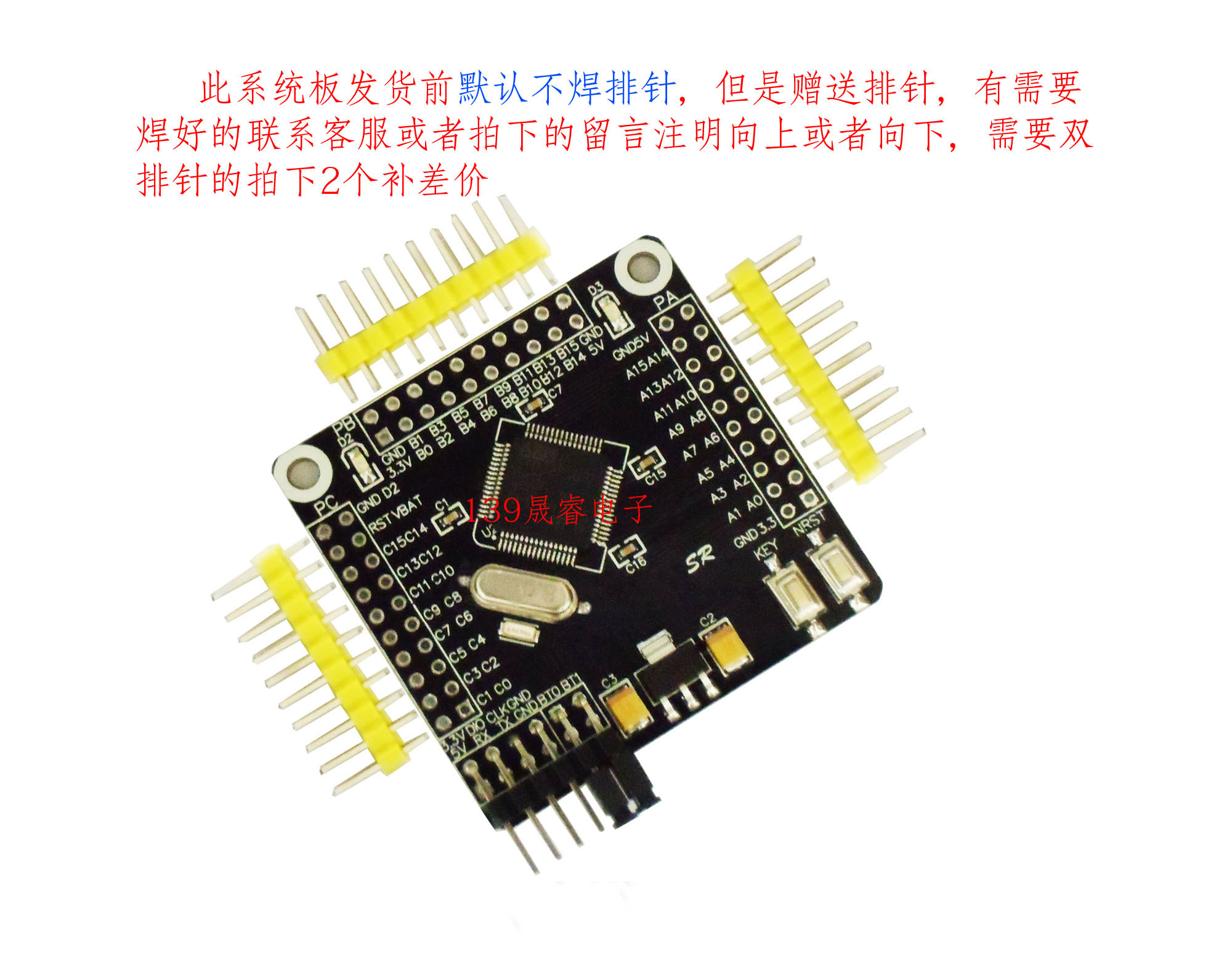

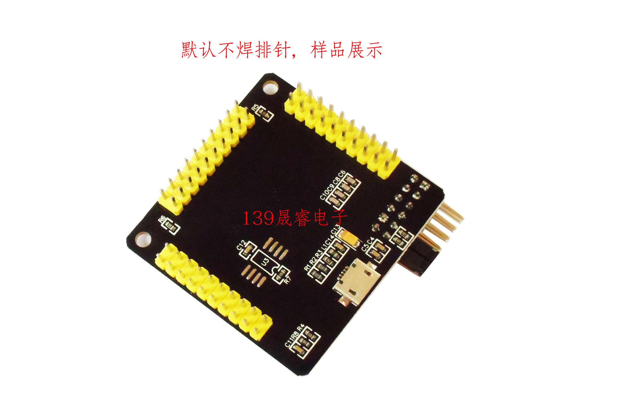

I bought a 2 submodule STM32F103RCT6, ARM; Flash: 256 KB; 72MGc; SRAM: 48KB. I think it will go

Yes that's probably the 256k variant. I will certainly replace the static addresses and page sizes with a dynamic one.

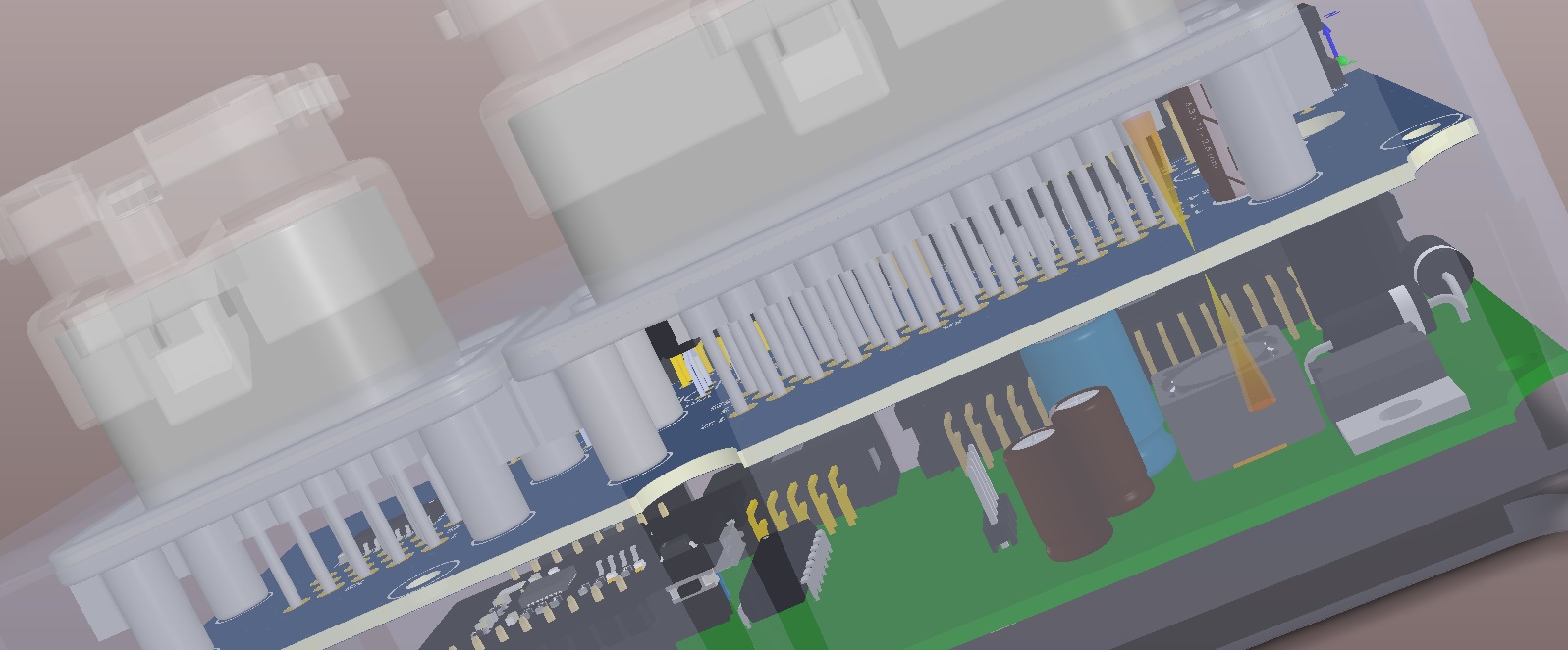

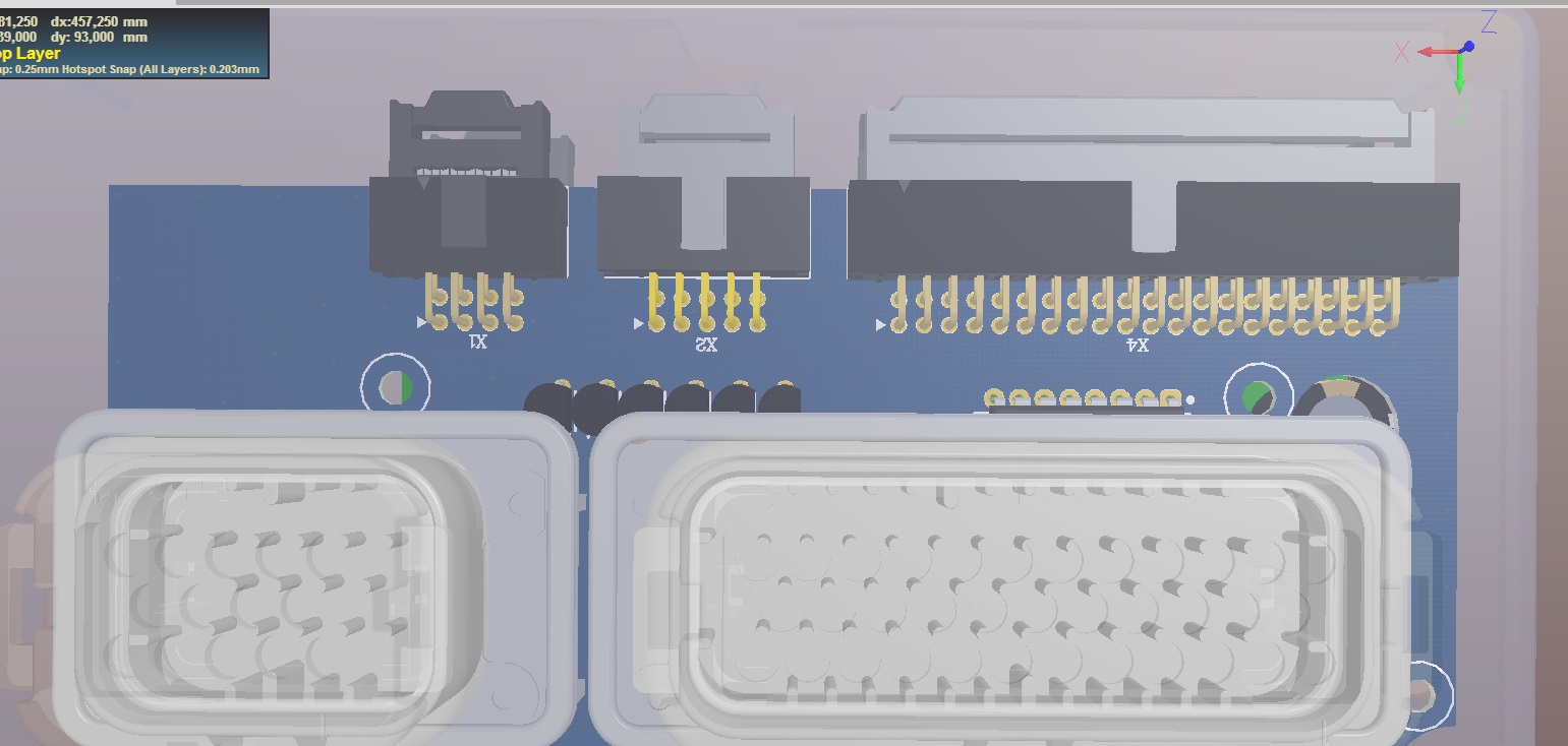

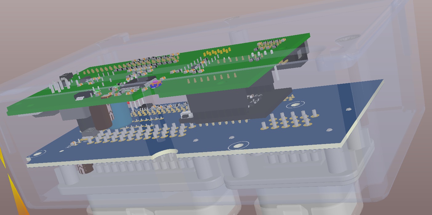

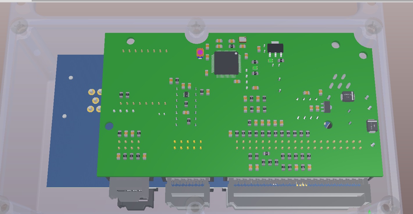

Greetings, as the law of meanness, just finished designing a new logic board, the processors for it ran out. will the CPU pinout change?

No, pin out will not change.
