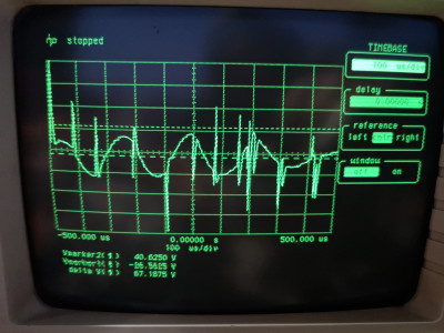

After testing the setup for a while without a cooling circuit, I decided to connect the Nissan Leaf OEM radiator and two of the recirculation pumps in order to cool off a bit the inverter and the motor.
Then I decided to test them for about an hour to see how the temperature gradient will gonna change.
I've started the test with the battery pack fully charged at about 74V and a capacity of about 53Ah. I wanted to measure the real capacity of the battery and in the same time I wanted to do some measurements and observe the temperature of different components of the setup.
In the video bellow we can observe the temperatures of the different components while the motor was running at 172A RMS, phase current.
After only half an hour I wanted to measure again the temperature of the main capacitor and I observed that this had a crack which was not there before starting the test.
Now the temp of the cap was well above 90 degrees Celsius.
After this I immediately stopped the Inverter and waited for the capacitor to cool down.

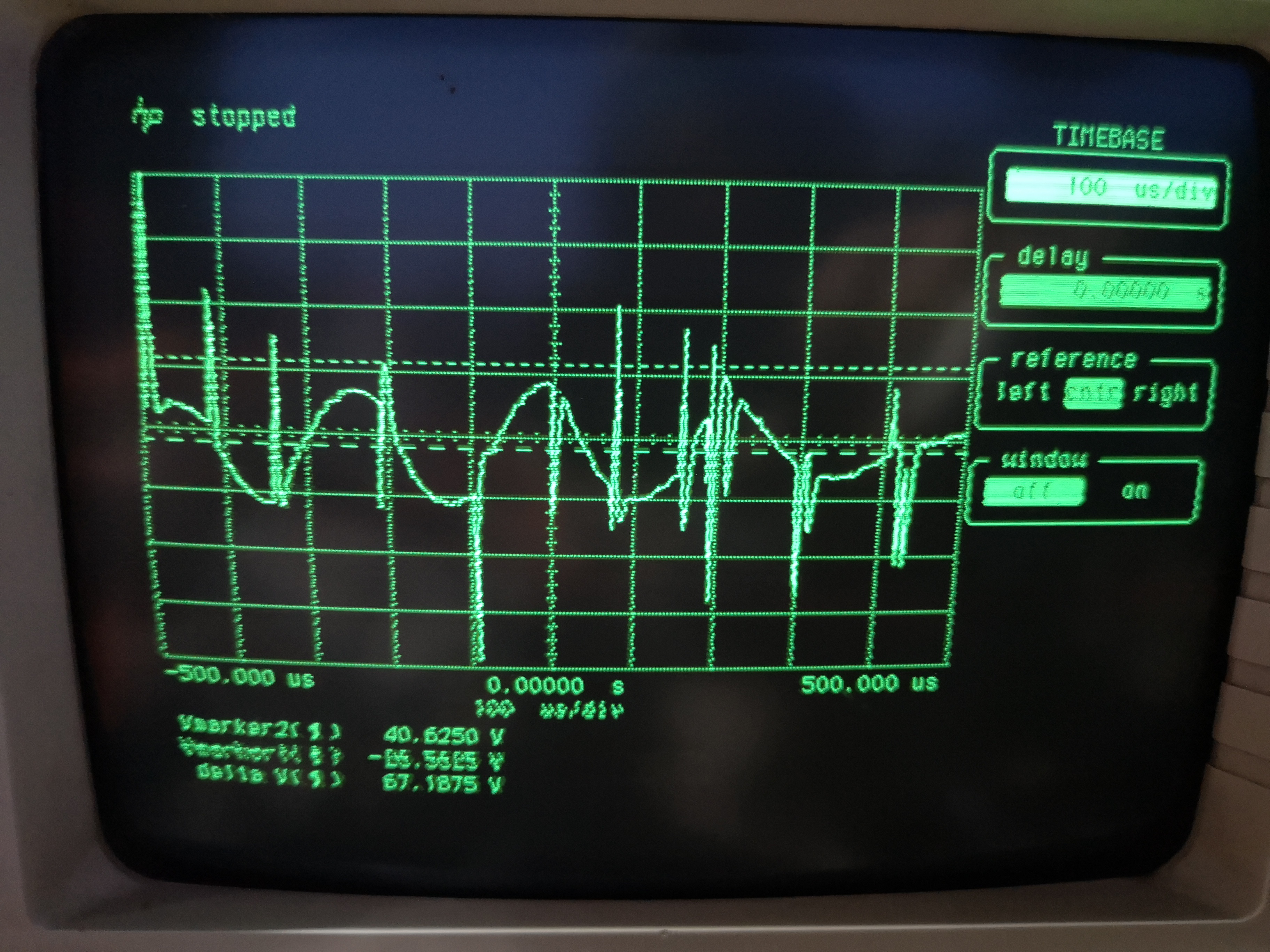

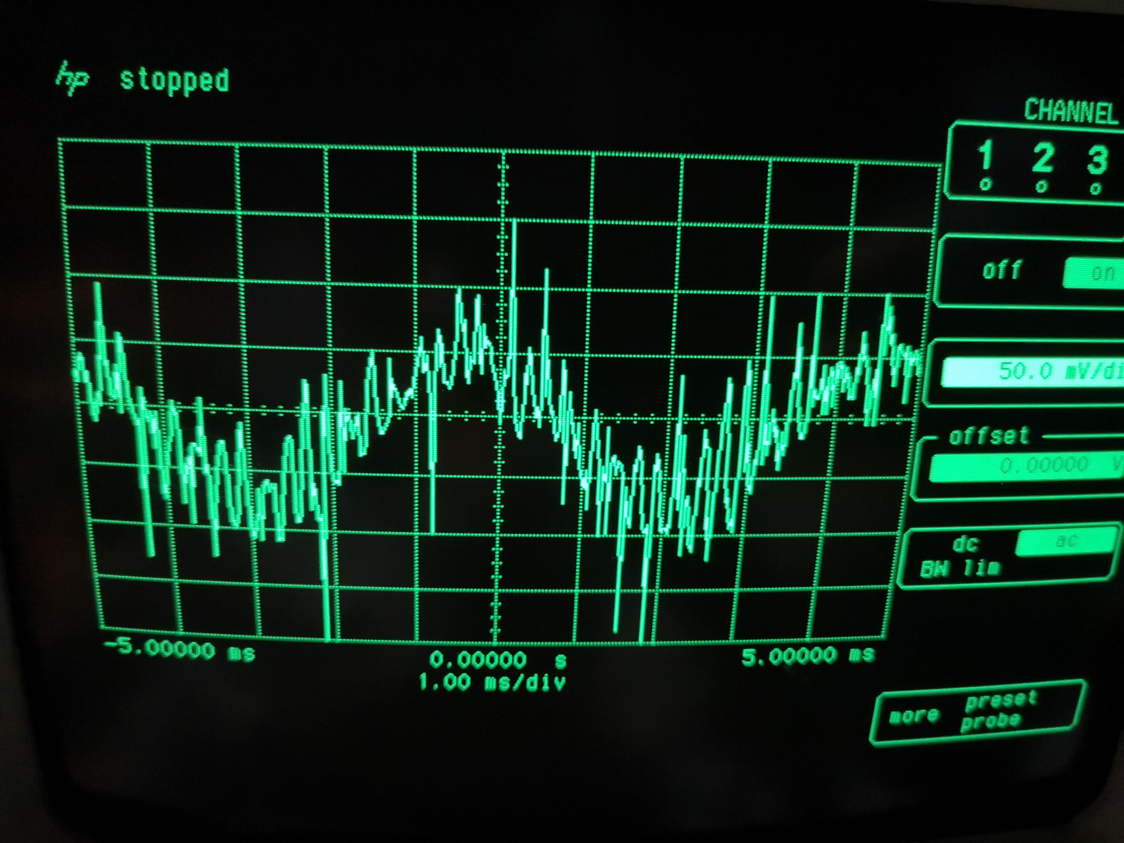

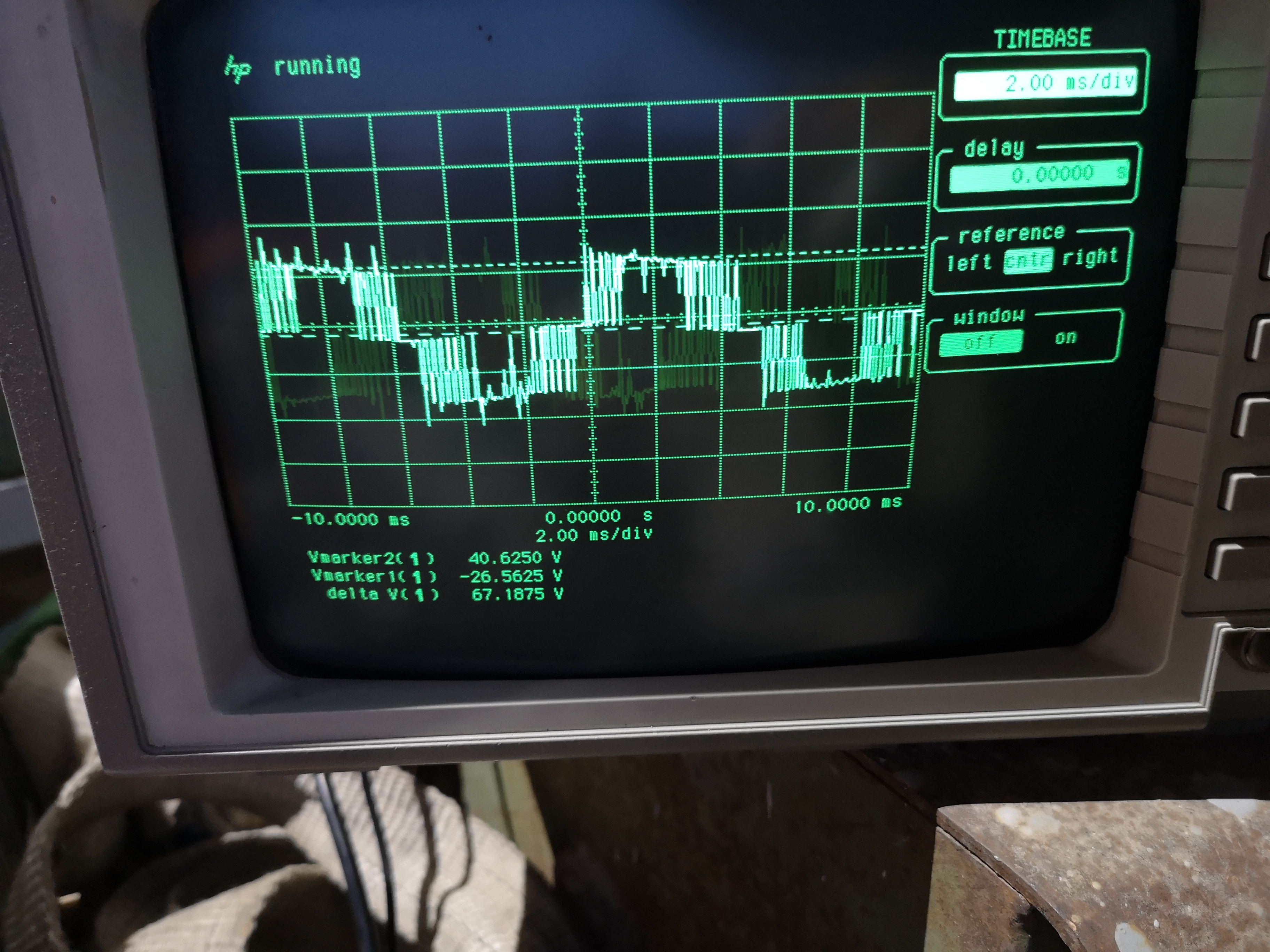

Meanwhile I managed to make some measurements of the DC current, motor phase current and motor line voltage with my oscilloscope.
The waveform of the DC current absorbed by the inverter
The waveform of the motor phase current which resembles a Sine wave (somehow)
The waveform of the motor line voltage
